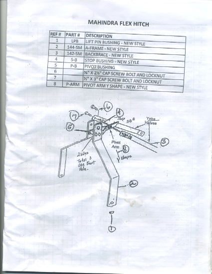

Here is an image I scanned with the only instructions for the assembly of the frame structure and I did assemble it incorrectly. That will explain the damage to the driveline plastic housing. However, that still doesn't change the basically bad design of the housing. I mow with it with slack in the lift so it can float and I can raise it over obstructions if necessary. The deck should not have buckled from the impact when I backed it into a small stump I did not see in the weeds. It did not damage the skirt which is heavy gauge steel. However, the deck did buckle. I straightened the best I could without totally disassembling the unit and welded reinforcement bars at the buckle area.

I certainly agree with you there. That is definitely a light duty design - or medium light duty;) ... probably less durable in the body than some of those that it was declared favorably against. -- Without the variability of real world use and reports of users we wouldnt know. ... A good candidate for the Design Defect thread. Altho overpowered by your substantial tractor that bracket weldment area is deceptively fragile. A short incorporated triangulating gusset would bring that critical area up to par. How much would that cost in production? - a very few $.

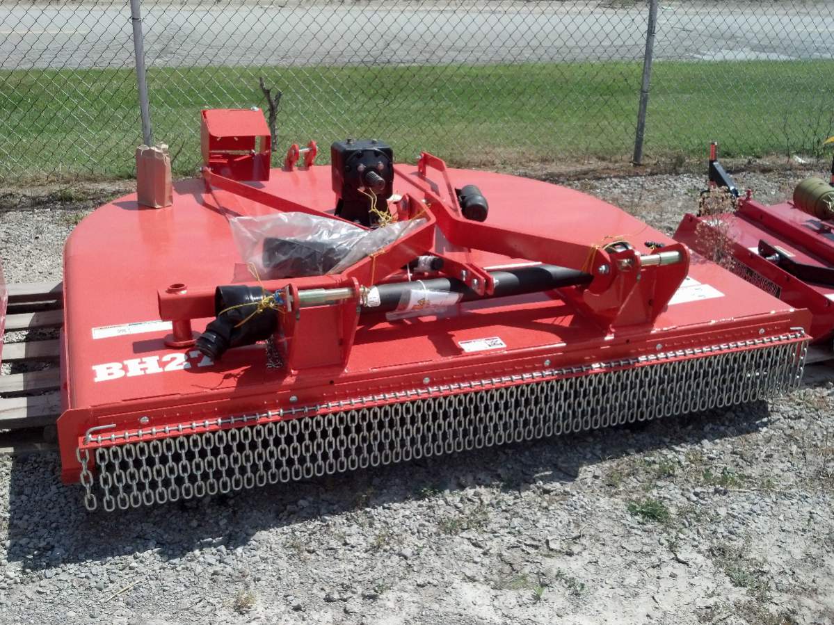

All the good medium duties I've looked at have clevis style attachments
Woods, Bush Hog, Brown, Landpride
Agreed that is a beefy looking lower hitch point. I'd love to see that front seam welded fully, and I'm one of those one types of people that holds the opinion/preference of a smooth bottom with the framework up top just because for my uses I'd prefer the framework to have the protection of the deck, the ease of cleanout of wet grasses without the framework under the deck, and the fact I have no concerns of the framework on top of collecting puddles from weather because they're stored indoors.

I removed and repositioned the lift in the correct position and it really improved the functionality of the the cutter! Thanks for pointing that out to me. I recall now that I called Kodiak when I was assembling it and asked about it as I was experiencing difficulty making everything work with the lift in the first bolt position per the instructions, finally I worked it out. However, it was still incorrect and I had real issues with uneven terrain and scalping even mowing very high. After correctly installing it, it mows like a different machine! I had never seen one work like this one does as all my experience had been with American designs that used the old stop systems that rested against the mount bracket and worked fine. I suppose this design is a little less expensive to build by using less steel. I plan to mow some additional ground with it in the next few days that I mow once a year to control undesirable growth and to keep down trash trees. I didn't have enough time yesterday, but it seemed a decent cutter yesterday for the first time. I was attempting to save a few dollars as the premium heavy duty brands were considerably more expensive than the Kodiak. This is a heavy mower at 815 lbs.
