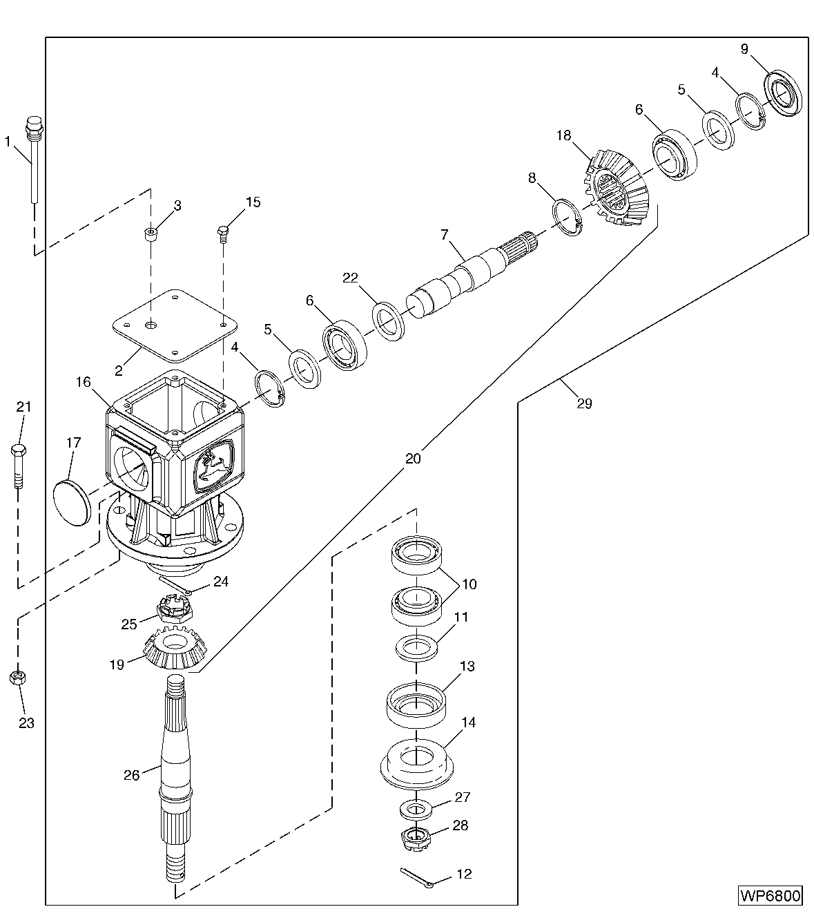

Well I decided to drop by my dealer this afternoon to inquire a bit more about the fix. Turns out my MX5 is an earlier version and the only option at this point is to change entire gearbox and the turntable. The upside is my blades are still good ......yipee. I'm having my dealer do the work as this is a first time for them and could not give me good guidance on the changeover. Ironically another customer called my dealer about his broken MX5. Must be the heat.
So you are paying them $1000 for a gear box, plus the "turntable" (stump jumper?) and then maybe you'll need blades to fit this new setup? Plus labor on something they've never done before? I hope they were greatly exagerating their estimates.

Quick update after 1 week. Called Deere dealer today and they said the gearbox was on back order and that the production facility does not have run completion date. Don't you just love outsourcing. Can one use another gearbox, drill new attachment holes and make sure the PTO driveline matches to that new gearbox?

Here's a link to a 75 HP gearbox that Agrisupply offers. Measure your input and output shaft sizes and configuration and mounting hole pattern and compare. Comaparison to JD MX5 parts dwg (I don't know if yours looks exactly like the one pictured) shows a splined input and output shaft but doesn't say size or number of splines.

At 1/3 or less than the cost of repair from JD I'd be inclined to buy a replacement gear box even if I had to fab up some kind of adaptor plate to mount it to the mower deck. But that's just me :D
