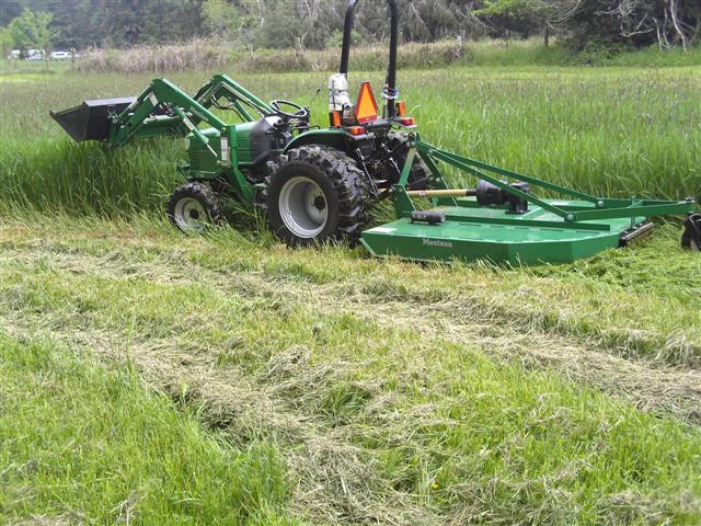

   / Rotary Cutter Sizing #4
I know I'm repeating this from last year, but I run a 7260SC (6ft.) Montana rotary with my Montana 2740 with no issues as long as I leave the FEL on. I've found that as ground speed increases, the quality of the cut decreases, so I mow in 4th gear anyway. With R4s, tractor width is about 64 inches, so a 6 footer covers the tracks nicely.....Dan
