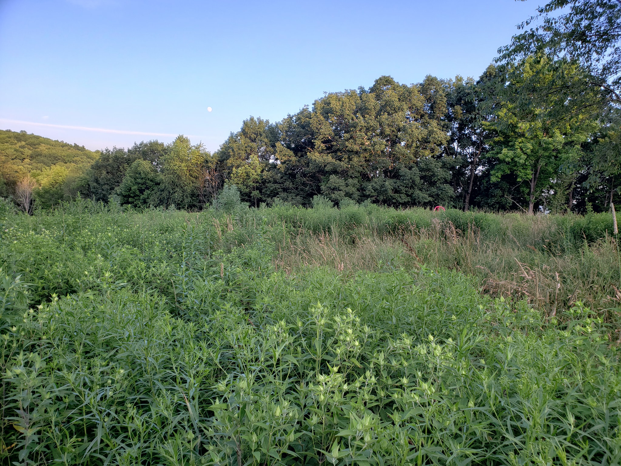

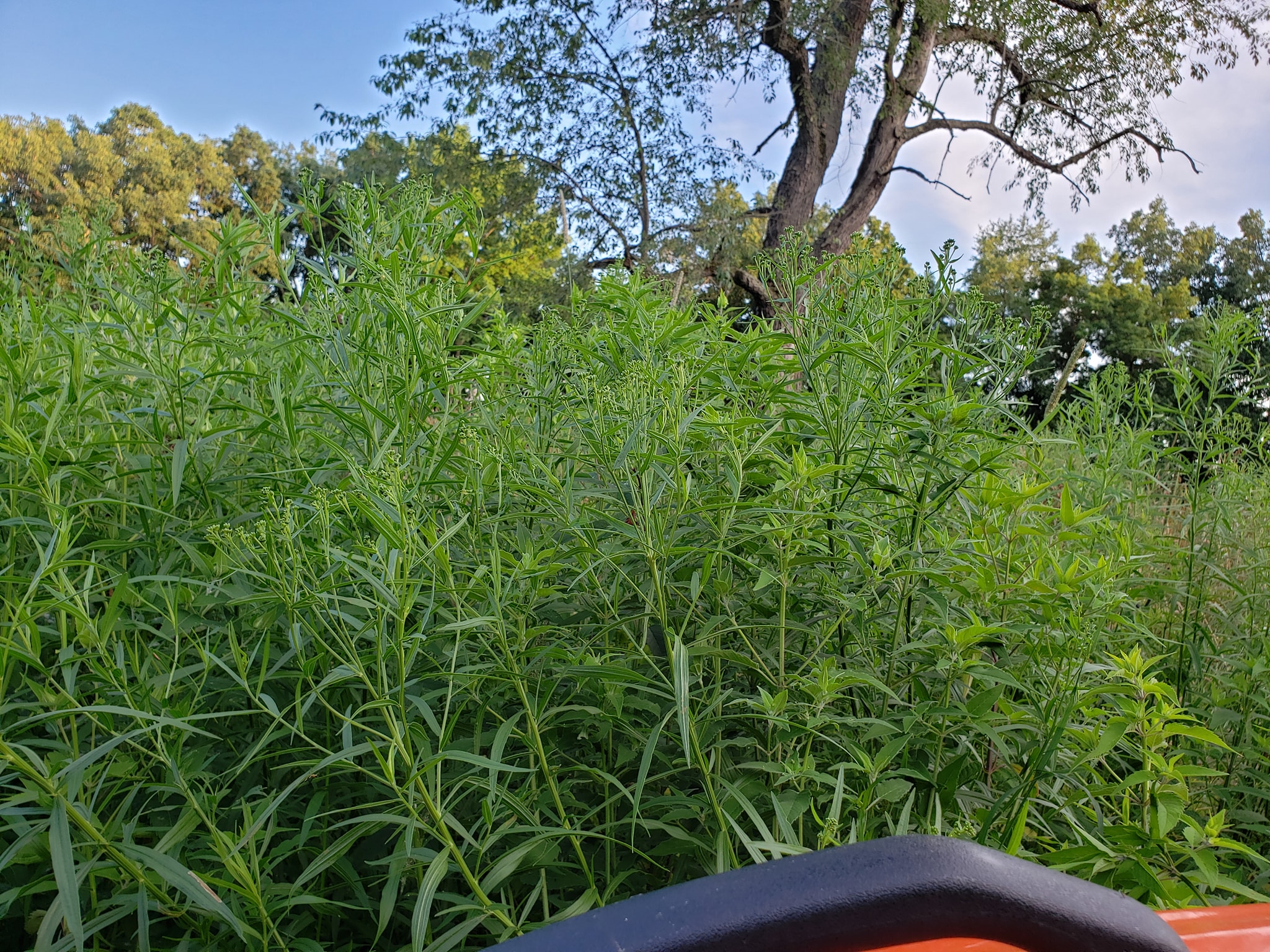

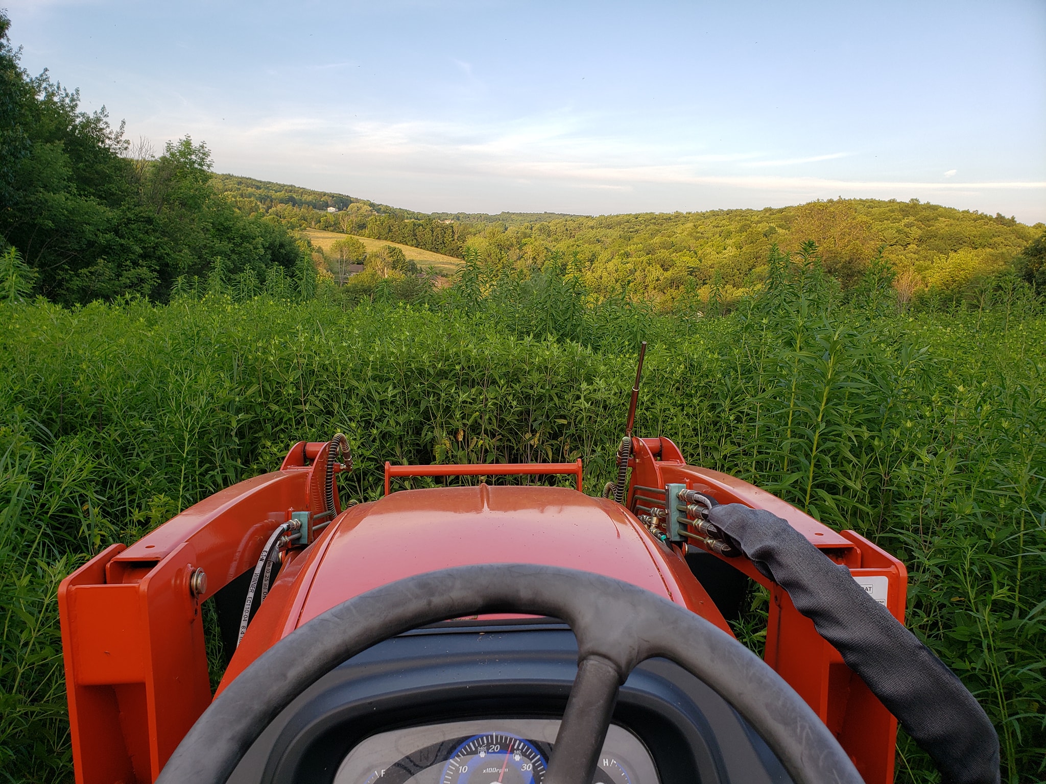

You can see in the pics how tall the grass/weeds were. That red chair was marking the first in a line of 5' Ash fence posts.
One thing I was impressed with is the power this machine produces. I have been using a friends new Kubota L3650 with a 60" landpride cutter on much shorter grass/weeds and it often bogs down. Not this thing!
