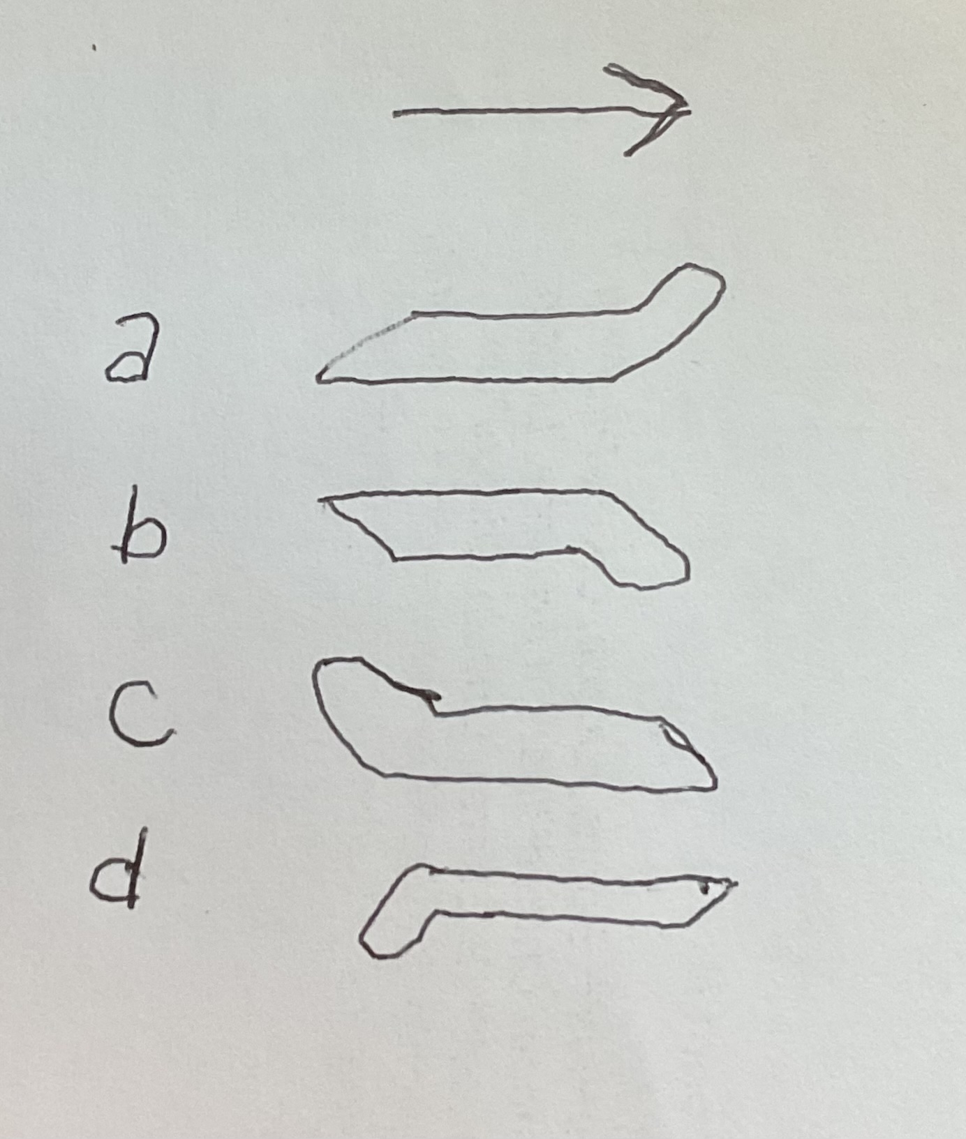

If the blades are like mine then one would have a 25% chance of randomly installing the blades correctly.
1. Observe the direction of rotation while running.
2. Orient the blades so that the cutting edge is the lead edge.
3. Make sure the trailing edge of the blade is angled up so the blades act like a fan and lift the grass as the brush hog turns.
4. Go mow some grass and enjoy the day.
Example: If the mower deck turned in the direction of the arrow,
then “c” would be the correct orientation.
