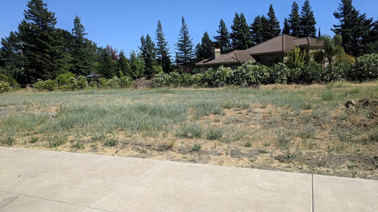

Hi all. I bought a rotary cutter for my subcompact to keep the weeds down until I can landscape on my two acre lot. I'd like to get as close to the house as much as possible. I plan to put 4 by 8s in front of windows and patio doors (I have a lot of windows) when cutting by house and then check the area for rocks and objects ahead of cutting.
My question. Do rotary cutters fling in all directions? I've read that the rear should be set higher to allow for material to escape so I was going to avoid driving directly away from the house and do most of the cutting runs in parallel.
My thoughts:
1. Check the area for objects that may fling.
2. Set the cutter high (no need to cut flush to the ground).

Rotary cutters can fling objects in all direction. Generally speaking, the side rails reduce side discharges and you should have deflectors (usually chain like devices) at the front and the rear discharge areas to minimize objects being thrown fore and aft. I agree with your items 1 & 2 but nothing is fool proof. If the picture is what you plan to mow than I doubt you'll need protection at the house with all that shrubbery between the grass and the house.
Ah, that's my neighbor's house! I'll have to hope those oleanders prevent anything flying over there.

There are a couple of stones at the left of the photo. A bush hog will either throw them whole or shatter them and spit pieces at high velocity. Walk the ground and look for stuff BEFORE running the cutter over it.:thumbdown: Barbed wire is especially nasty to unwind from a cutter. I know from experience. :2cents:
