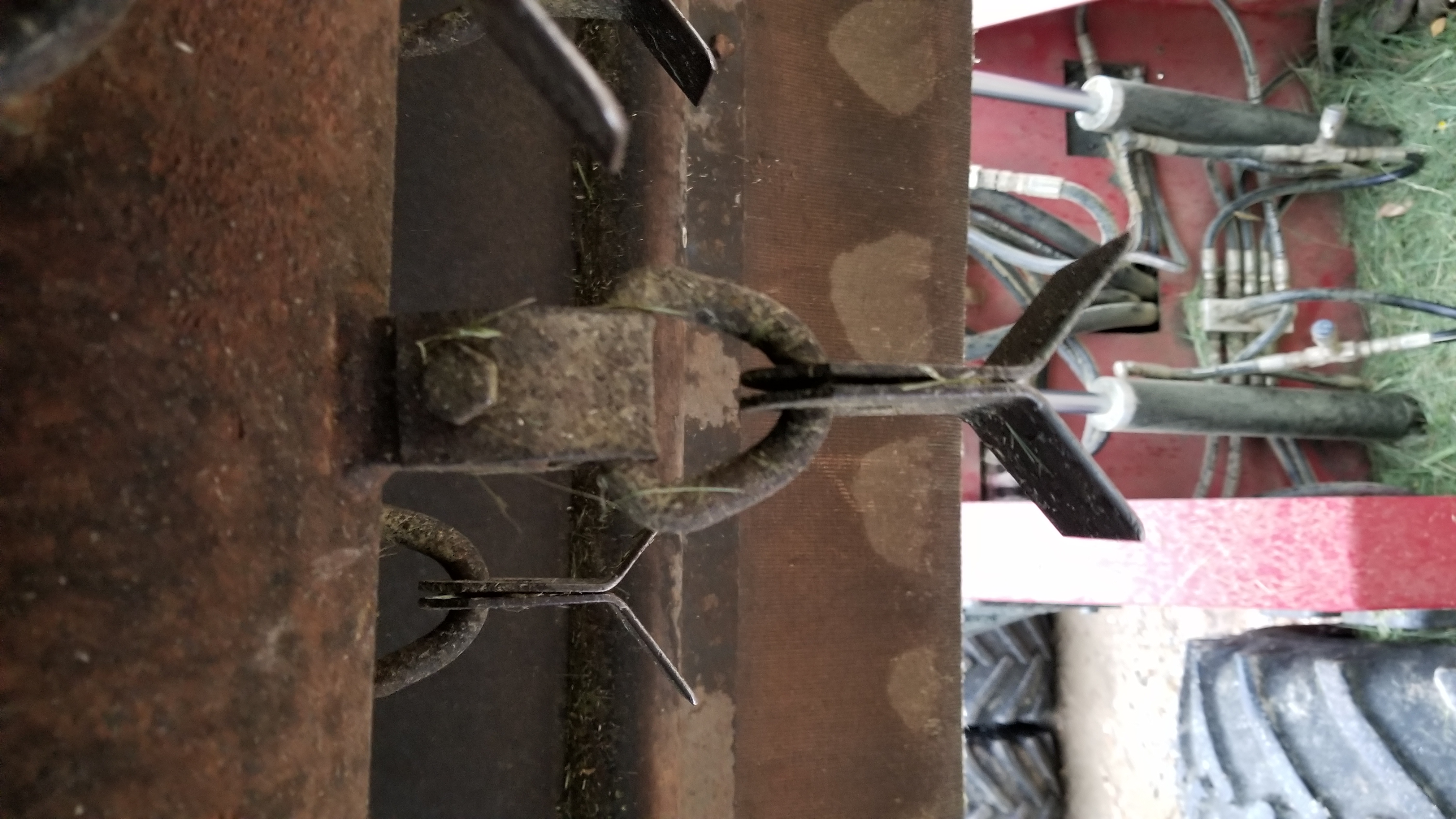

I look at the construction of a flail cutter and wonder just how badly those blades will fare against a 4 stone? For rough work, I still think a rotary cutter is best.
I've hit everything from 1"-8" rocks with our flair mower and the blades just bound off of it since they weight almost nothing. Just sounds like running over something with a dremel tool :laughing:.

Flail mower and rocks kind of depends on the type of fastener used on the rotor. The shackle type of fasteners allow the blades to fold back a lot better than the fasteners that have the blades bolt directly: the bolted-on blades cannot fold back as far.
The duck foot/hammer/forestry cutter style, would probably take a beating, but still be contained and safe. The knife style has such a low mass, they just bounce off.
   / Rotary Cutters Fling Hazard #27
Those are attached with shackles, which, from my limited understanding, are going to give way a lot better than those that bolt directly to the rotor. But, it doesn't take a lot to dull a more fine-edged blade, one that's spinning at a fairly high rate of speed: kind of like a chain saw chain (though not quite that extreme). Regardless, I have no doubts that a flail offers greater safety: whether it would be essential in the OP's case is hard to say (it all comes down to risk mitigation).
