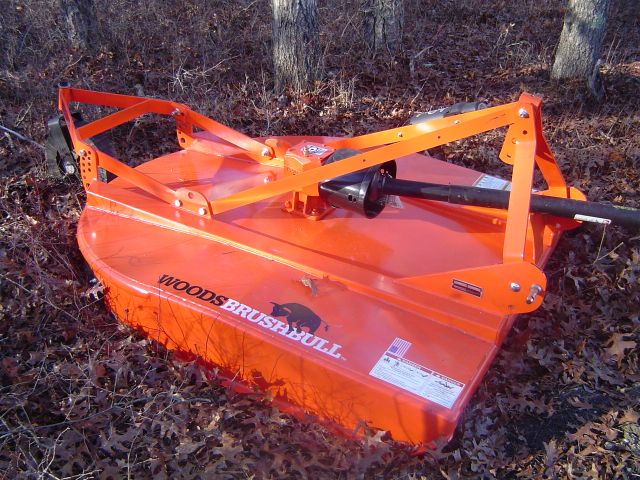

You may be able to get the Woods brushbull color-matched if you ask.
