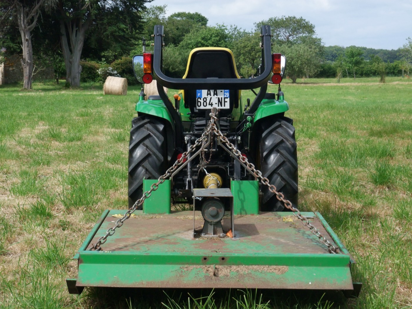

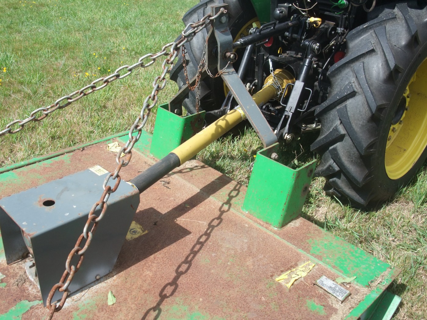

   / Rotary cutting #15
Some cutters can be easily offset to cover one side of the tracks completely. Such is the case with mine which can be hitched either in a centered position or offset to the right (very convenient along walls or hedges).

Only to slightly hijack -
Any links or pointers to how best to set up a rotary cutter on the three point? My cousin just loaned me his 30hp Satoh again, this time with a JD cutter attached. He was running it with the cutter at an angle (left side lower than right) and at full lift it only clears the pavement by a few inches. I'm wondering if I should adjust the top and side links.
Depends on the cutter. But all of them should be level left to right. and when mowing, the tail should be an inch or two higher than the front.
When you say fully raised it is only clearing by a few inches.....is it a ridgid mount cutter, or does it have a swinging shackle for the TL, or does it use chains like soulasphil's pictures??? And is it the front or rear that is barly clearing?? If it is the rear that barley clears, and it uses chains or the swinging TL, then the TL needs shortened. Because you are using up most of your raise travel just taking the slack out of them.
