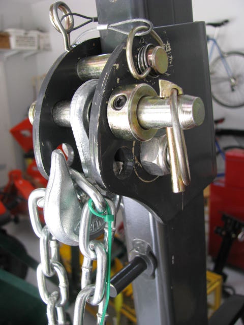

Photo #1 is an overall view. Limit chains are attached to the front of mower 7/8" lift pins via 1-1/2" steel rings, to 5/16" Quick Links to 48" lengths of 3/16" (Grade 30) chain running up to 5/16" grab hooks attached via 5/8" pins through the fold bracket for the ROPS. Got it? Note Bungee cords to pull chains away from PTO shaft in remote chance chains should jar out of the grab hooks when cutter raised and chains are slack.

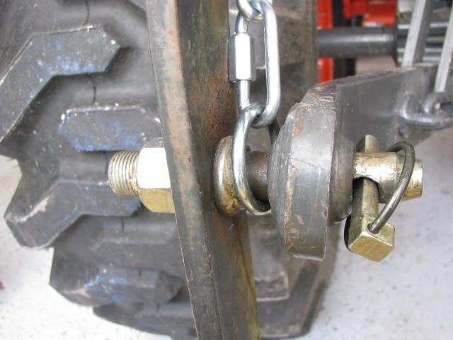

See Photo #2: The weak point is the Tractor Supply Co. 1-1/2" steel ring; just a 200 pound working load. Tomorrow I will order heavier gauge 5/16" X 1-1/2" stainless steel rings with working load of 750 pounds from Bosun Supplies in Maryland. There is not much "pull" on the chains. They are LIMIT chains not LIFTING chains. The 3-Point lift arms bear most of the weight. Heaving on the attached individual chains I guesstimate the cutter weight on each chain at about 50 pounds, in static condition, WITH MY EQUIPMENT.

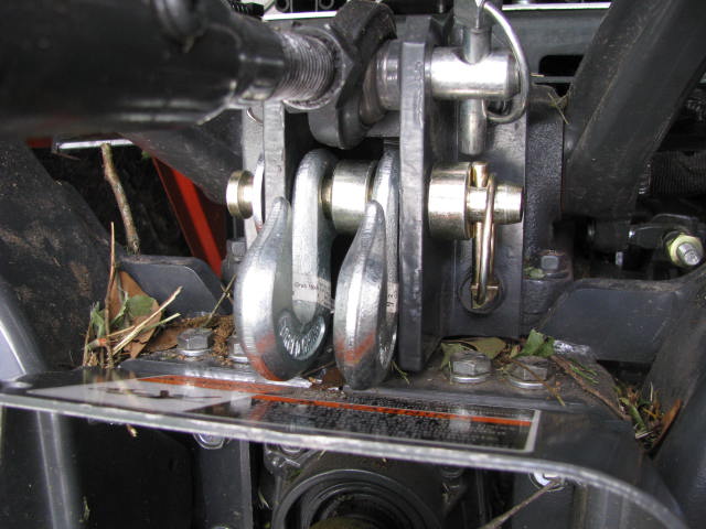

See Photo #3: Several reply posts to my earlier thread warned against using the ROPS for securing the limit chains at the top. But the ROPS on my Kubota B3300 is massive and attaches directly to the tractor frame and it is only supporting additional chain pull of about 50 pounds on each side. I realize the stress may double or triple when mowing but that is still no big deal relative to the massive ROPS, in my opinion. (The chains are actually supported by the ROPS fold bracket, which is bolted through the ROPS.) If I become concerned I will replace 3/16" Grade 30 chain with 1/4" Grade 70 chain. Unhappily the grab hooks and pins have to be removed to raise or lower the ROPS.
In Photo #3 you will see a 5/8" locking collar securing the pin. A little Bee's wax on a CLEAN Allen Screw inhibits Allen set screw from backing out. The collar tightens the installation up and is a backup to the lynch pin.
The green cable tie marks the link which gives me ground clearance of 2-1/2" at front end on both sides and 3-1/2" ground clearance at the discharge (rear) end, on both sides. Nirvanna for short. Coarse adjustment is available by moving chain in the grab hooks. If I need fine adjustment I will add a turnbuckle in the middle of each chain.

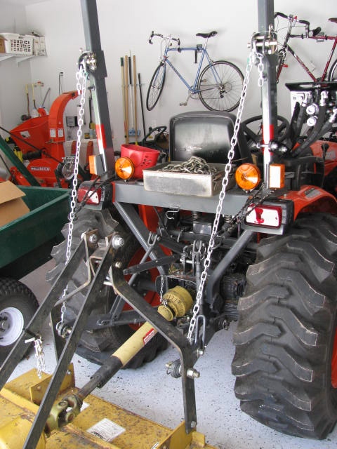

Photo #4 is a discarded idea. I considered using this slider/glider and grab link rather than the grab hooks but the slider/glider is too wide, it would have to be cut or ground off to 1-1/2" width in order to fit within the ROPS bracket which has 1-5/8" clearance. I am staying with grab hooks for now, honoring the KISS principle.

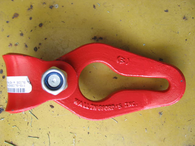

Photo #5 is another discarded idea. I would have liked to attach the limit chains via grab hooks around the lower top lift pin but the chains would rub on the metal PTO guard cage and possibly bend it.

See Photo #2: The weak point is the 1-1/2" steel ring; just a 200 pound working load. I will add a second ring, same size, on each side tomorrow. Then search for heavier rings or install 3/8" forged Eye Bolts to replace the weak rings. You could use 1-1/4" steel rings and still have room to attach the 5/16" Quick Links but the working load for the smaller rings is only 150 pounds. There is not much "pull" on the chains. They are LIMIT chains not support chains. The 3-Point lift arms are bearing most of the weight. Heaving on the attached individual chains I guesstimate the cutter weight on each chain at about 50 pounds, in static condition, WITH MY EQUIPMENT.
See Photo #3: Several reply posts to my earlier thread warned against using the ROPS for securing the limit chains at the top. But the ROPS on my Kubota B3300 is massive and attaches directly to the tractor frame and it is only supporting chain pull of about 50 pounds on each side. I realize the stress may double or triple when mowing but that is still no big deal relative to the massive ROPS, in my opinion. (The chains are actually supported by the ROPS fold bracket, which is bolted through the ROPS.) If I become concerned I will install a stiff spring as a shock absorber in the middle of each chain. Unhappily the grab hooks and pins have to be removed to raise or lower the ROPS.

Photo #4 is a discarded idea. I considered using this slider and grab link rather than the grab hooks but the collar/slider is too wide, it would have to be cut or ground off to 1-1/2" width in order to fit within the ROPS bracket which has 1-5/8" clearance. I am staying with grab hooks for now, honoring the KISS principle.
Sheldon Hill Forestry Supplies Inc.: CHOKE GLIDER
Photo #5 is another discard idea. I would have liked to attach the limit chains at the lower top lift pin but the chains would rub on the metal PTO guard bracket and probably bend the guard.

A link back to your first try which you suggest folks read http://www.tractorbynet.com/forums/attachments/247814-rotary-mower-adjusting-rear-deck.html
I still think you are making a serious mistake attaching the chains from the ROPS to the mower. You have spent a lot of money on hooks, links, chain, etc. and have come up with a rig that will take a lot of time to hook up and unhook. Have you tried it in the field yet?
All you are really trying to do is keep your lower links from dropping.
2 of the little red chain slot hangers through the spare hole in your top link
bracket on the tractor with a long bolt. It doesn't have to be as large a dia bolt as the holes in your upper link bracket.
Run 2 chains from the front mower bracket or your lower lift links to the
chain slot hooks and your done. Take the other stuff back for a refund or use it someday for something else. As you said. KISS

In regard to your statement "Photo #5 is another discard idea. I would have liked to attach the limit chains at the lower top lift pin but the chains would rub on the metal PTO guard bracket and probably bend the guard."
If you recall the yellow Woods chain hooks in the picture I sent you were bent on the end that attached to the outside of the upper link bracket. That keeps the chains from contacting the PTO cage. You could add a little piece of metal with a 20-45 degree angle bent in it to the bolt end of your red chain brackets and have a hole in the other end for the bolt or link pin to go through your center link bracket on the tractor, if using them straight causes any rubbing action.

Glider will not fit where you suggest. The PTO metal cage, visible in photo #5, is directly in the way.
