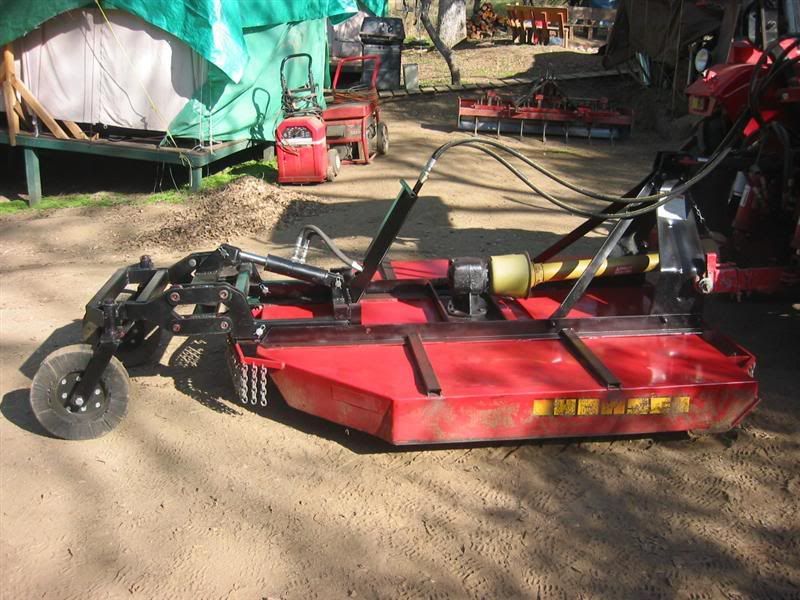

I built a Quick Attach Hydraulic set of guage wheels.
The pivot points for the wheels are vertical so they respond better when switch from forward to reverse. Plus, the linkage keeps the vertical position constant when raised or lowered. I use it on the rear of the Howse rotary cutter, the box blade and also on a landscape rake. They are super heavy duty and can be switched over in a few minutes.
It's primary use is on the rotary cutter.
I use it in conjunction with the 3pt lift to mow rough terrain. So I can set the front AND rear height while mowing. I made a "bumper" on it for reversing into shrubs and saplings to help push them down. I can lift the rear wheels up, out of the way, and use the 3pt to suspend the cutter while backing into shrubs and saplings. When I lift the wheels up, the rear of the cutter is actually on the ground until I raise it with the 3 point. There is about 10" of lift from top to bottom, which I can set while driving the tractor.
You might be interested in making a set similar to this to solve your problem? Here is thread of how they were made and used with lots of photos in them:
Modify Brush Hog Some More
Here is a thread about using the Gauge Wheels on the Box Blade:
Hydraulic Quick Attach Gauge Wheels

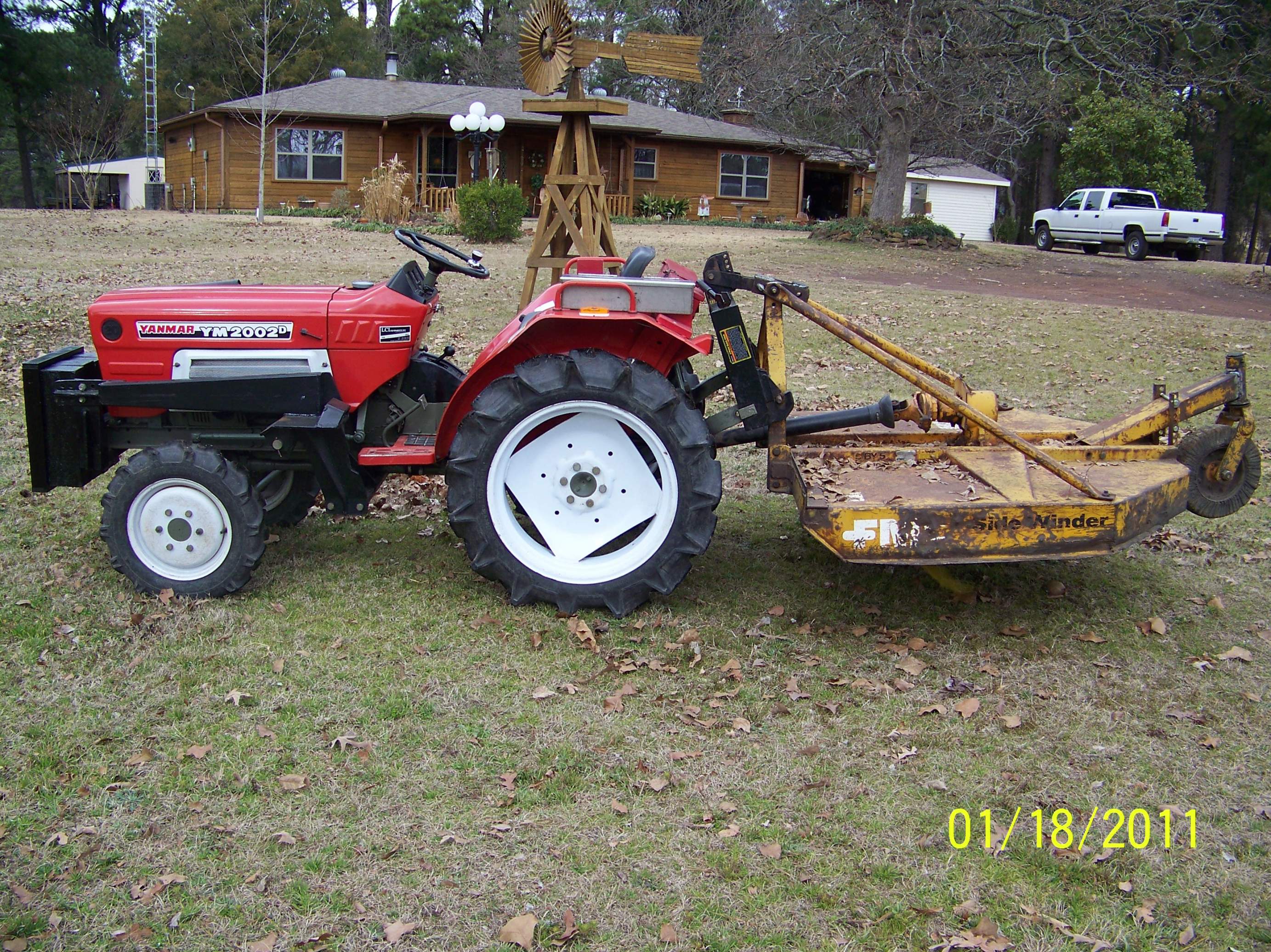

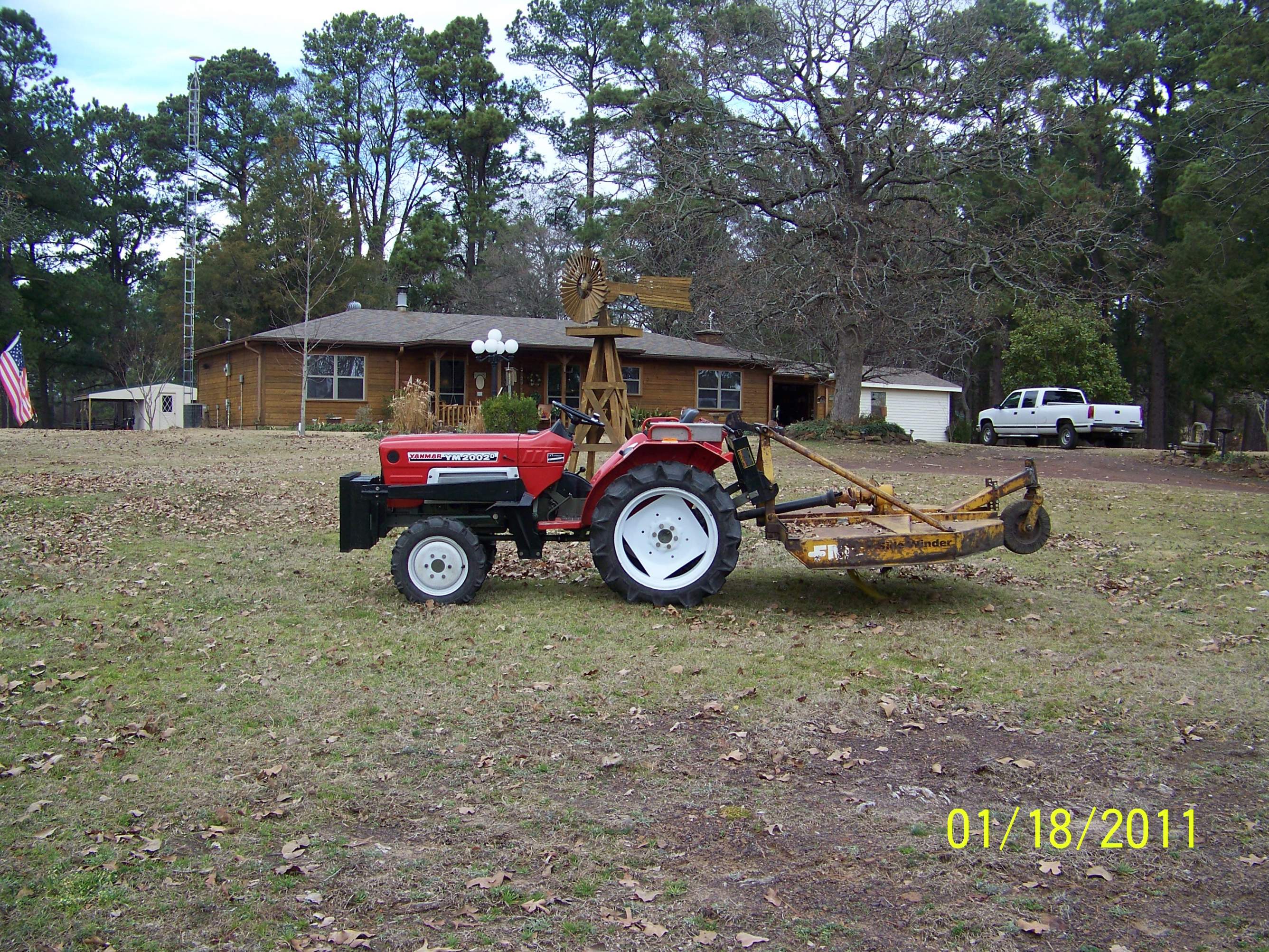

/ rotary mower tail wheel???????????
Rob,
That is impressive!!!!! After hearing from ya all (Texas) and looking at a fair amount of different mowers on line I have concluded most mowers have an intentional angle on the tail wheel spindle to raise the rear end when reversing. This old FMC sidewinder is heavily built and I do not believe any part of the wheel assembly has been bent or warped. With the mower in the level position with tailwheel set at my preferred height the spindle angle was appx 20 degrees off plumb. I have cut it loose, changed the angle to appx 5 degrees. The lift in reverse went from appx 4" to appx 1-1/4". I think I am going to like this a whole lot better. Going to try and post a picture of finished product. My first try. Thanks for all the feedback.

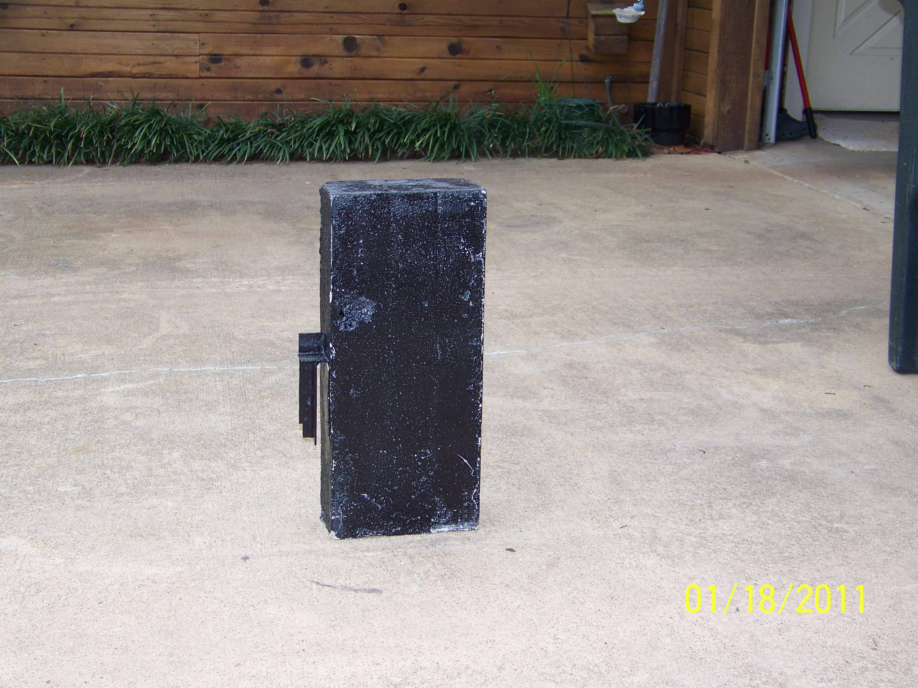

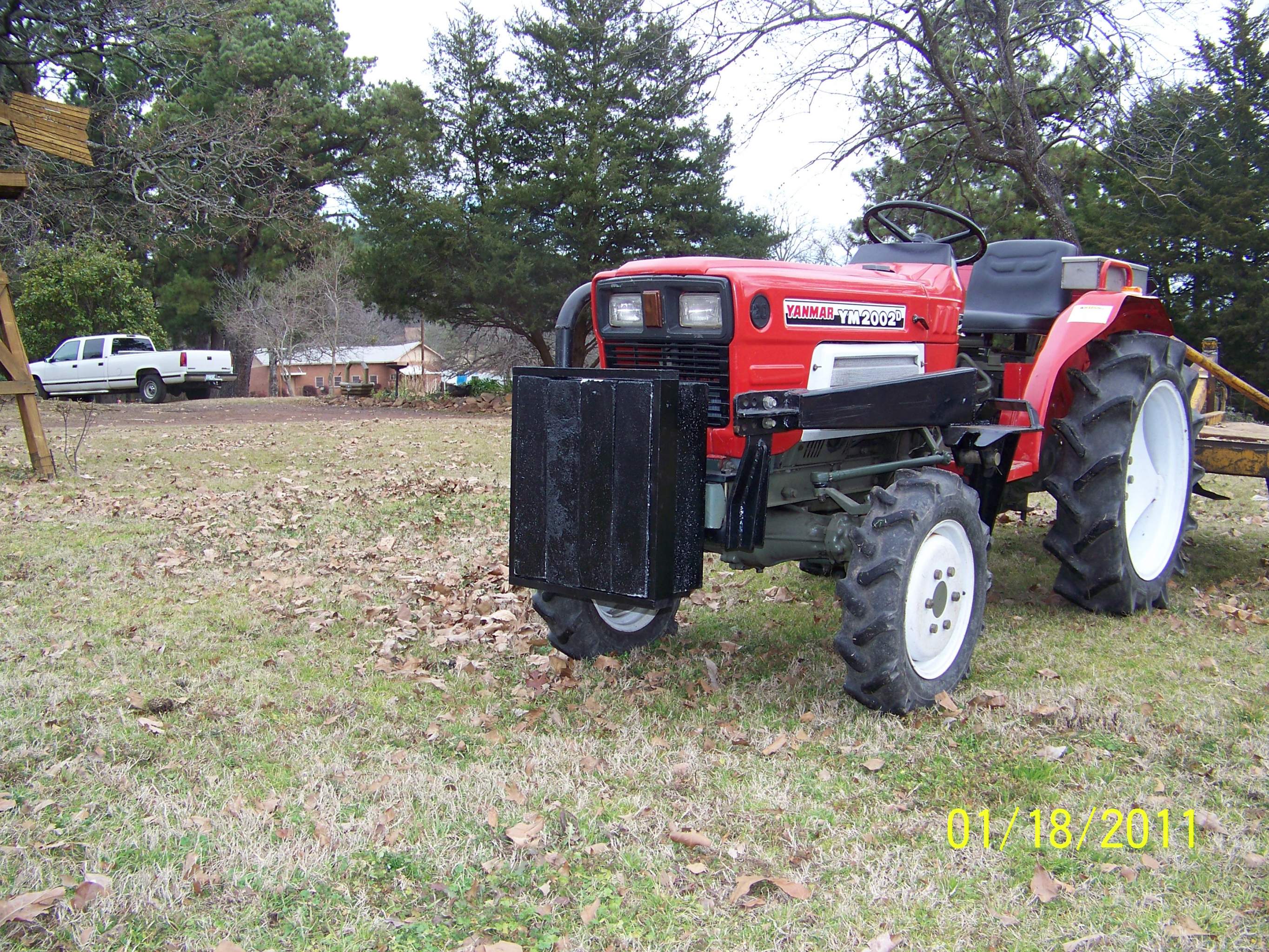

I'm so proud of my first picture I thought I might just post a few more. I'm cheap which gets me into trouble sometimes. Made my suitcase weights out of good sackcrete with a little angle iron inserted for the hanger. According to my bathroom scales they weigh in at 49-51#. All four just about right to balance out the mower. I also have a bracket that holds 2 of them together if there's reason to have less weight. If my loader is on of course I don't need the weights but it's off about 75% of the time. I'm jealous of Rob's quick hitch tail wheels. Thanks again for all the input. PS That is a HF quick hitch, perfect fit for the mower. Modified numerous implements to fit it but wouldn't take for it.

/ rotary mower tail wheel??????????? #8
If you're happy with the results, that's all that counts. But I wish you'd have posted that first photo before you started modifying. It looks like that the fork has been worked on (welded) before. I don't think your problem was the spindle angle, my money is on the fork angle. It's far to severe. I believe the correct repair would to have been leave the spindle alone, and reduce the fork angle.
#9
I agree it looks like a severe angle. The pictures may make it look worse than it is. However, if you could see it in person I think you would agree it is not bent or warped from original shape. Looking at other brands on-line it seems there are some with more and some with less angle.

/ rotary mower tail wheel??????????? #12
Greg said it best, that if you're satisfied, that's all that counts.
Good job on changing the angle the angle to 5 degrees. I'm sure, regardless of the angle on the forks, that your tail wheel will respond much better when reversing and turning. Thanks for sharing your project!
