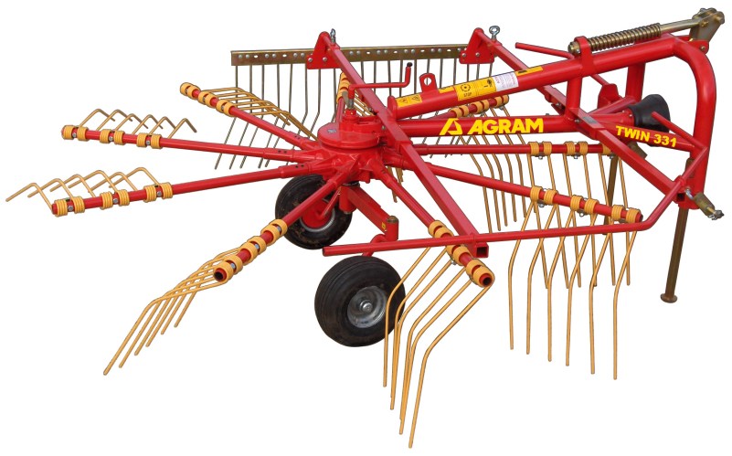

The HayMAG rotary rakes are $3,200. TOT330-9.jpg Look at the Video below.
[video]http://www.haytools.com/public_html/images/Turkay/TOT330.wmv[/video]
