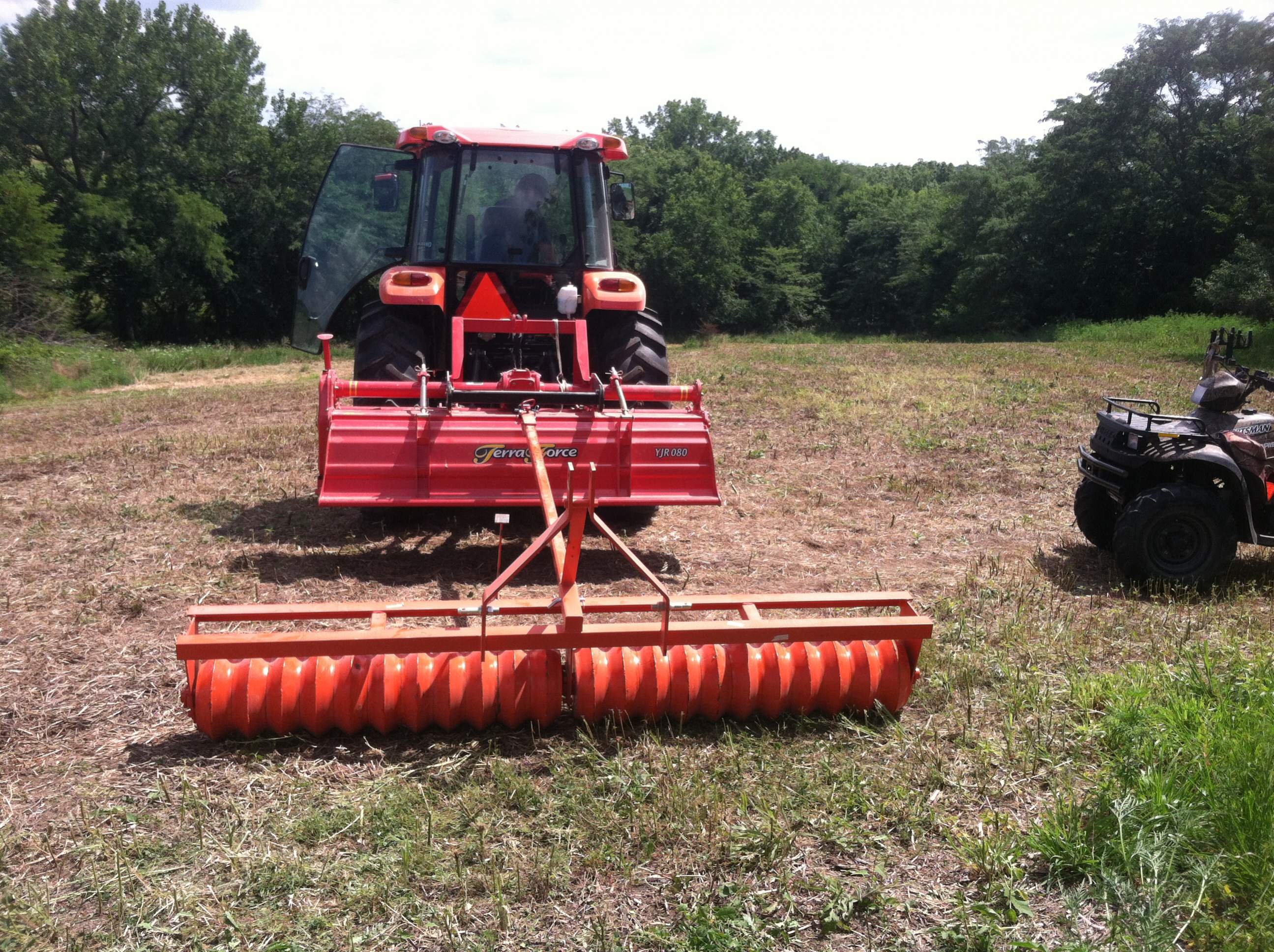

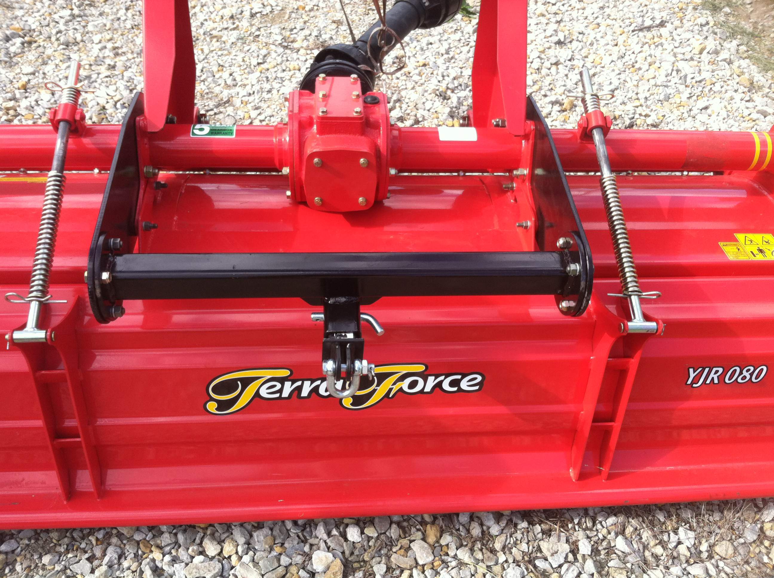

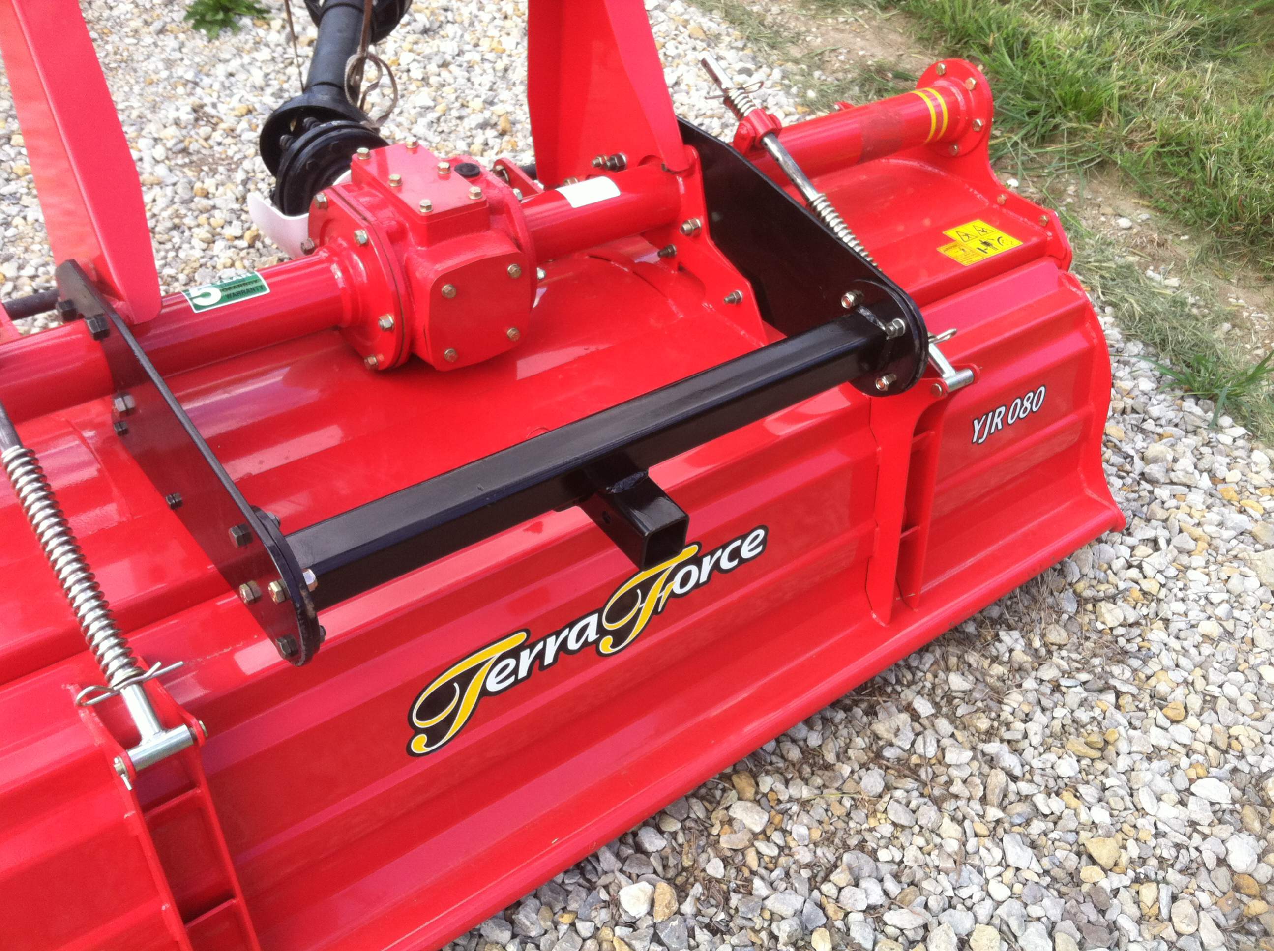

Here are a couple of photos of my YJR080 tiller and the mount I fabricated to allow hooking up an 8 foot cultipacker (acquired from Edwards Implement). This setup works great for a single pass seedbed preparation for small seed (brassicas and clover) planting.
   / Rotary Tillers - Sicma Phoenix vs Ansung Terra Force #47
that is neat ,thanks for the pics
