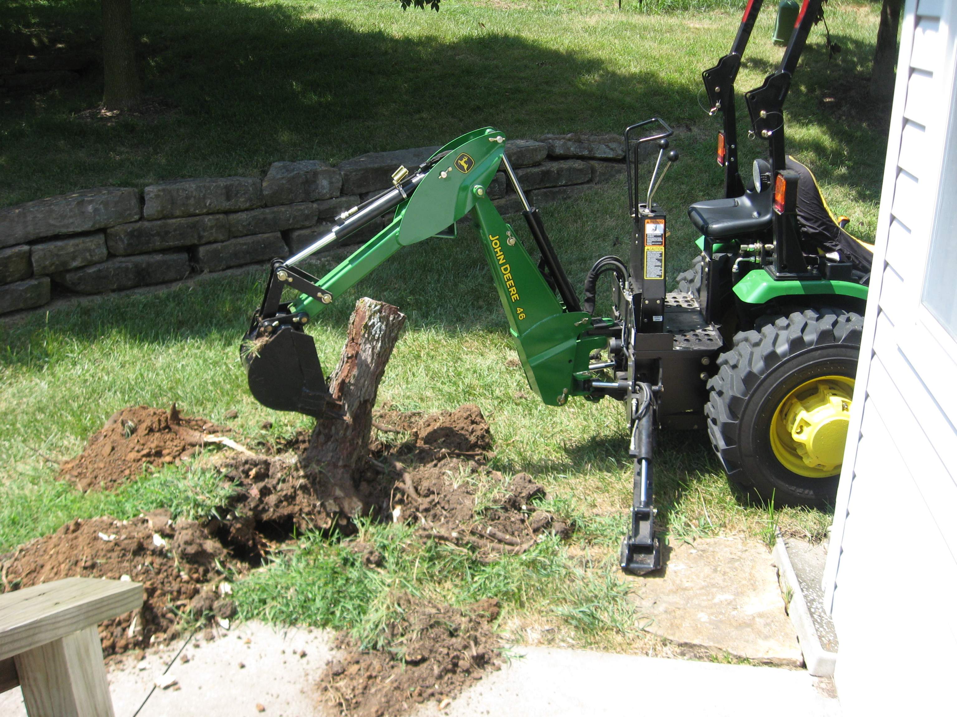

I kind of like having a separate seat on the 2520. When I want to reposition the machine, I just step from the backhoe platform onto the left rear tire, then onto the operator platform. Both seats stay in the down position and I don't have to mess with swivelling a seat. Works good for me anyway.
