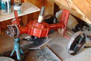

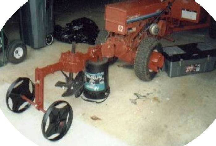

I had a Gravely 5665 (12 hp). Had all sorts of attachments for it but later bought a used rotary plow to till some virgin ground (lots of fescue). It did fine. Later used it to make raised rows in the plowed ground. That's it. Went no till and never used it again. Sold it with the plow and all the other implements when I got my JD 4WD.
Rotary plow worked great. Took me a while to get the wheels unfrozen (rusted) to the axles.
Ralph
