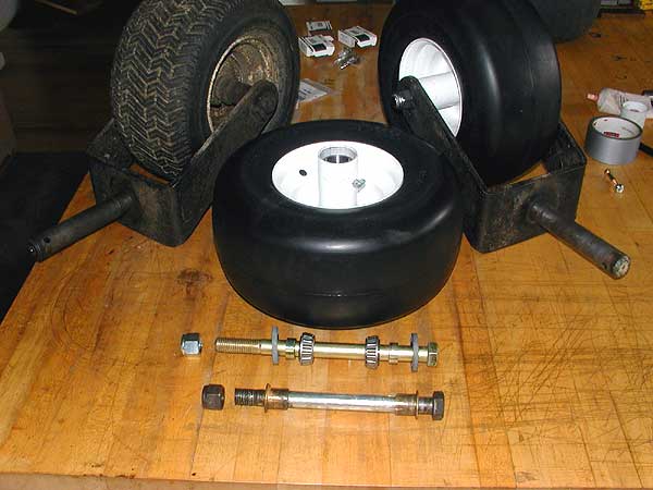

Ok - here's a picture.
After suffering many many flats, punctures and roll-offs with the front caster wheels the last straw was breaking the center hub out of one of them. That finally sent me off to in search of a solid wheel setup. Counterman Mike at Columbia Tractor patiently spent a fair bit of time with me looking through his catalogs and I finally settled on 13 X 6.50 - 6 solid rubber tires mounted on wheels with a 7.25 inch long hub which comes fitted with tapered roller bearing cups. The tires will certainly be a huge improvement as will the tapered roller bearings. I hope the rims are tougher too! (BTW, I don't know who makes these tire/wheel assemblies but they came with an Exmark label on them) There's a full parts list on my website here with Columbia Tractor's part numbers should anyone be interested in a set.
The sleeve bushings I used to cut four 7/16in long spacers. These form a surface for the oil seals to ride on and project 1/16in beyond the wheel hub so the hub doesn't rub on the caster yoke.
The caster yokes as built by Power-Trac have 7 inches between the arms. A few carefully applied whacks of a 10lb sledge spread them to 7-1/4 for the new hubs.
The 3/4 x 10 bolts are a little long (to get a long enough unthreaded portion for the axle) and were later cut to just accomodate the nylon lock nuts.
