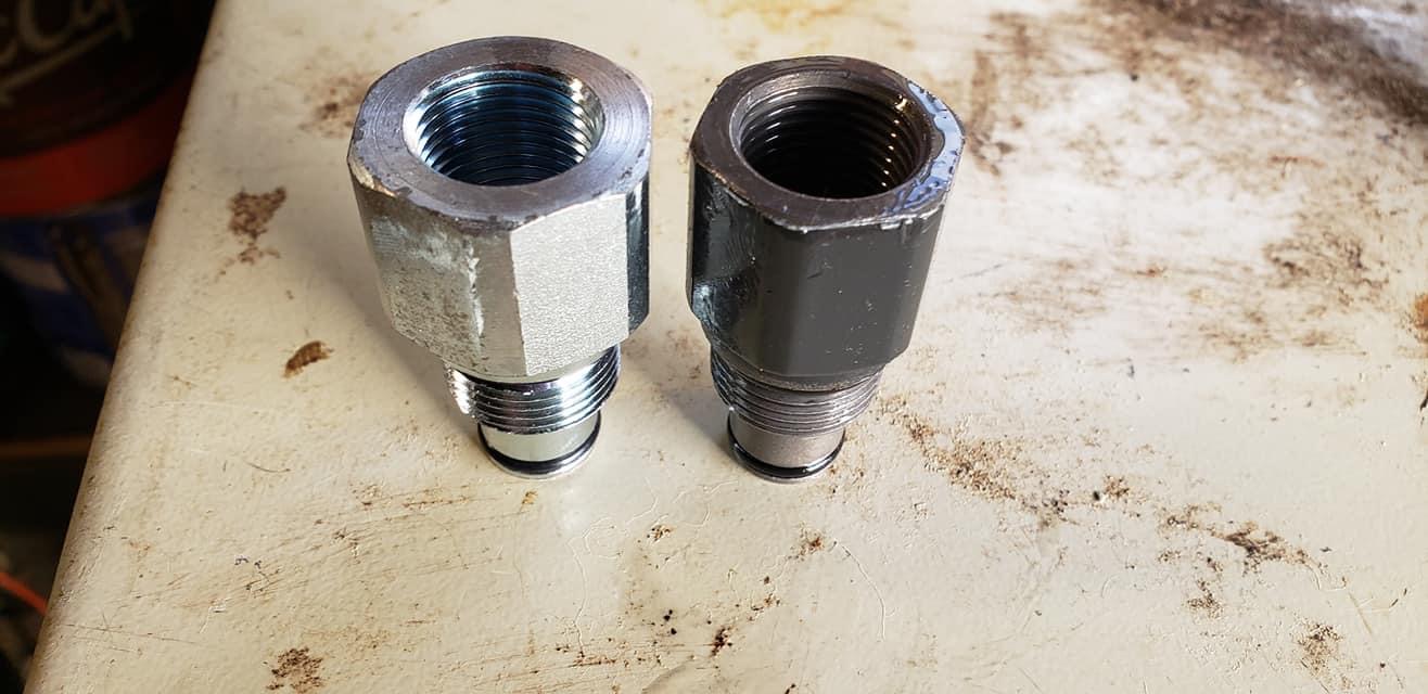

Default CK3510 SE Hydraulic Leak - O Ring / Paint -
I did a post a few months back - my unit had 65Hrs. on it when the O ring let go, I'm not aware of any recall for them, all I got from the dealer was we've had a few of them do it, when I took it apart I found a split O Ring - but noticed the fitting was not tightened down, it appeared the factory had painted over it and the paint actually was holding the flood back for as long as it could!!! I've had no issues since I replaced the O rings - I'm wondering if the recall is simply to make sure that particular fitting is set properly - mine obviously was not, it appeared O ring was placed in on an angle and cut when tightened most likely preventing the proper seal....
