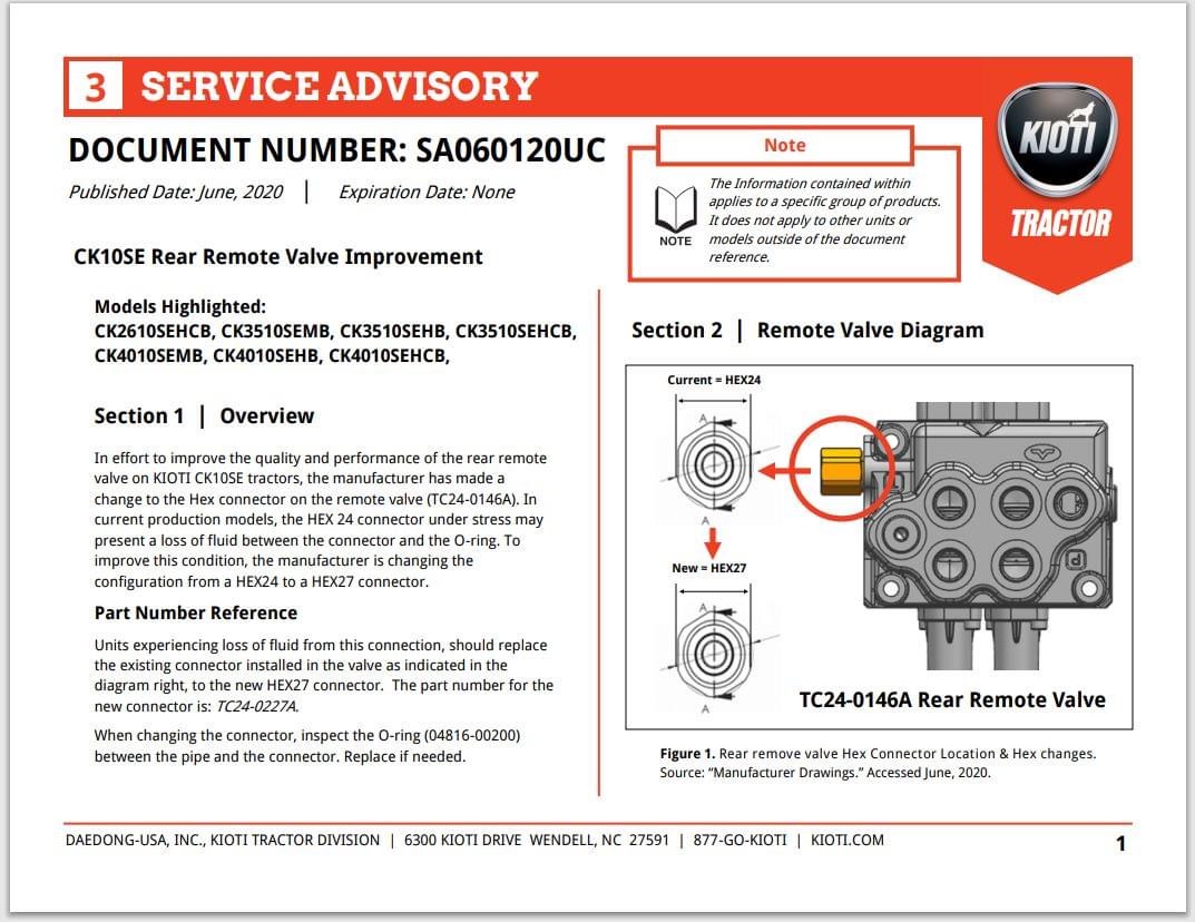

Well, we bought (or thought we bought, but not really??) a new ck2610. Dealer delivered in on saturday. 5 minutes after he left, I started to dig a post hole and hydraulic fluid starts squirting out (a steady stream) from under the seat -- all over me, the hood, all parts under the seat, fender, tires, etc. Called the dealer, they picked it back up.
Monday, no communication. Tuesday, we contact them "oh, the tractor is fixed (O-ring blew out, now replaced)" -- "we'll bring it back in about 10 days or so." Doom on me. I have ~14 trees sitting in containers, waiting to be put in the ground, a fence to build, etc etc. Why the wait? Oh, "we are short on employees, 2 on vacation, and can't get away until mid-next week."
Then, another piece of info, I had to pull out of them (from a manager who was more transparent than the owner). Apparently there's a service bulletin out on this hydraulic leak. All (? - not sure which years) CK series need to have a part installed that will prevent the O-ring blow out. Tractor needs to go to the dealer to accomplish this service bulletin.

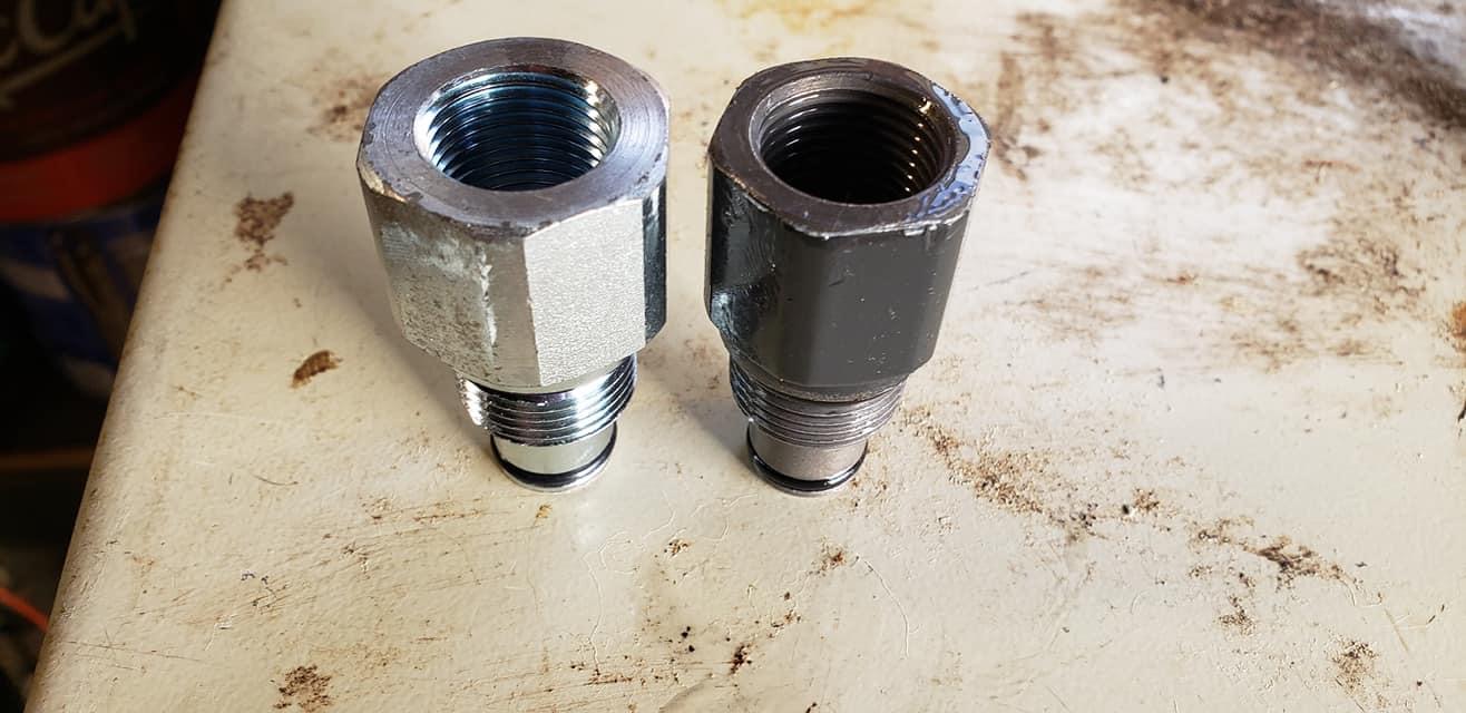

My 3510 had it earlier this year. Dealer put new oring while waiting on the new fitting. Had to do so twice but neither time was the leak more than a a few drops. I didn’t even have to add fluid either time.
Here is the bulletin and pic of the original vs larger/improved fitting. Since getting this I have about 50 hours without issue.

That is a power beyond plug from the valve manufacturer that Kioti bough the hydraulic valve from.

Well, they were quite vague about when, how, etc., it would be fixed. And they also said there was a newly issued service bulletin for the CK2610 that they were waiting on a part to fix (which was associated with the initial hydraulic leak). The latter claim turned out to not be true (there was a service bulletin, but it didn't apply to the CK2610). So, the story from the dealer was changing by the day. And since the dealer is a 3 hour drive away, and I was busy with other things, I rearranged my priorities to work around their poor service.
When the tractor was finally re-delivered, the driver told me they had the tractor fixed in 30 minutes after it was returned. And, he said that the real reason for the delay was that both drivers were on vacation.
Net/net, this dealer is unethical and either doesn't care or is ignorant of the basics of providing quality customer service. -- The good thing is that the tractor is now running fine, we are quite happy with it, and we will never interact with this dealer again.
