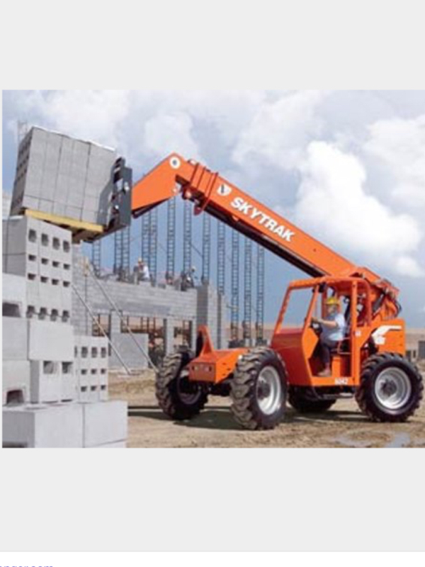

Then there is the mighty telehandler. These lift the highest ( over 50 feet for a big one ) they weigh the most ( over 30 thousand pounds for a good sized one ) they lift the most ( and easy 5 ton for a good sized one ) they are the largest in size and cost the most. A telehandler would definitely gain you a huge amount of cool points though.

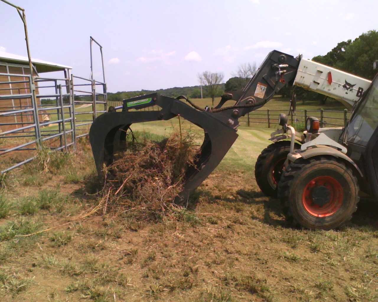

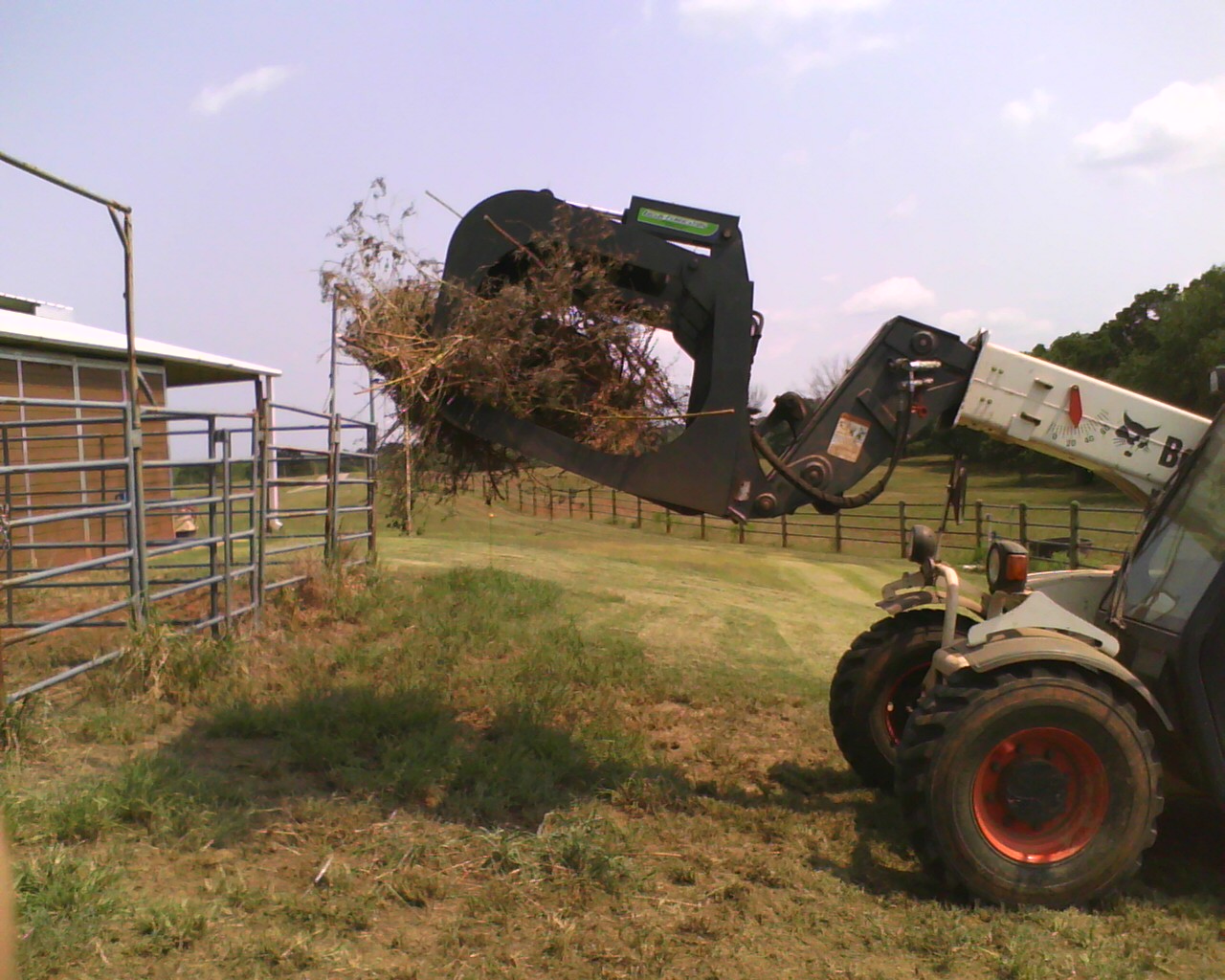

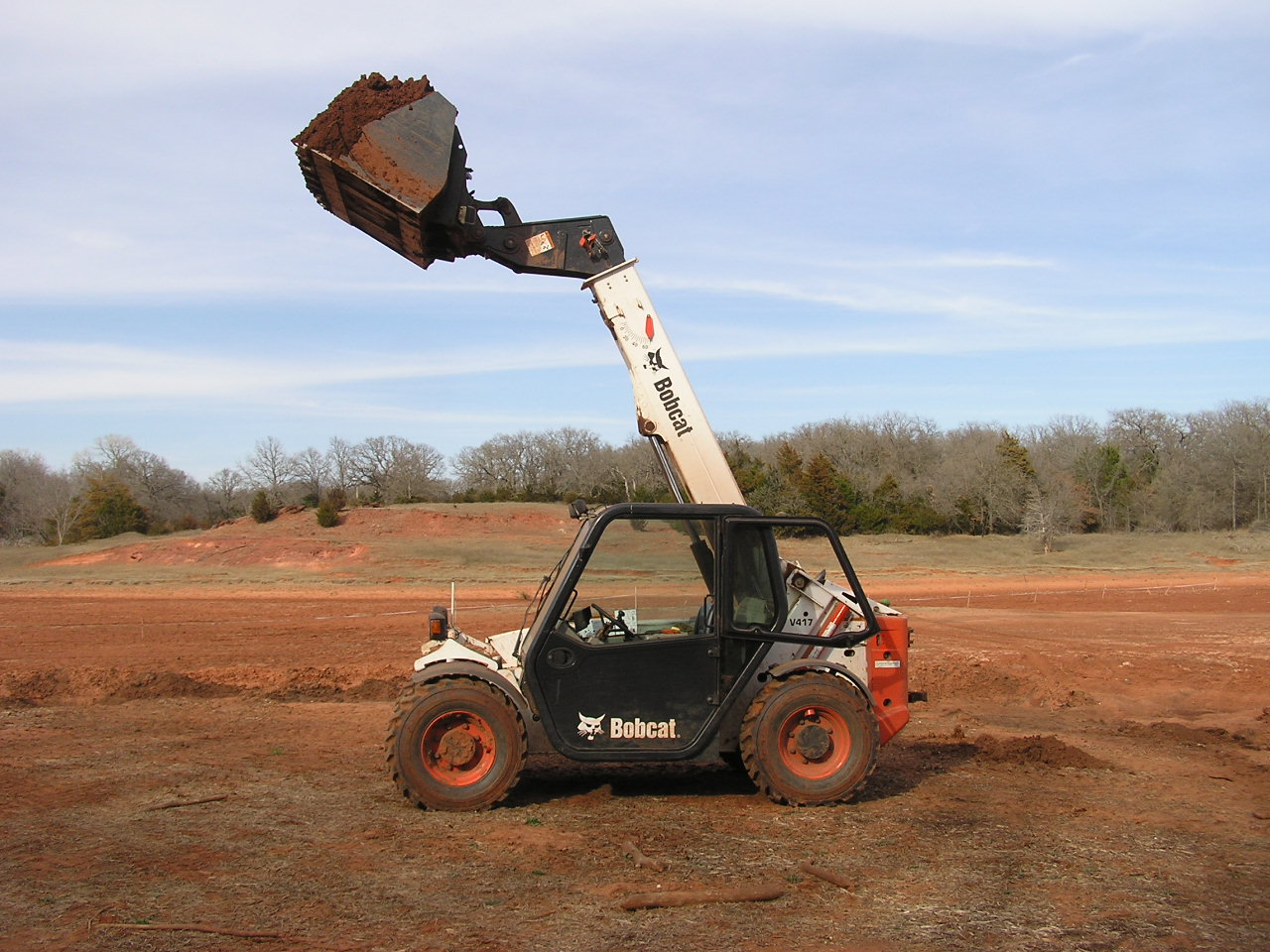

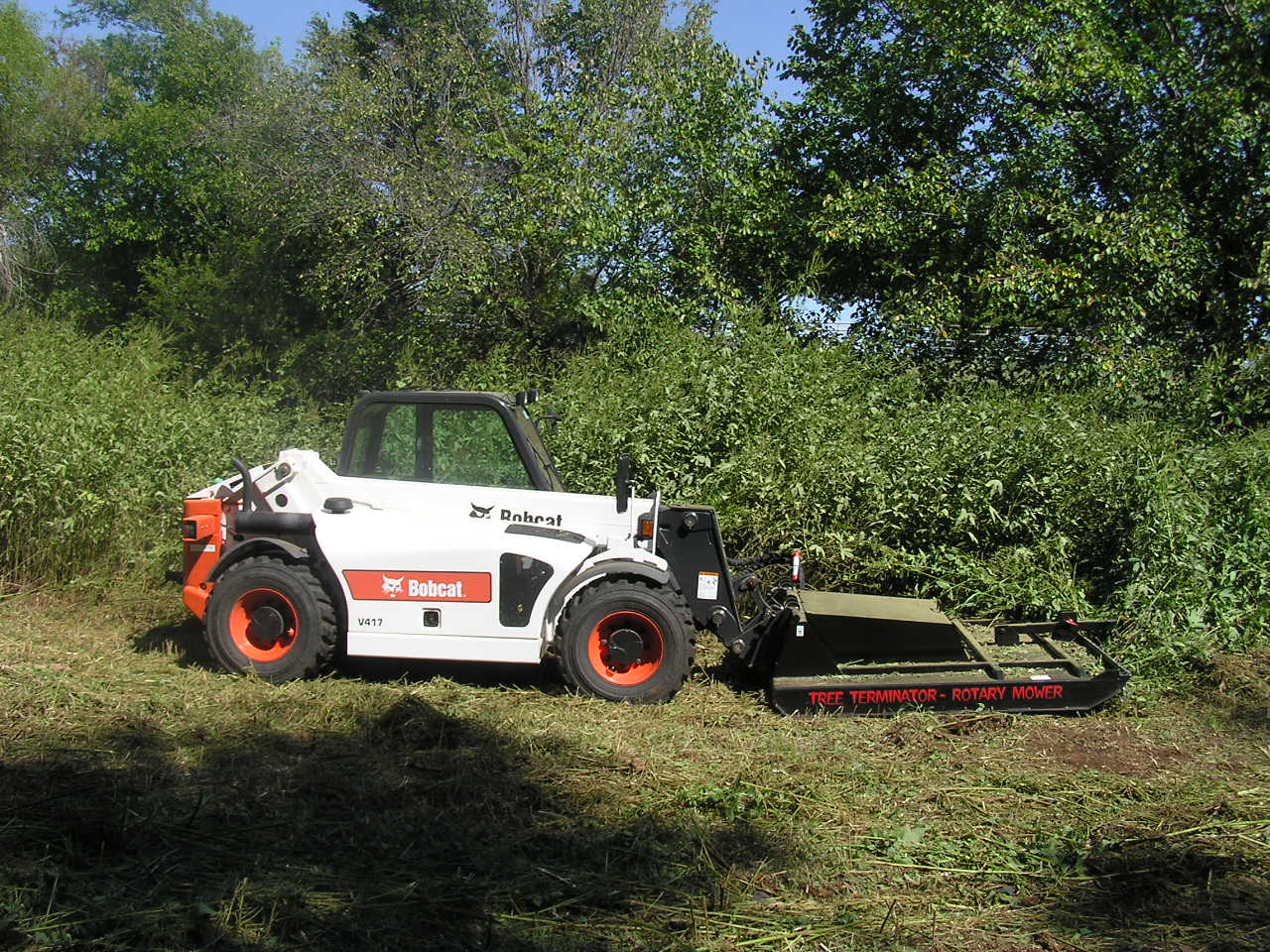

This is the my multi-purpose machine.
For dirt
With a grapple
With a 7' brush hog
And of course, pallet forks.
It uses skid steer attachments, so it can do most things that you need done. :thumbsup:

You can't do dirt work with the full size ones that I know about, because it will break the boom where it goes down to the attachment.
Full size doesn't have SSQA and high flow hydraulics.
I don't need to lift twice as much or twice as high and due to the compact size, it will do more than a tractor with the same horsepower.
