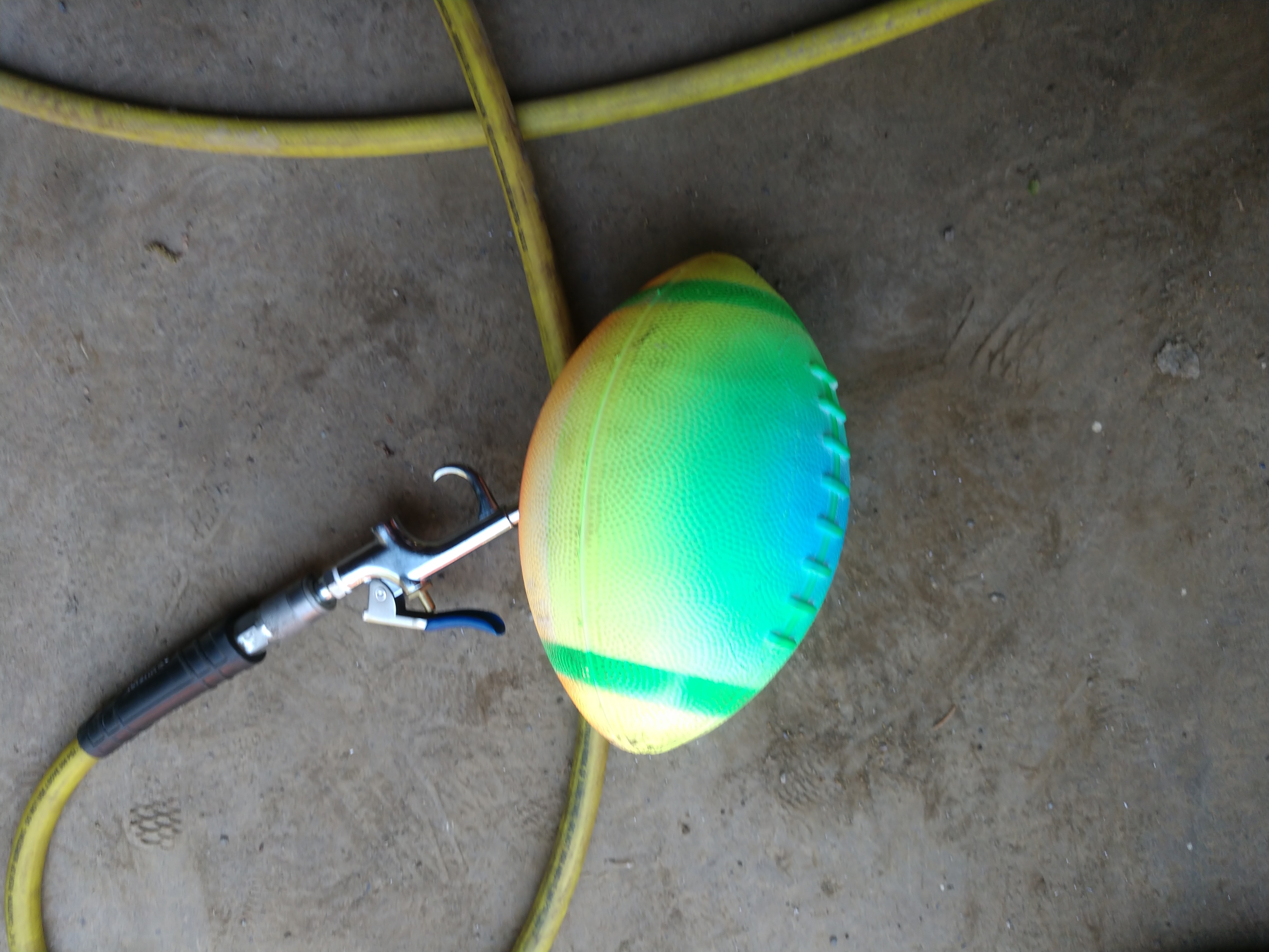

Now my mower needed some help with it's mechanical suspension seat, it was bottomed out most of the time,
I may buy an air spring some day to add into it but for now I have a $3 air aid ( from the kid toy box in the store) which helps considerably;
you can laugh all you'd like but it works.
