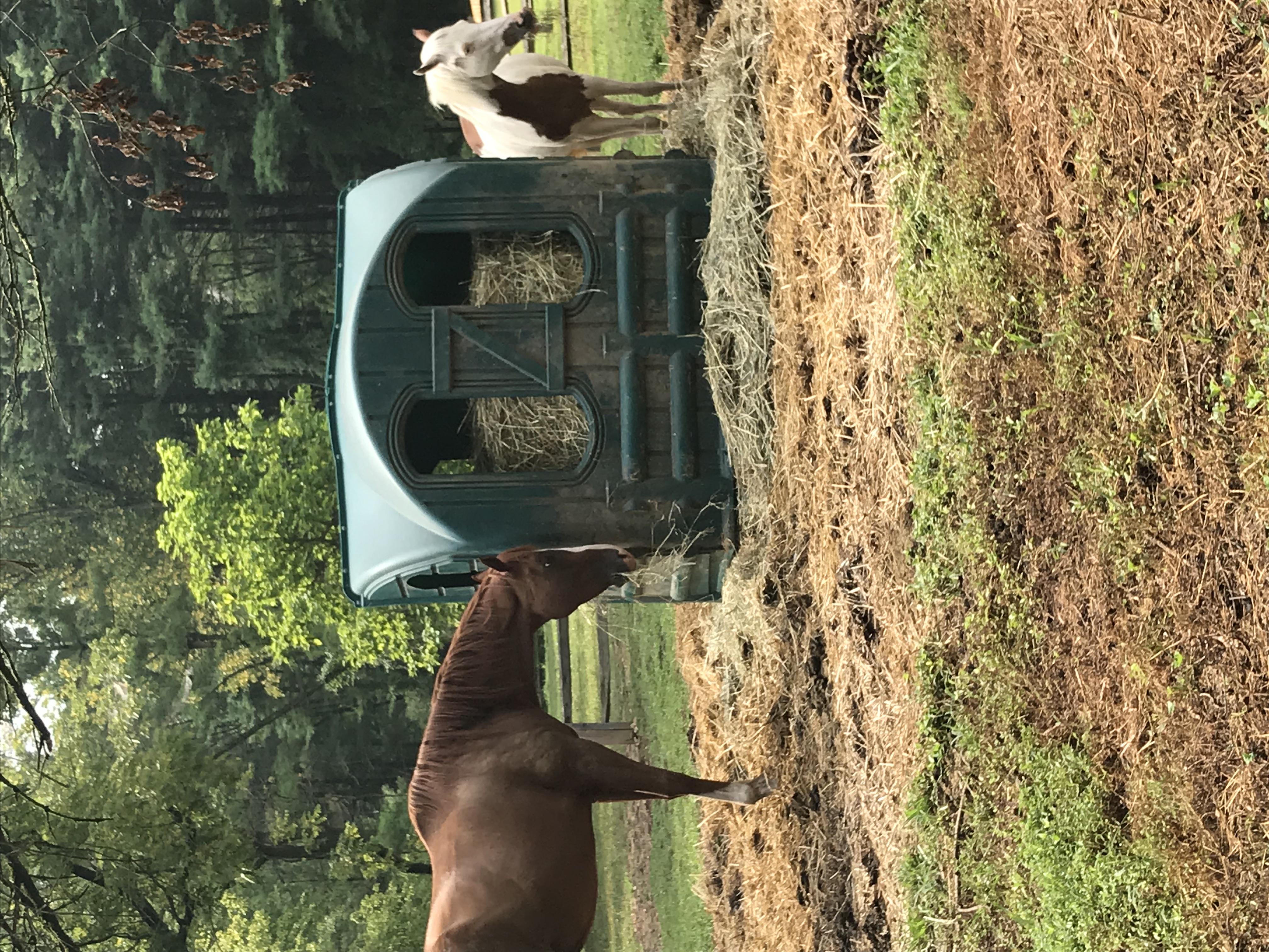

/ Round bale feeder #5
I like the Hay Hut.
$900
No rot, rust, rain, snow or ice issues.
No plastic touching the bale causing mold. No sharp openings.
Can feed several at once. Easy to load.

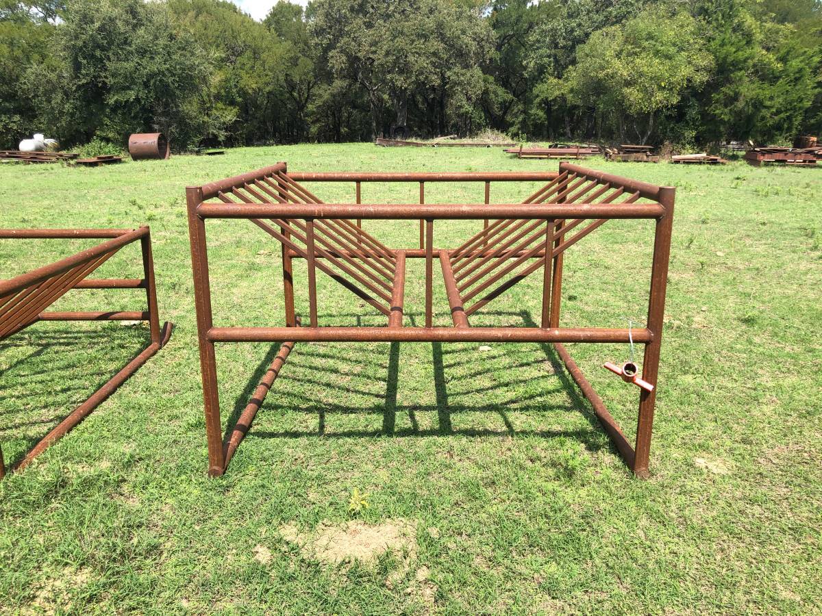

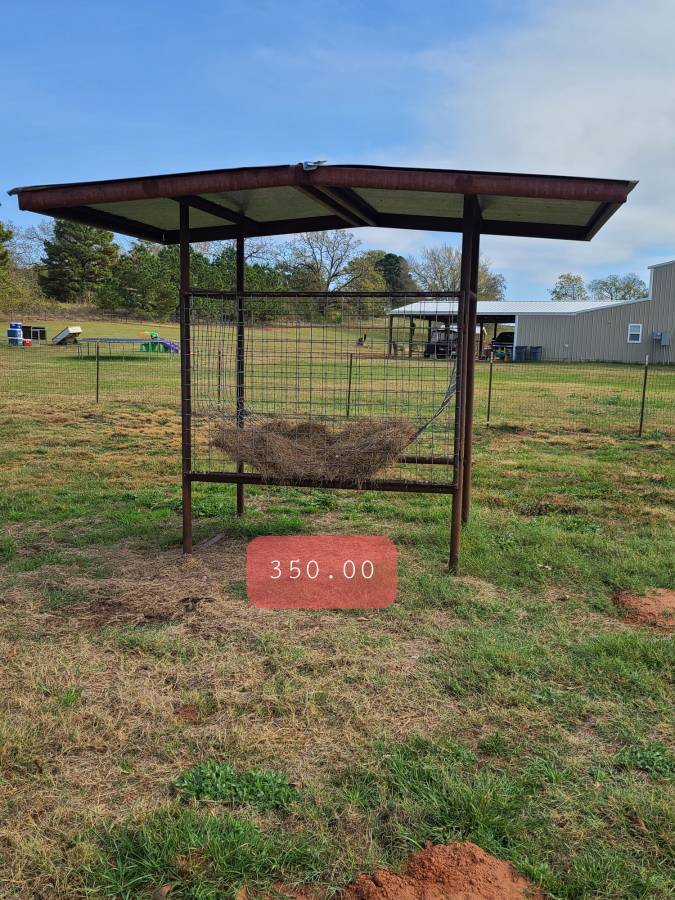

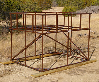

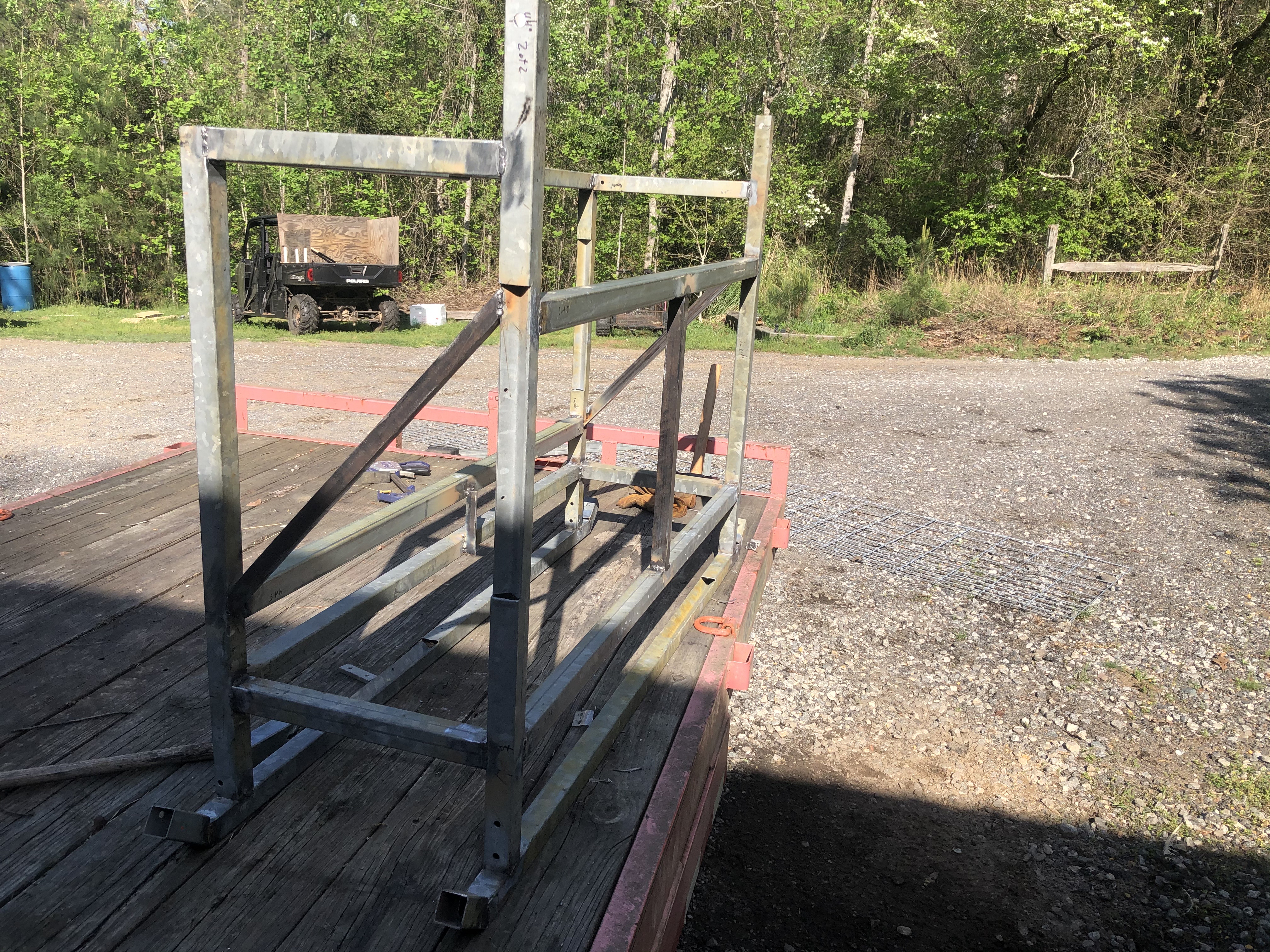

/ Round bale feeder #6
I'm looking at building a round bale feeder with a roof.
I found a couple different ideas on craigslist that I might build with some modifications. This one with the roof looks pretty simple, but I'd probably beef it up some and add skids.
The other one is beefier, and I could extend the four posts up to support a roof. Still designing it in my head. I might even get it galvanized after I fab it.

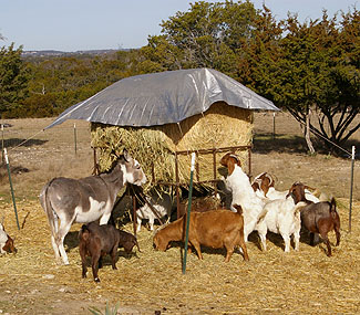

/ Round bale feeder #9
We have been using these for ten+ years. Goats and donkeys, nothing bigger. Tarps are tied off to t-posts on the four corners.
