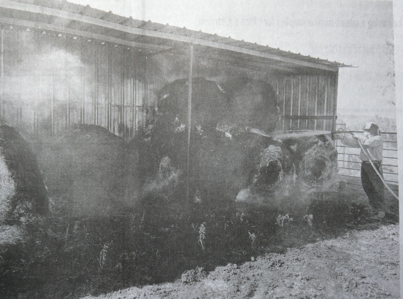

I feel sorry for man spraying burning bales. Burning rd bales are almost impossible to extinguish the fire once started I wonder if bales were made at too high moisture %. I see no good reason for high moisture rd bales being accidently baled during a drought.
Many yrs ago I accidently lost 50 rd bales that started burning from escaped flames from a distant trash fire.
