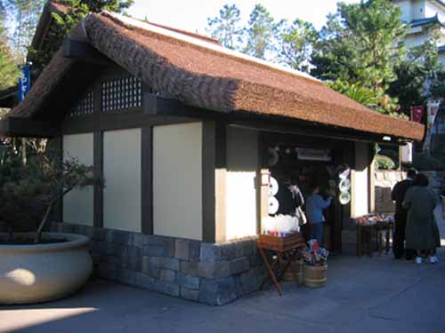

I think I've settled on a Japanese style barn. But not a temple style. I snapped this picture a little while back while on a business trip. I really like the design. It would go well with our home.
The THATCH roof will probably be replaced with slate or some similar material. The barn, will be about the size of a 3 car garage, so it is going to be fairly small. 2 rooms, one for storage, one as a workshop area.
I did price thatch and synthetic thatch. It runs about $1300 per square!
Anyway, here is the general design I think I've settled on. The lovely Mrs_Bob doesn't seem to object to this, however, as our house is stained with a tan color, we'd probably have the stucco areas tan instead of white. Construction won't begin for a couple more months (got to get rid of the snow). I do need to get approval from the achitectural control committee for our area, so that could also cause some issues.

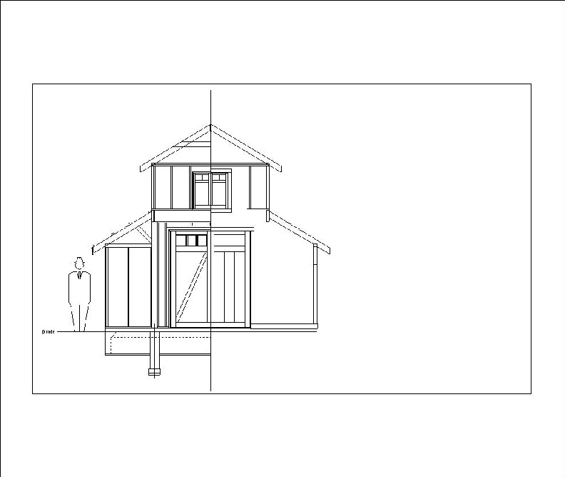

I'd be inetrested in the framer's opinion on pole v. stick as in the design of my machine shed I went from pole to stick because as I started adding detail the fill between poles became as much lumber as stick and was starting to get out of hand.
I too agree with you on gable v. hip. Personally, the gable is certainly within the prairie style, provides a utilitarian contrast to the main house without competing with it and provides you clear span, height advantages in the interior. I think if you just keep the pitch low enough and the eaves proprtionally large she will be happy as long as wall height doesn't steal from the design philosophy turning it into a barn.
Attached is what I am working on, obviously I'm going for a more traditional design that focuses on details....thats me in the drawing to give myself a proportion sense.
Once again I will look forward to you documenting and sharing the progress.
Regards,
Kevin

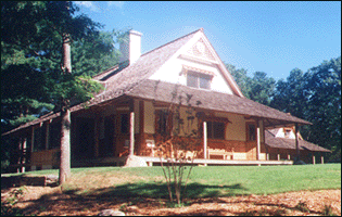

The attachment is of a Japanese style timber frame.
Ray
