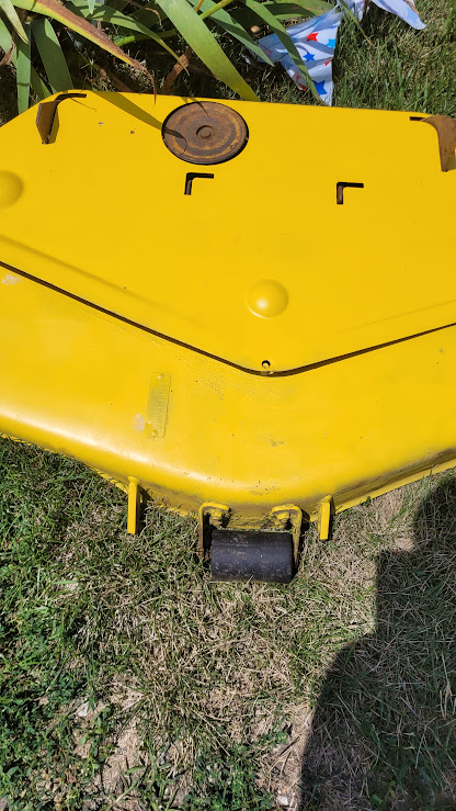

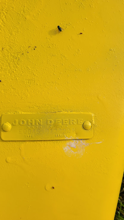

I bought a 1977 210 for $80. I mainly bought it to put on my 31 tiller so I can leave it on. The guy that had it thew in a nice solid E0046 deck which I believe is from a early round fender 110/112. He didn't have any attaching parts with it. IS it possible to put this on the 210 if I needed too? I have an extra draft plat from a 210, but the deck doesn't have any spring pins and just one set of holes. Would I just need to pin it with a couple pins and keys? And for the arms, would I be able to use a set of 47 arms to attach this? I'm also assuming the lift straps would work also but not 100% sure. I have extra attaching parts from a 39 that was on my 110 which I put a 47 on. I would assume the lift straps are the same but the side arms are different than the 47 arms. Also if it would work, any clue on belt length as they make several belts as I've been down that road before with the 110 and 47 deck.

Are you talking about a deck from a round fender 110 or 112 being mounted to a JD 210?
I didn't think there was a 46" deck fitted to a round fender, and thought it was a 37" deck.
Pics would help of your tractor and decks in question. thanks

Here's the deck I that came with it.
