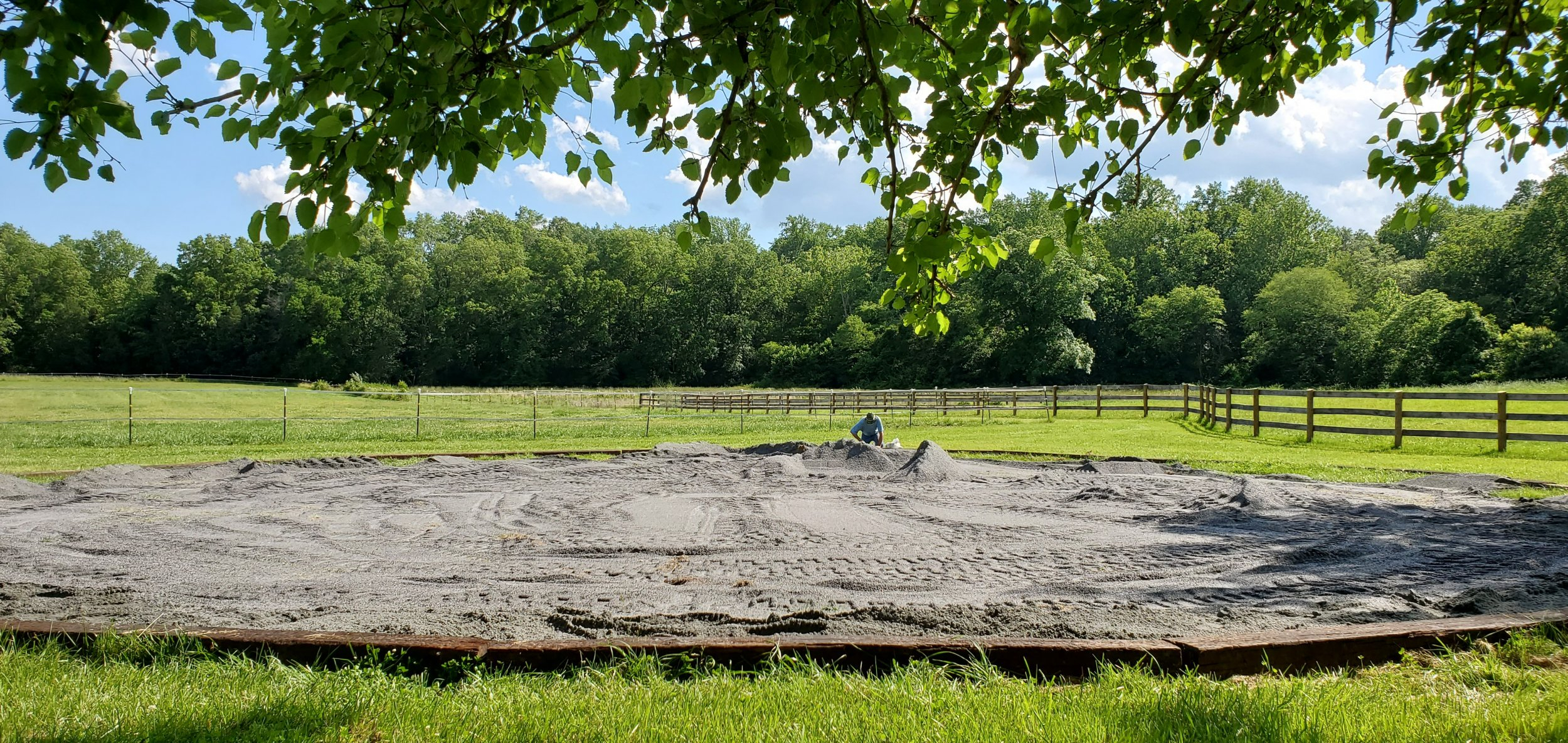

I'd stick some drain tile and gravel where you have the water issue. Take it outside the perimeter fence.
Are you planning on fencing off the round pen? Or are you leaving it in the pasture area?
We used about 10 truckloads of stone dust.

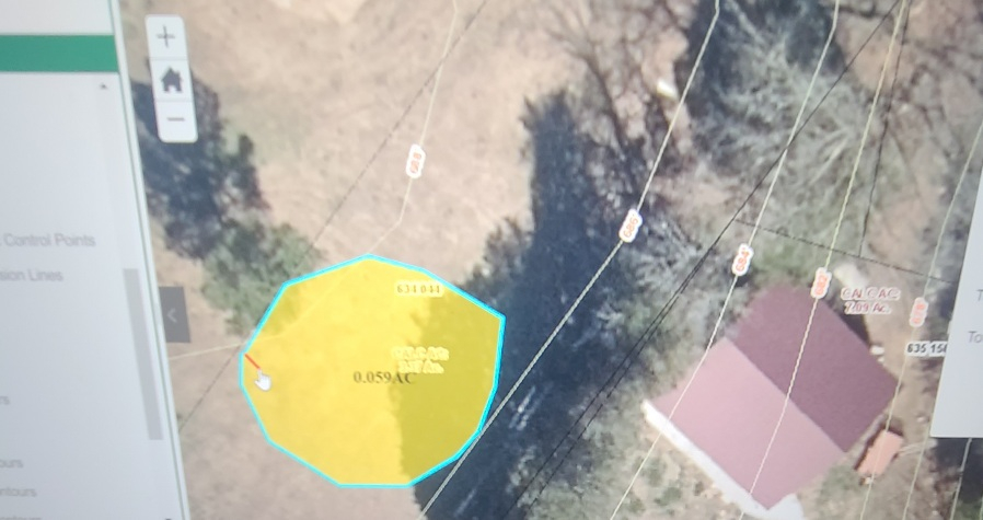

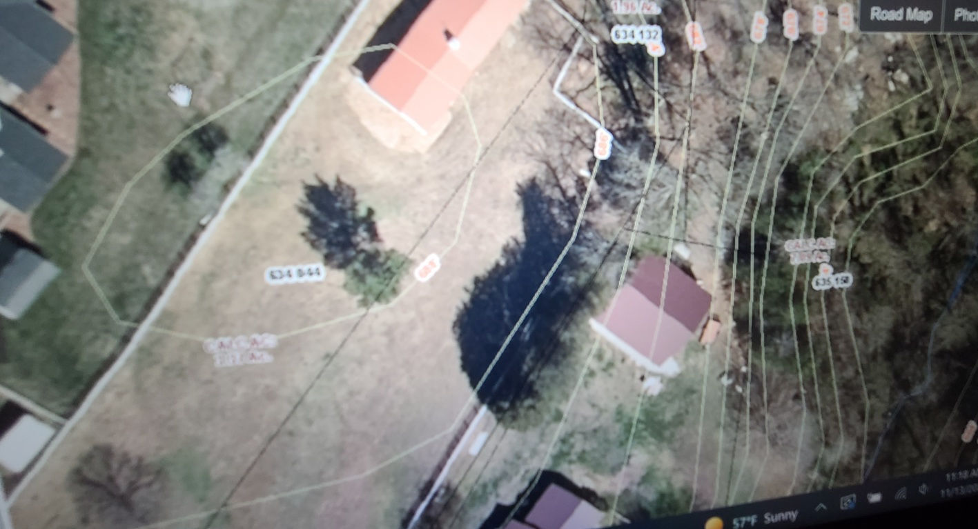

Here's a coupla more pics of the area from the county GIS site. I tried a quick area measurement tool to mark the location of the round pen. The "top" of the pen is near the lone pine. It appears that's a high point and we may have somethin like 2' of fall from the top to bottom.
If I cut a drainage down at the "bottom" would that let whatever aggregate I used out as well?
Is there a trick to it? Thanks.. :cool:

Use a "FRENCH CURTAIN" Dig a trench from the wet area under the fence to the low area. Fill the trench with coarse rock or use drainage tile, cover it with a barrier (some use 30# roofing felt) to keep the rock clean. It will drain to the low area. Cover top with dirt and seed. Research - French curtain.
It is good that you now know where the water needs to be drained. And probably good that it is close to the fence area downhill.

Not sure. In the pic you can see that all the water collects at the "bottom" of the circle.
Does that qualify? I'm kinda thinkin if I can find a way to let water out and keep sand or whatever ends up being used for footing in I'll be good.
