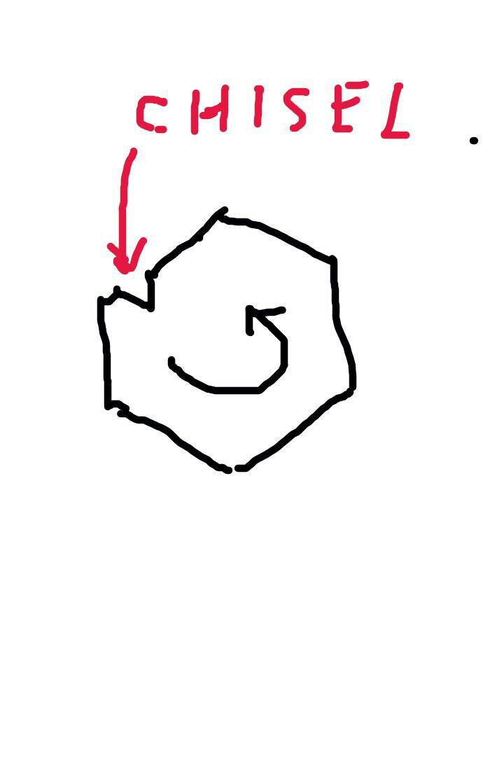

Pipe wrench has been tried again and again, both by myself and two others more experienced. Same result each time, material being sheared off the plug. If that result is due to improper grip and/or operator error, that's down to the lack of clearance around the wrench adjustment knob itself.

Cold chisel, sharpened good, applied to cut into the surface in such a way to produce torque to undo the thread. First direct blows to cut a notch in a close to radial direction, then when a good notch is established, shift the angle to being closer to tangential to the surface to make it rotate out. This is my standard method with nuts that strip out. In your case it is a plug, but apparently there is still a bit sticking out that one can access.
Whenever I tried that method, the only thing that came off was the skin on my knuckles.

Seems the moment of opportunity has passed when the plug could have come out either by doing it right or farming it out to a shop that would do it right. The plug appears pretty knarled up now and will either have to be done by a shop or it will stay in there forever.
