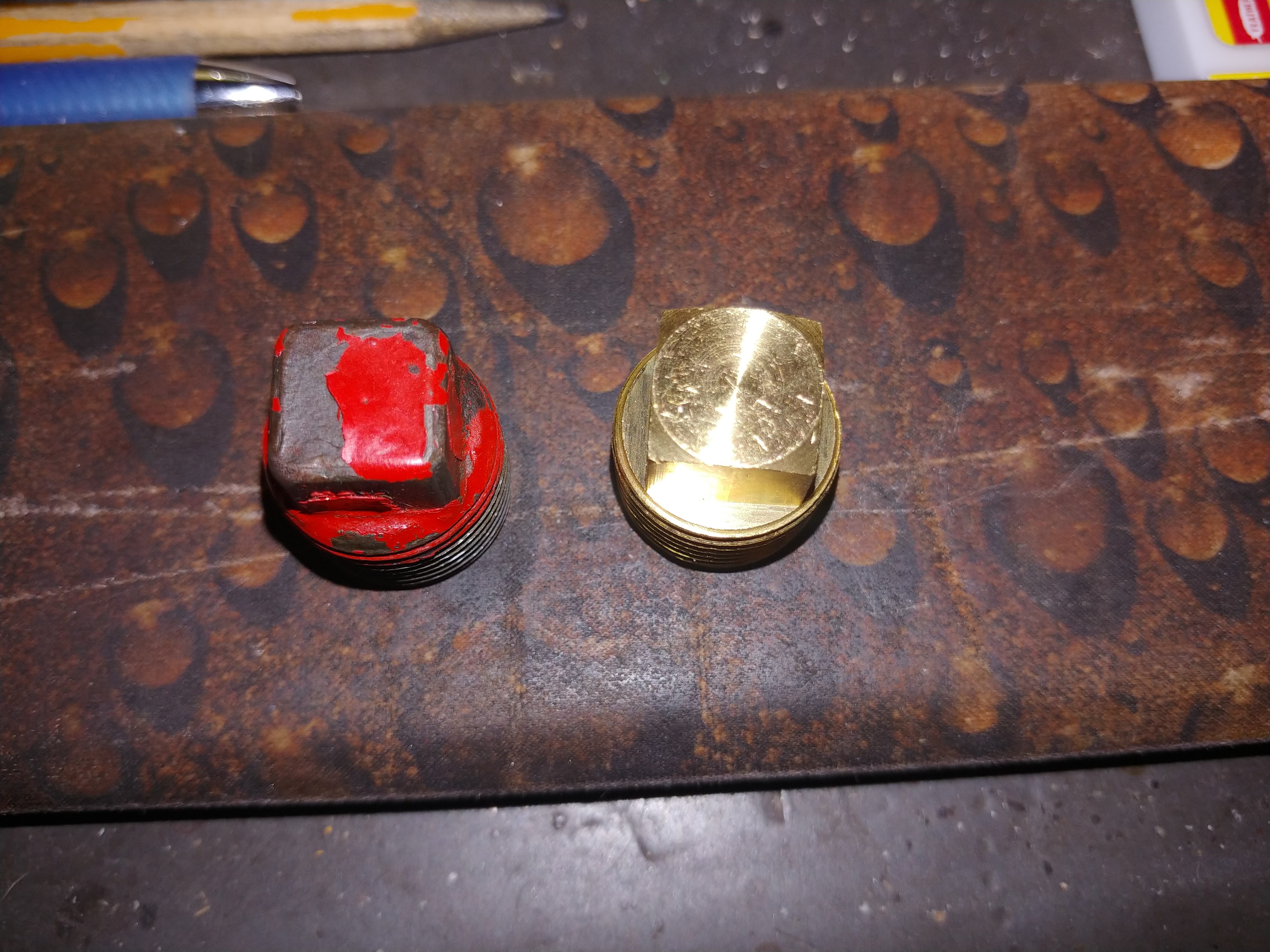

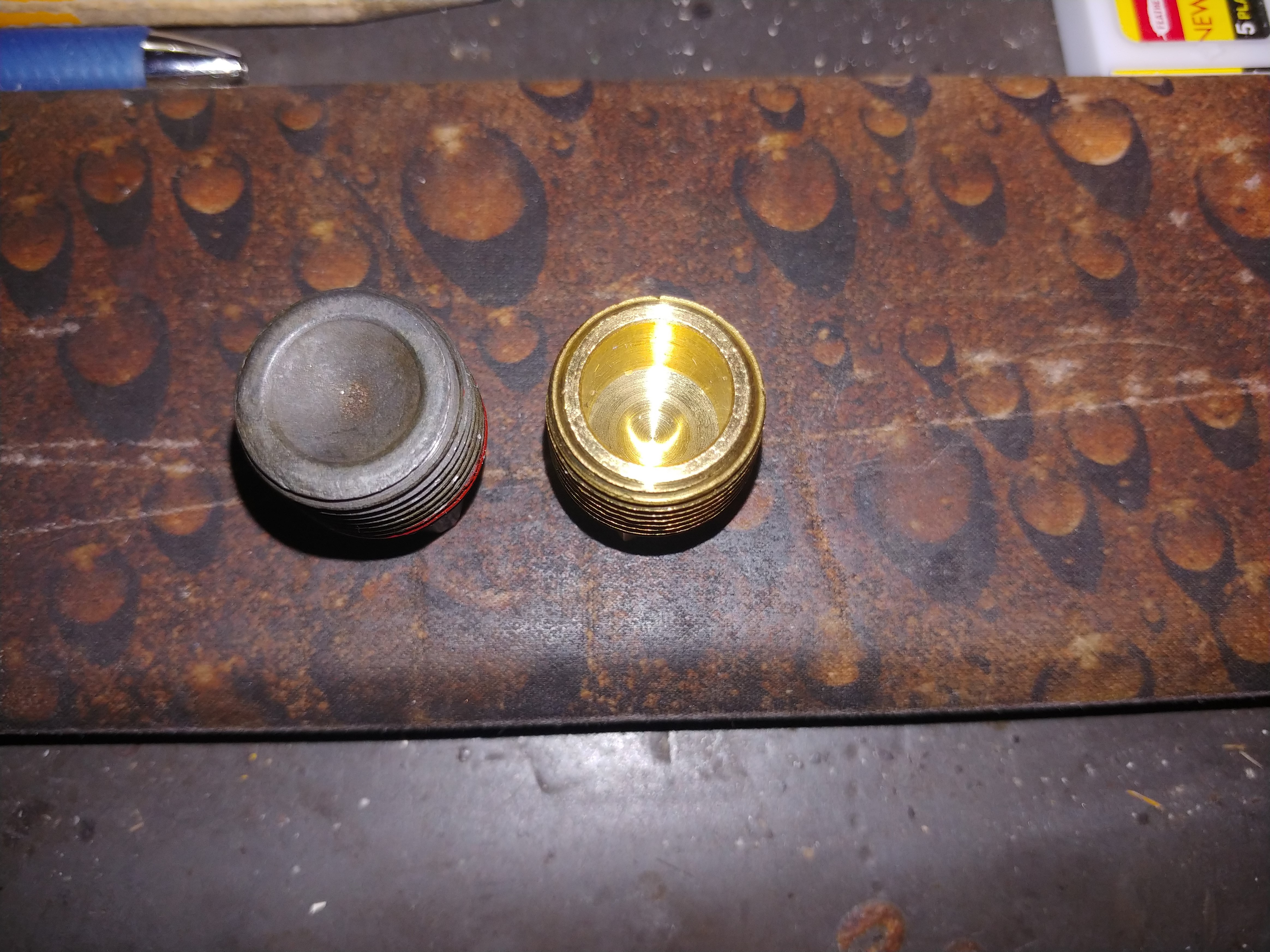

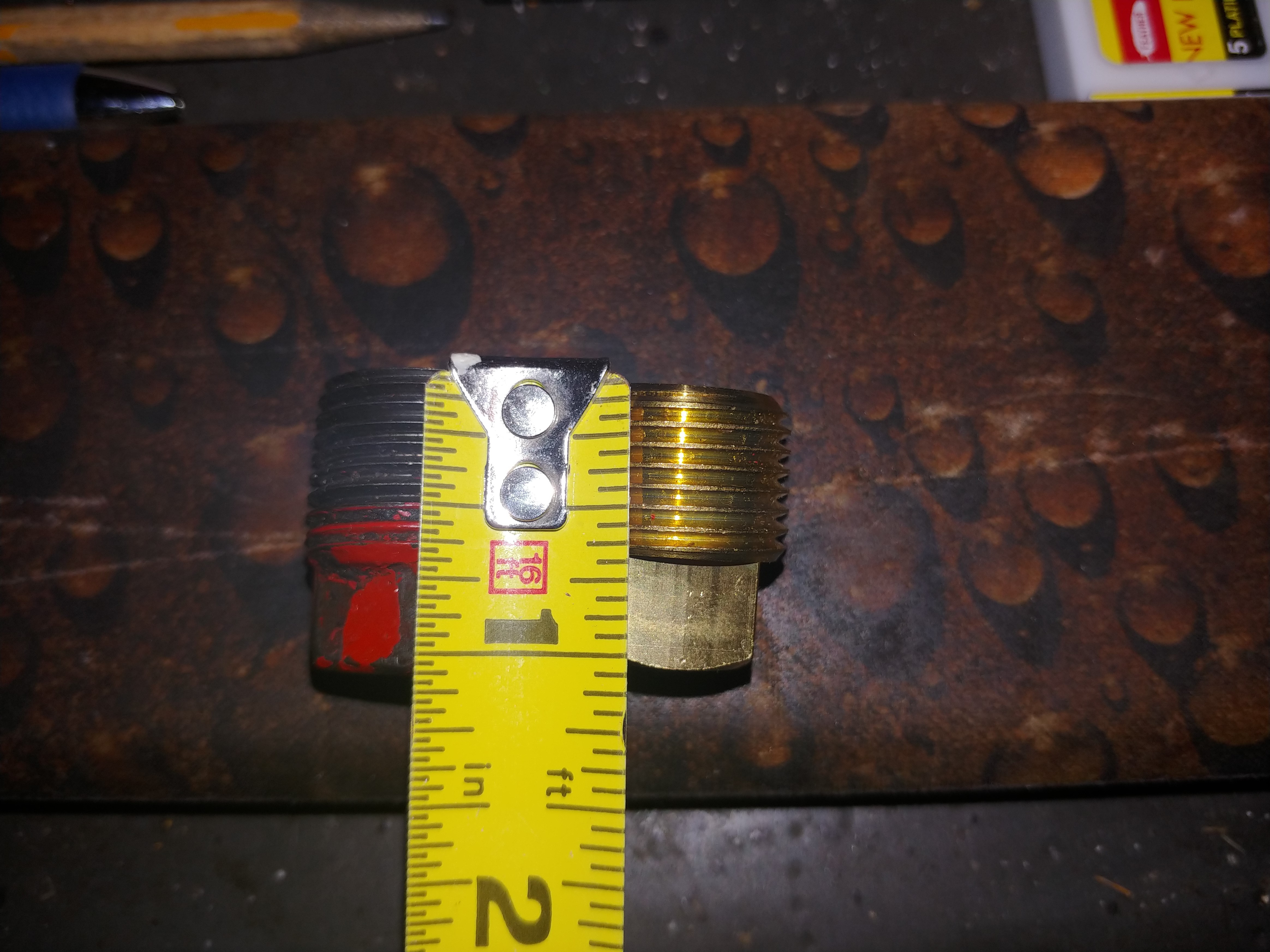

Due to previous attempts chewing up the surface I haven't been able to get a solid grip. Too much metal scraped around, and it tends to grip onto that and just scrape it off. Creating my own flat surface should help. The original plugs are solid, the brass replacements I bought from Napa are hollow.
Pics for reference.
Pics for reference.
View attachment 580000View attachment 579999View attachment 580001
I would definitely replace the present pipe plug with a brass one. They at least don't seize into the hole and they don't need to be as tight to stop leaks. That being said I would look for brass pipe plugs with a six sided head instead of the four cornered one pictured. Then you can just use a regular six sided socket to remove. A six sided head is also quite a bit larger than a four cornered one which makes a wrench less likely to slip and round the corners off.
Pics for reference.
The brass should not seize, especially with some teflon. Being hollow I guess you could hacksaw it off and use a big ez out next time its stuck.
