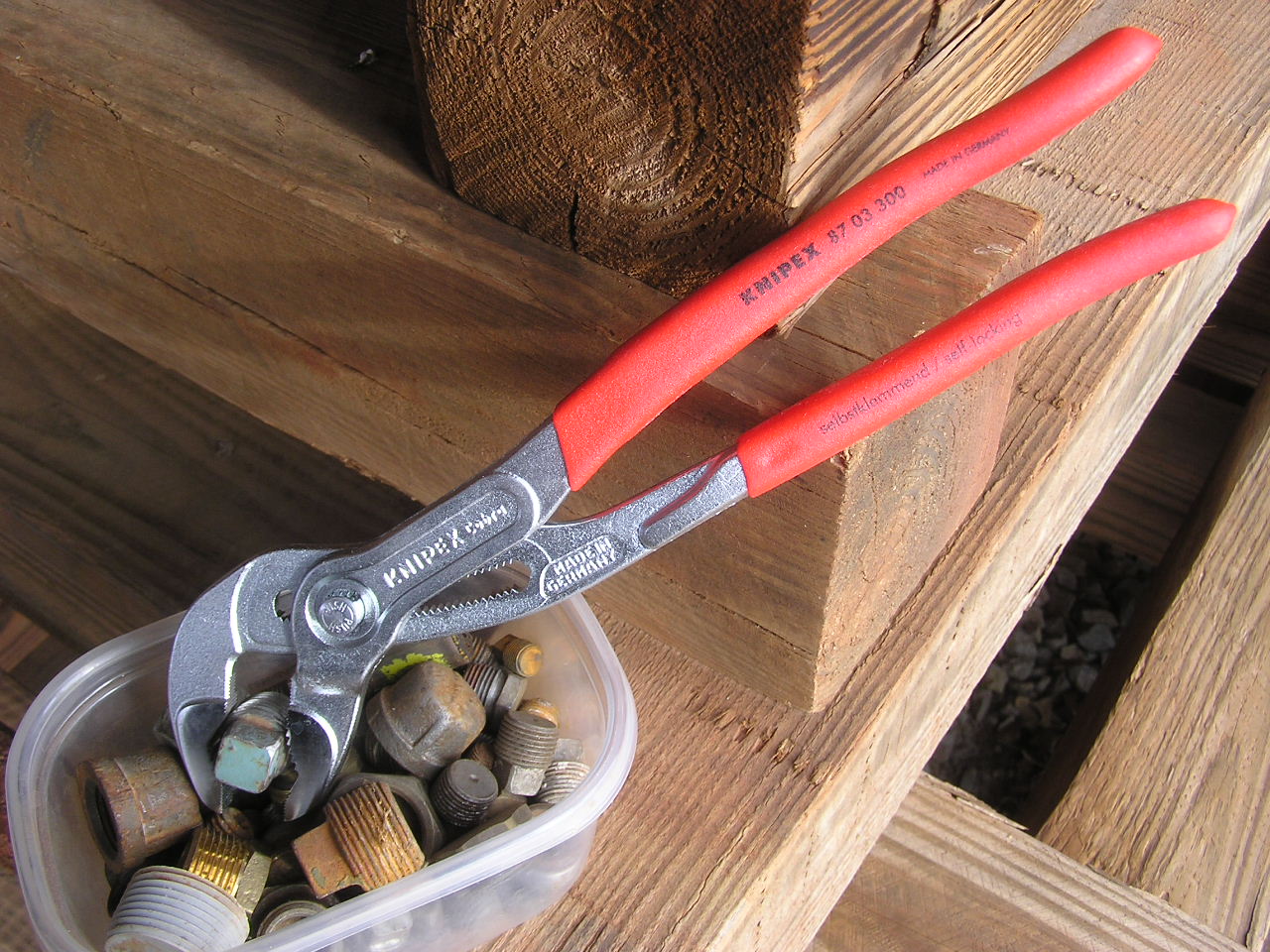

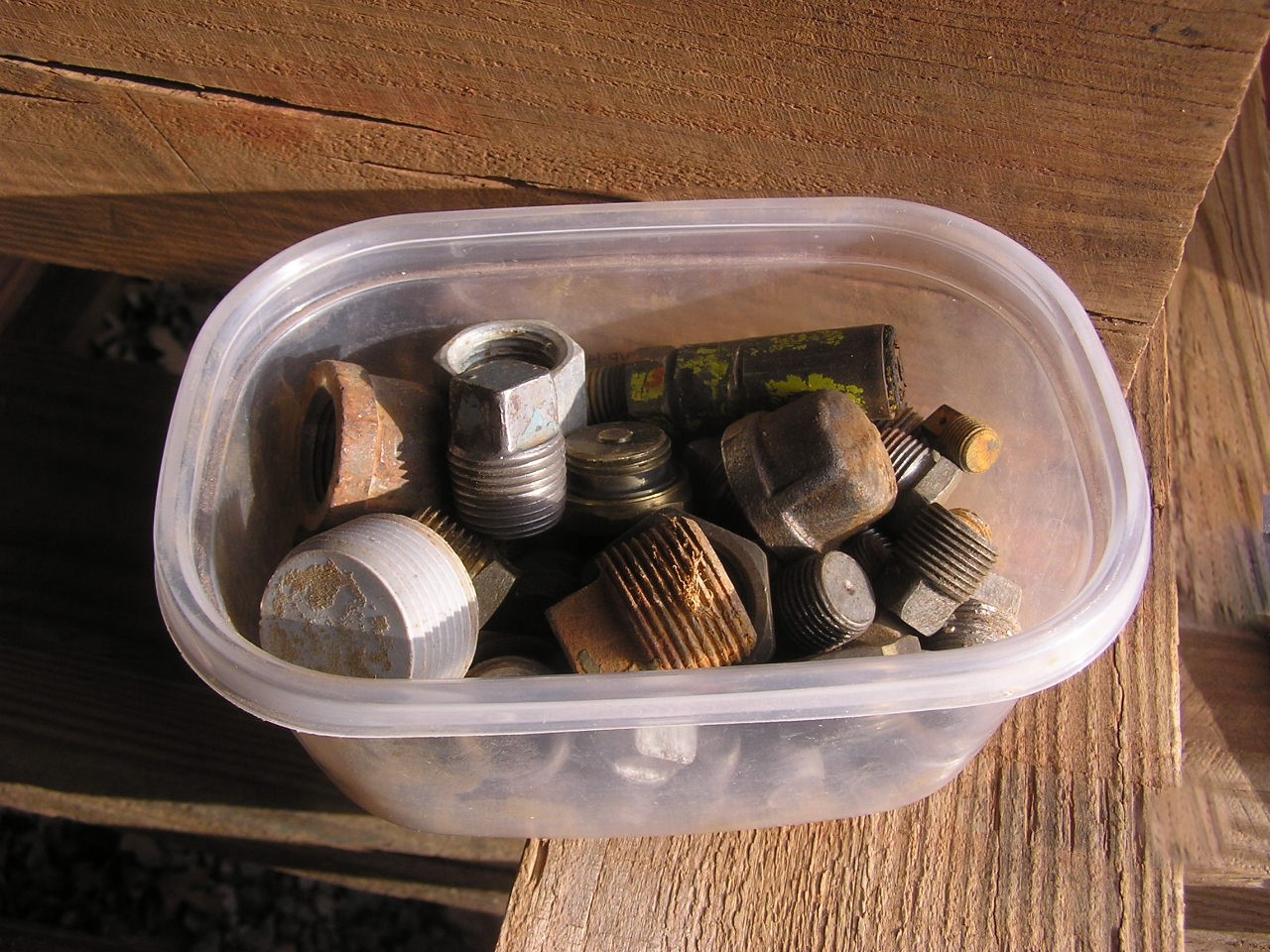

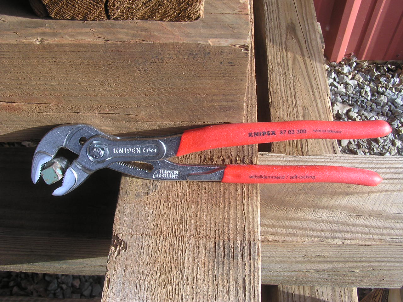

I got a pipe plug out.
My 12 inch Knipex Cobra pliers were delivered today, so I tried them on a pipe plug.
They reached right in, locked on the threads and got it out :thumbsup::
:D
