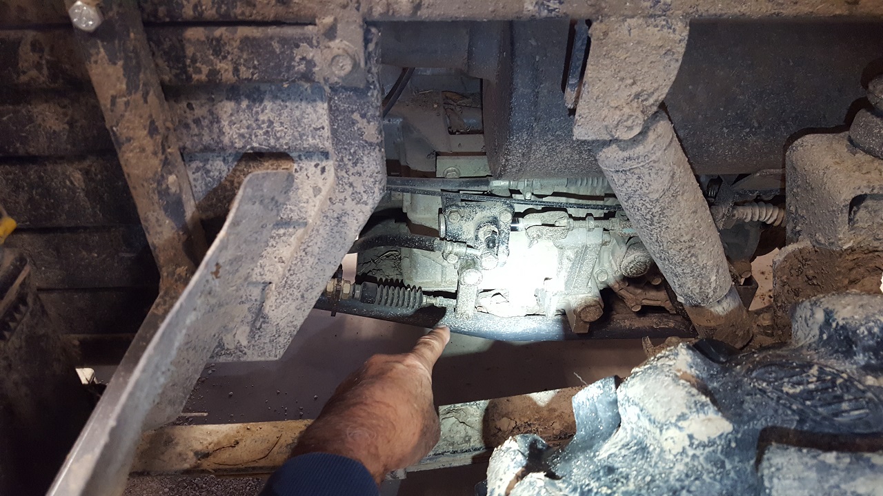

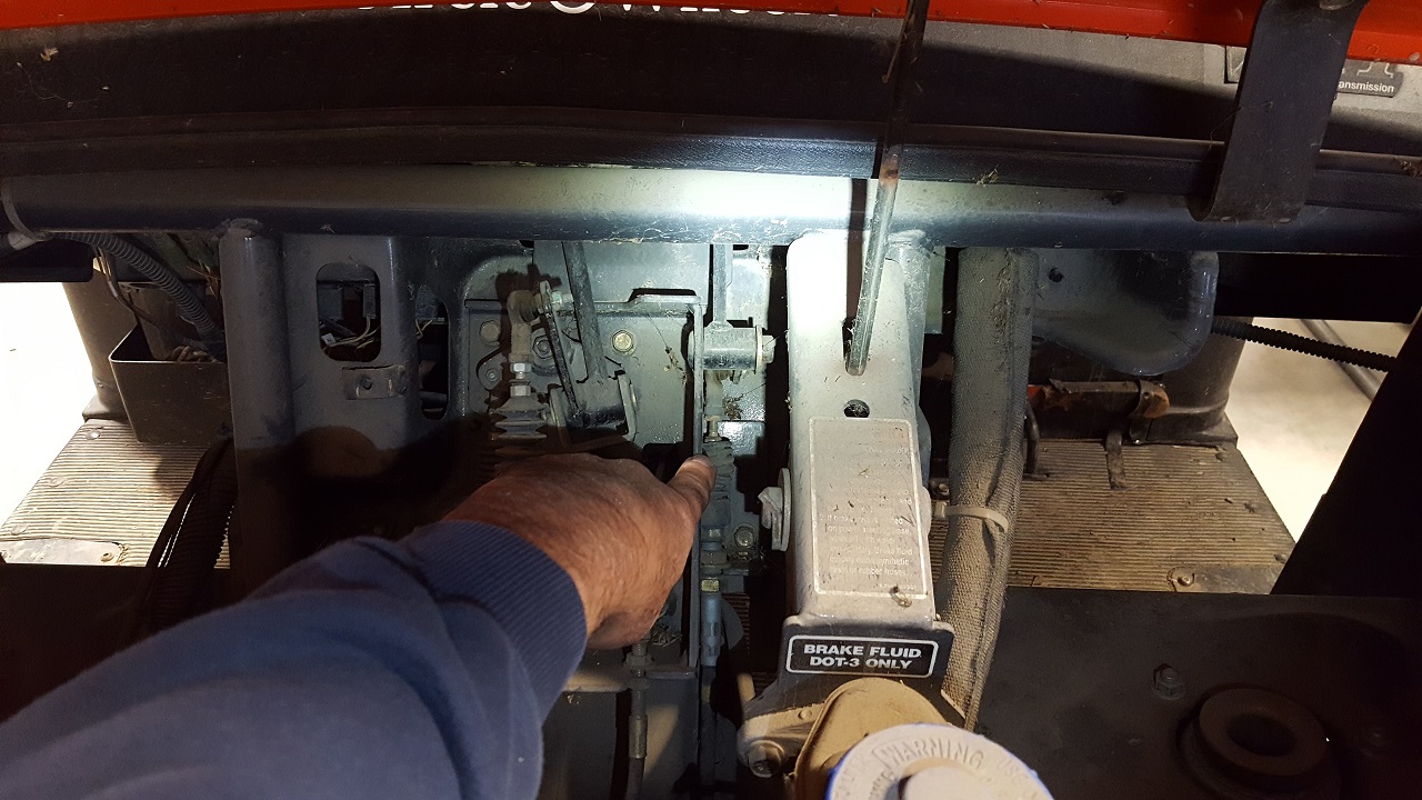

The 4wd system is not hydraulic. It's completely mechanical. Selection is made using a lever/cable system. The cable length is adjustable on both ends.
This first pic is taken standing in front of the machine, hood open. I'm pointing at the 4wd cable. You can clearly see the cable adjuster. Adjustment is made by the two nuts clamping the cable housing to the frame mount. Moving the cable housing toward or away from the cable end changes the effect.
This pic is taken with the bed raised, left side of machine, just in front of rear tire, looking inward. My finger is pointing at the 4wd lever/cable assembly on the side of the transaxle. Again you can clearly see the adjustable cable housing nuts.

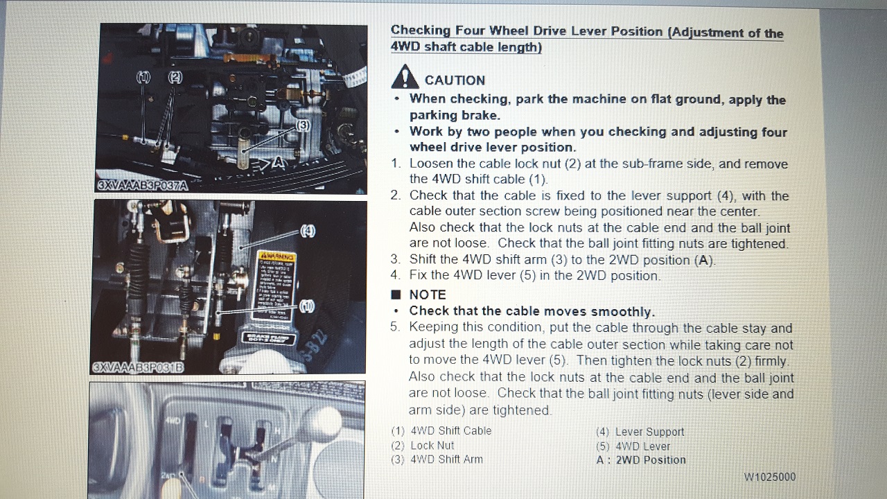

I've got a WSM for my machine. If needed I can illustrate the adjustment procedure.

See if I'm smart enough to attach the pic from my WSM that talks about adjusting the 4wd shifter......
Well that didn't work..... Let's try a pic taken of the WSM page with my phone.
Basically, it says to loosen the two cable housing nuts at the trans releasing the cable housing from the adjuster plate. Then, allowing the cable housing to move, make sure the trans lever is in the 2wd position and that the lever is in the 2wd position, then retighten the cable housing nuts.
The trans lever is rearward when in 2wd, forward when in 4wd. So, I'd loosen the adjuster nuts so the cable housing can move. Then push the lever rearward as far as it will go. Check to make sure the cab lever is still in 2wd. Retighten the housing nuts.
