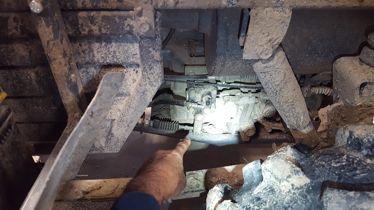

This first pic is taken standing in front of the machine, hood open. I'm pointing at the 4wd cable. You can clearly see the cable adjuster. Adjustment is made by the two nuts clamping the cable housing to the frame mount. Moving the cable housing toward or away from the cable end changes the effect.

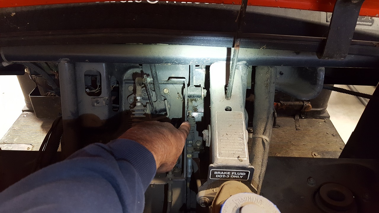

This pic is taken with the bed raised, left side of machine, just in front of rear tire, looking inward. My finger is pointing at the 4wd lever/cable assembly on the side of the transaxle. Again you can clearly see the adjustable cable housing nuts.

Come to think of it, I vaguely remember hoping on the machine after I'd thought I already had 4wd engaged, to find that it had disengaged. I am not home right now, but will be on the 12th, the cables are the first thing I will check. Thanks for the pictures, I doubt I would have looked for a second actuator after I found the first one had you not pointed them out.

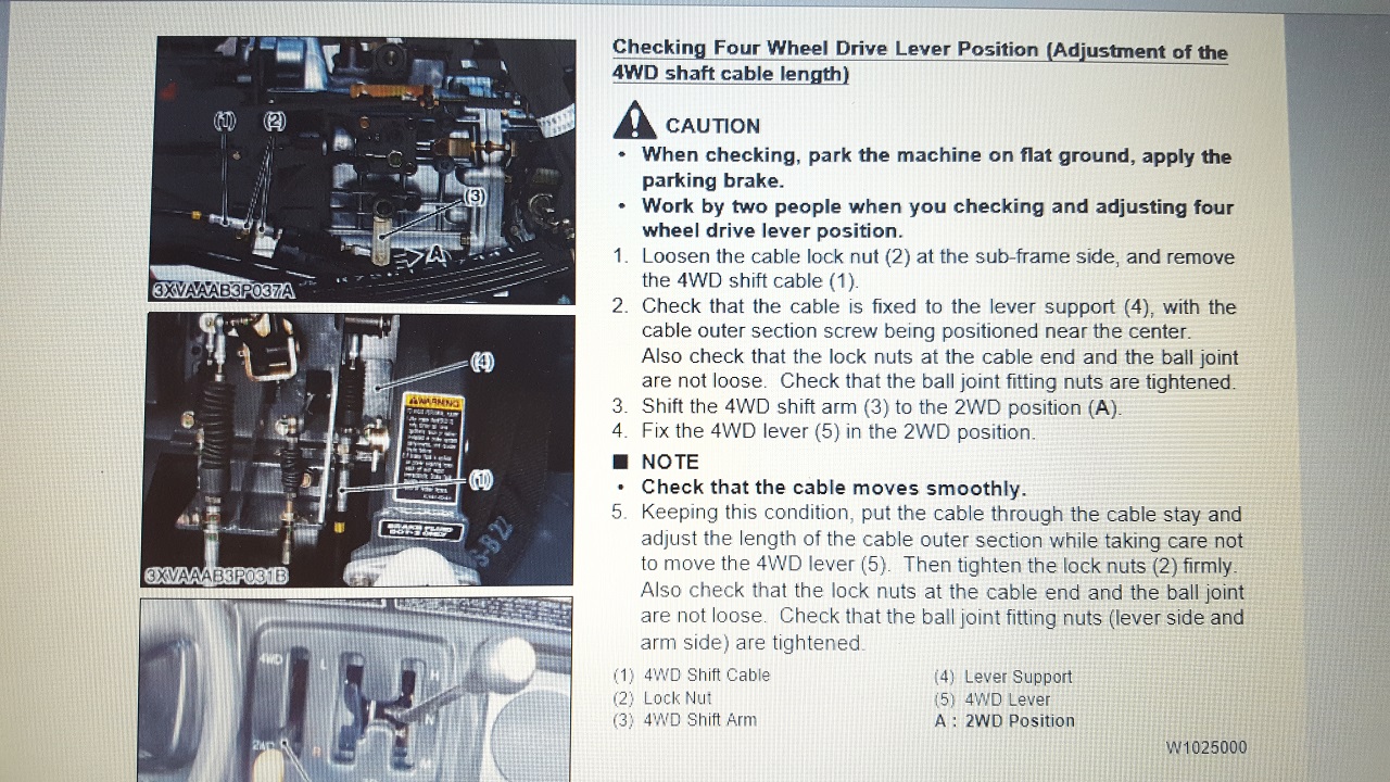

See if I'm smart enough to attach the pic from my WSM that talks about adjusting the 4wd shifter......
Well that didn't work..... Let's try a pic taken of the WSM page with my phone.
Basically, it says to loosen the two cable housing nuts at the trans releasing the cable housing from the adjuster plate. Then, allowing the cable housing to move, make sure the trans lever is in the 2wd position and that the lever is in the 2wd position, then retighten the cable housing nuts.
The trans lever is rearward when in 2wd, forward when in 4wd. So, I'd loosen the adjuster nuts so the cable housing can move. Then push the lever rearward as far as it will go. Check to make sure the cab lever is still in 2wd. Retighten the housing nuts.

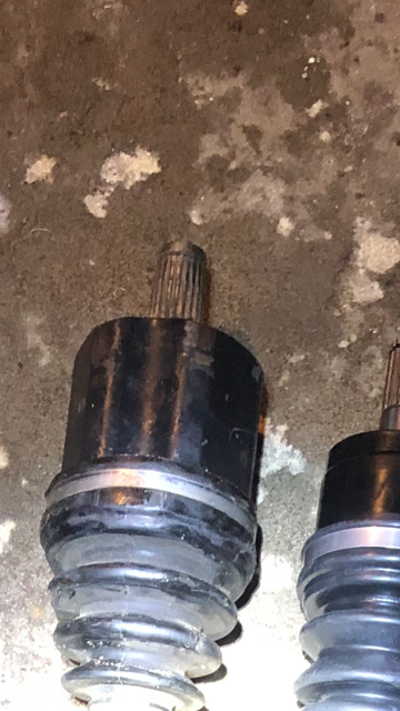

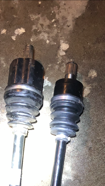

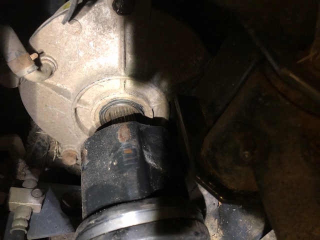

Hey Richard, thanks for the help. Unfortunately, when I started looking around the machine I found the front right cv axle was loose. There are no rips or tears in the boot, but after pulling it, I noticed the splines were stripped. Grease is leaking from the end of the boot, but otherwise I am not sure what would cause the splines to strip on the axle itself.
I ordered two axles from sixity, and although the box says Kubota, they are not the correct axle. I called sixity this morning, they said they had a shipment of axles come in that were kawasaki axles in Kubota boxes. They shipped out new axles today, and they will be here Saturday.

Can you post a pic of your stripped axle?? I've never saw that before. Worries me. Especially if you are talking about the end that goes into the front diff....
