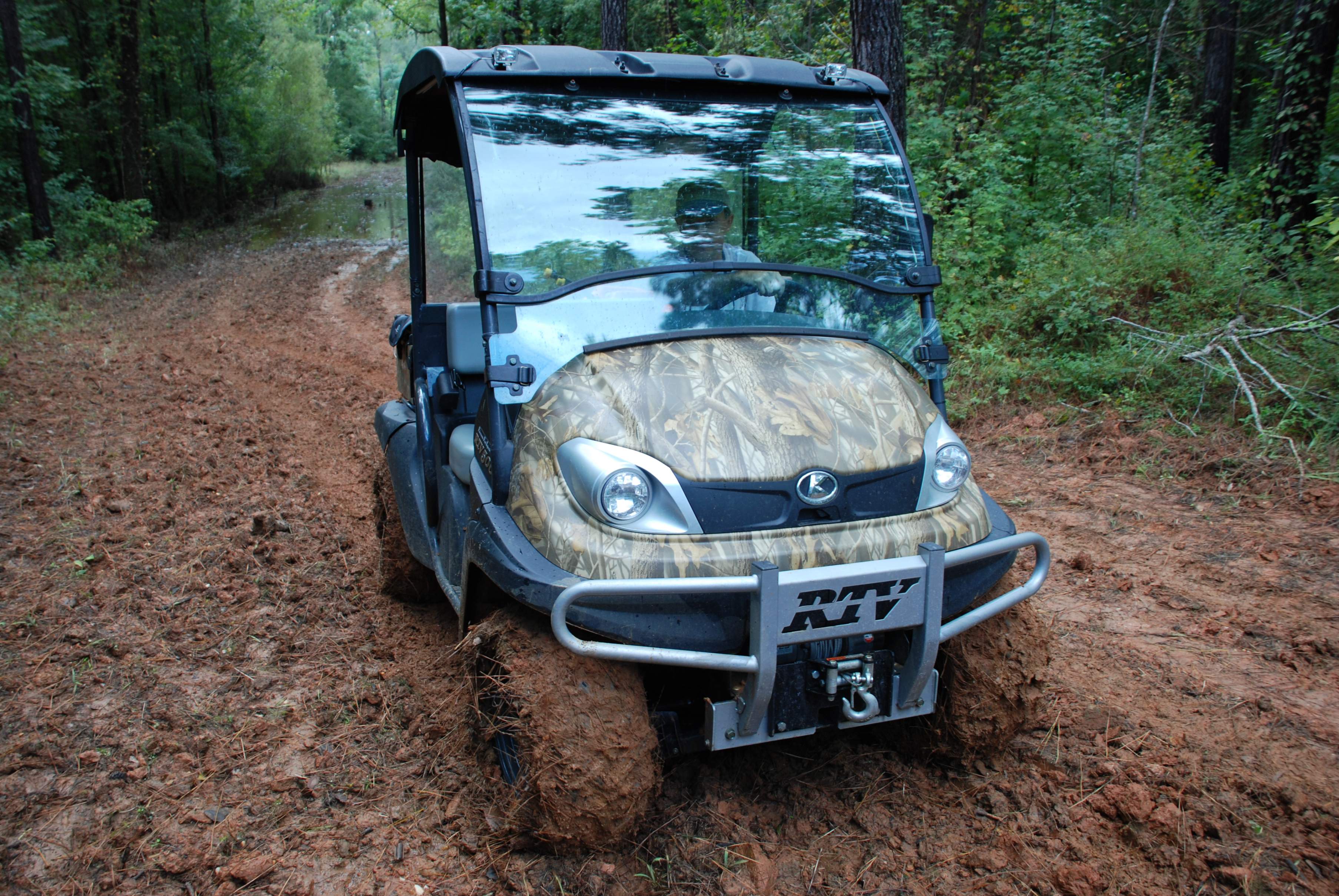

So how is your rattle today????????

   / RTV 500 Rattle Sound #156
Not quite as noticable after I did the 50HR service, could just be my imagination though.

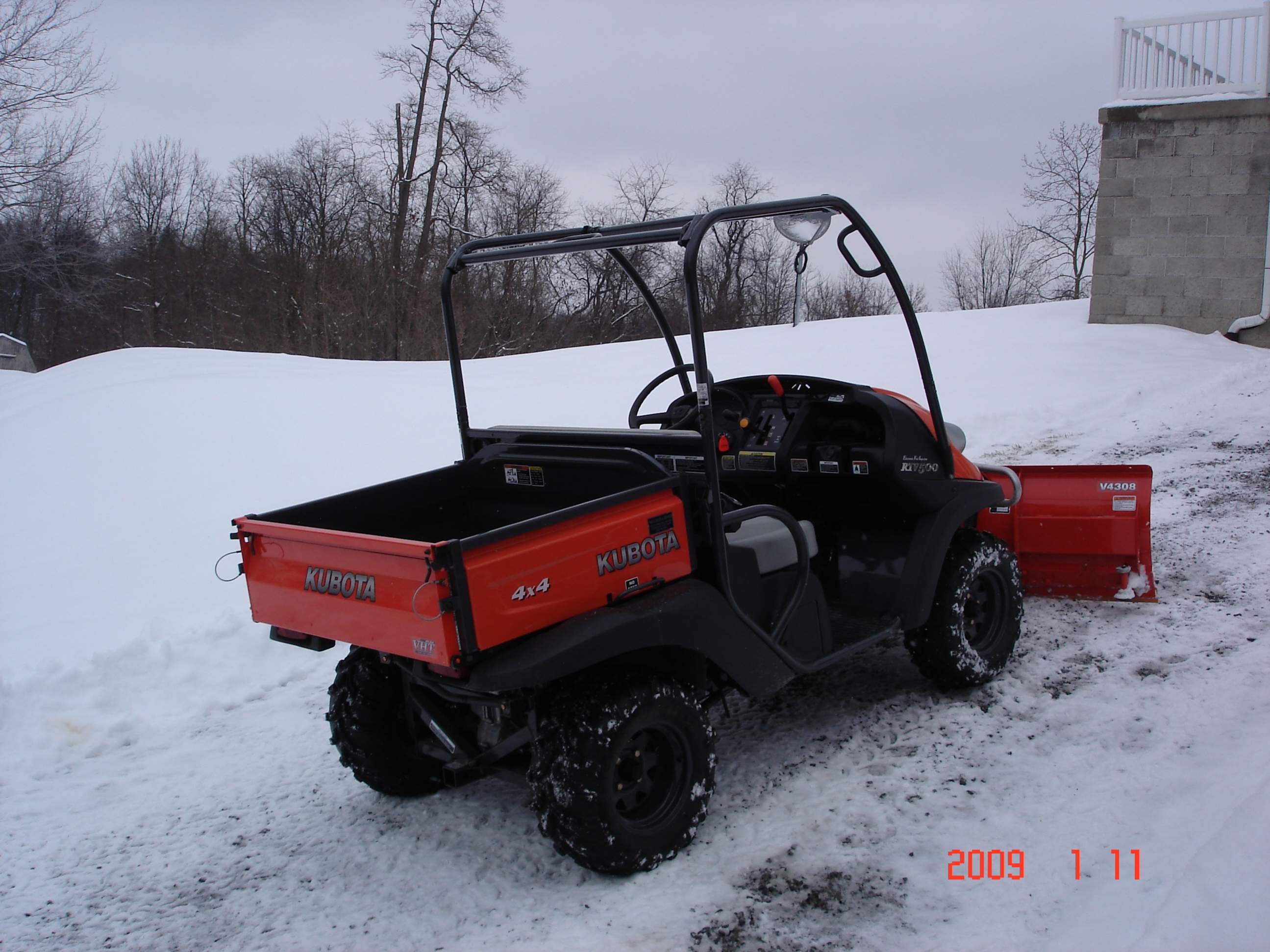

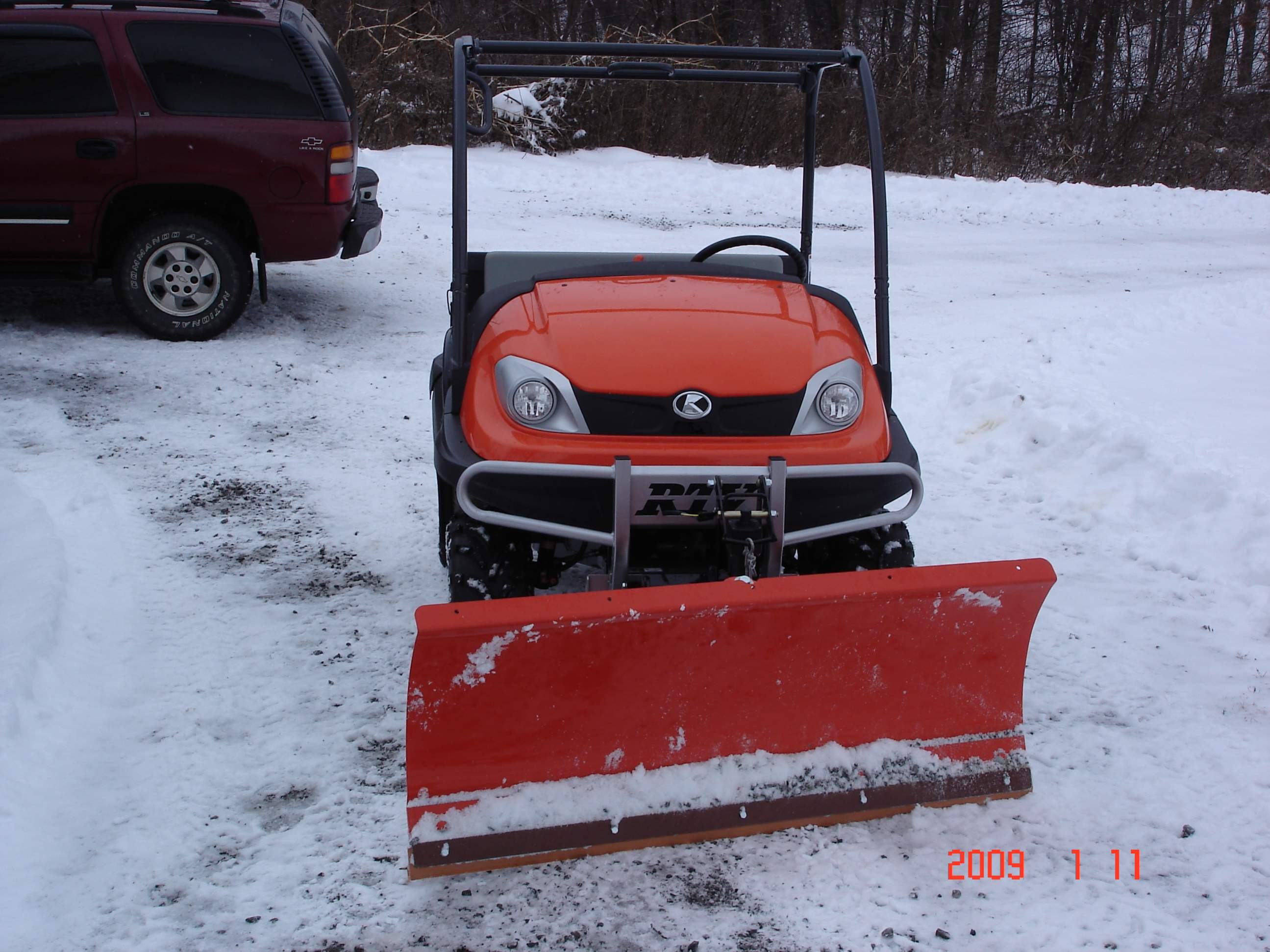

Thanks for the response. I get the same treatment from my quad neighbors...It does need more power. 25MPH is fast enough for me...General power would be much appreciated.
I have the Kubota roof and windshield with a aftermarket poly rear window. It definitly helps keep the chill off. I looked at the one-piece slip over cabs, but I'm not a big fan of the vinyl windows.
I have been kinda looking at heaters, but I'm not sure if the charging system would be thrilled with that or not, and I really didn't want to install a perminant coolant driven heater.
As far as the plow, if you put a piece of rubber on the bottom of the blade and take some of the weight off of it with the actuator, you can plow gravel, you just need to really watch or you'll be moving stone everywhere.
Here's what my set up looks like: Zoom in on the bottom of the plow.
