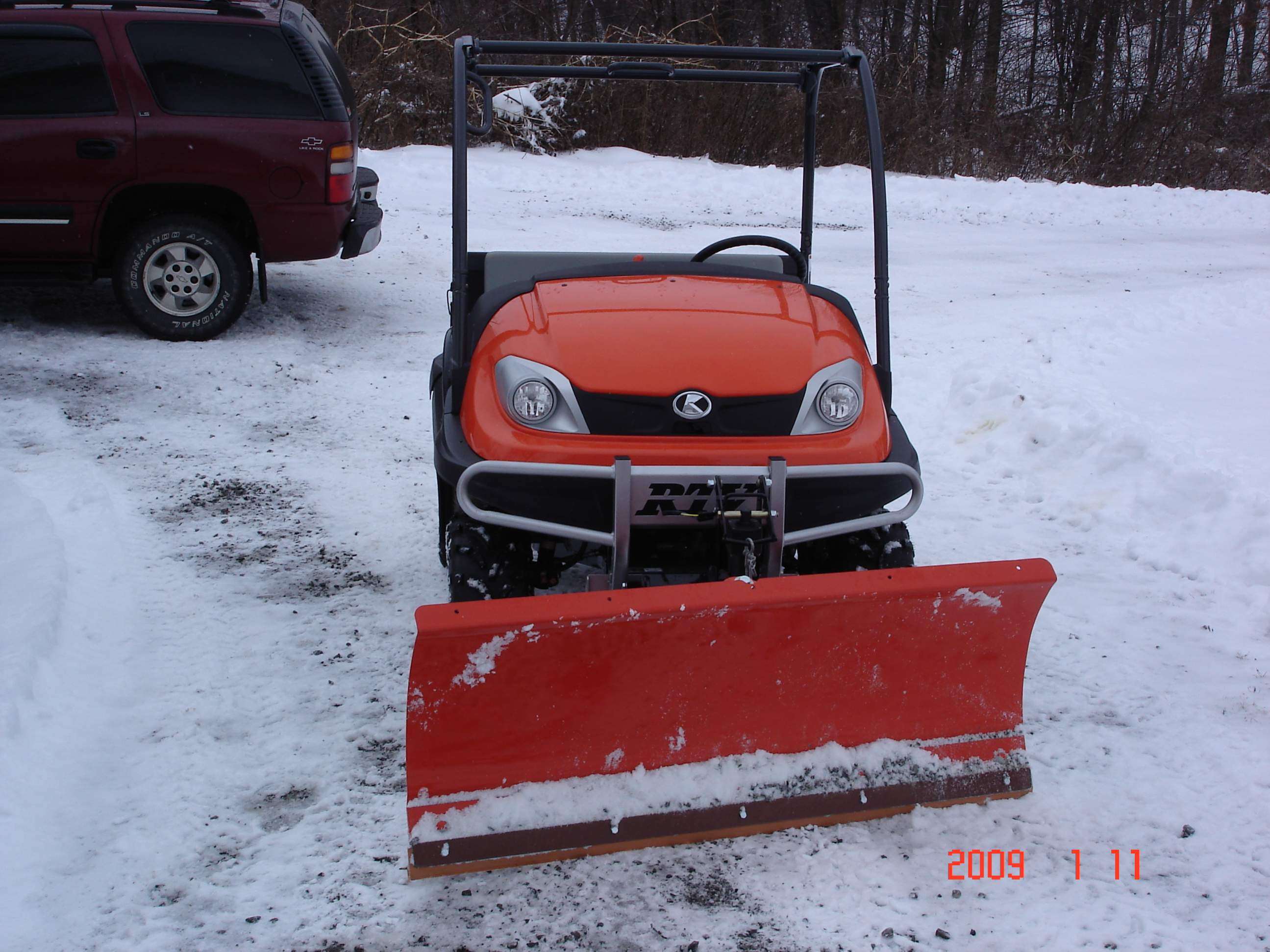

Am in process of buying an rtv-500. This rattle that is being discussed worries me. The other issue is that I was considering a snowplow, the description of it being an 'engineering blunder' causes me concern. Any further comments on the snowplow issue?
There are some design issues with the plow theat Kubota is lookinng into.
Main problem is weight and the skid shoes don't hit the ground, so you cutting bar is not lifted from the surface. Also check the actuator chain bolts and locktite and crank them down..The rotation of the lift can work them loose. Mine came off twice...Seems ok now.
That being said, if you are plowing asphalt or concrete, it will be perfect. It does move alot of snow quickly due to it's size. This is good on solid surfaces, not so much on gravel.
I put acrylic across the bottom of the cutting bar to prevent digging. This does help quite abit...See pictures of the orange RTV previously posted on this thread.
Since you will probably be pushing snow at 1/2 throttle or so, it has plenty of power, this appears to be the machine's sweet spot. If you floor it, it strarts to bog down. Silly, I know, but that's the way it is.
Thanks for the reply. My plowing will be on asphalt and gravel. I am going to wait until next fall and then will explore plow. Maybe Kubota will have worked something out by then ???
   / RTV 500 Rattle Sound #55
I'll keep you posted on that. Once the gravel is frozen solid, it's ok, still heavy, but ok. The urethane on the bottom is a must either way. I think the urethane is used in cities to prevent manhole covers from being ripped off.

It climbs hills well in low. I've plowed snow uphill...boggs a little, but keeps going. If it can do that, I'm sure you'll be fine.
