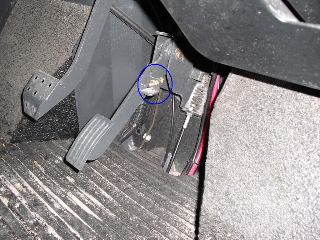

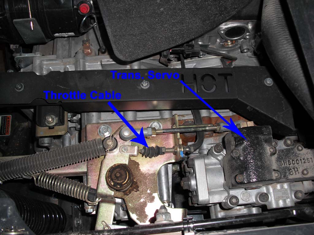

The RTV500 definitely is a little wimpy. The hydro trans, though more durable, is not as efficient as the CVT and that may part of the problem. There have been a lot of complaints about the engine bogging when going up hills. Mine does not do that. The vehicle slows as the transmission lowers the ratio and you can hear the engine working harder, but the engine does not bog down. In looking at the setup of the throttle peddle cable and linkage, it seems to me that proper adjustment is critical for correct performance. The peddle controls both the throttle cable to the engine governor and a linkage to the transmission main servo valve. There is bolt under the throttle peddle that is a stop for the peddle (see attached picture). The stop limits how far the transmission servo valve is moved and, thus, I suspect will limit the maximum speed. But you do not just want to change the stop to let the peddle go down farther to get more speed. What is important is that when the peddle hits the stop, the throttle cable should also be pulling the governor all the way to the stop at the same time. See the attached picture. Have someone step on the peddle while you watch the throttle cable under the bed. You can push on the cable under the rubber boot to tell whether there is any travel left in the engine governor. As the peddle gets to the stop, the throttle cable under the bed should go taunt. I have not tried this, but someone who drives on a lot of hills, may be able to sacrifice a little top speed to get more speed on the hills by adjusting the peddle stop so that the peddle cannot go down as far and then readjusting the throttle cable so that governor bottoms out when the peddle hits the stop.
