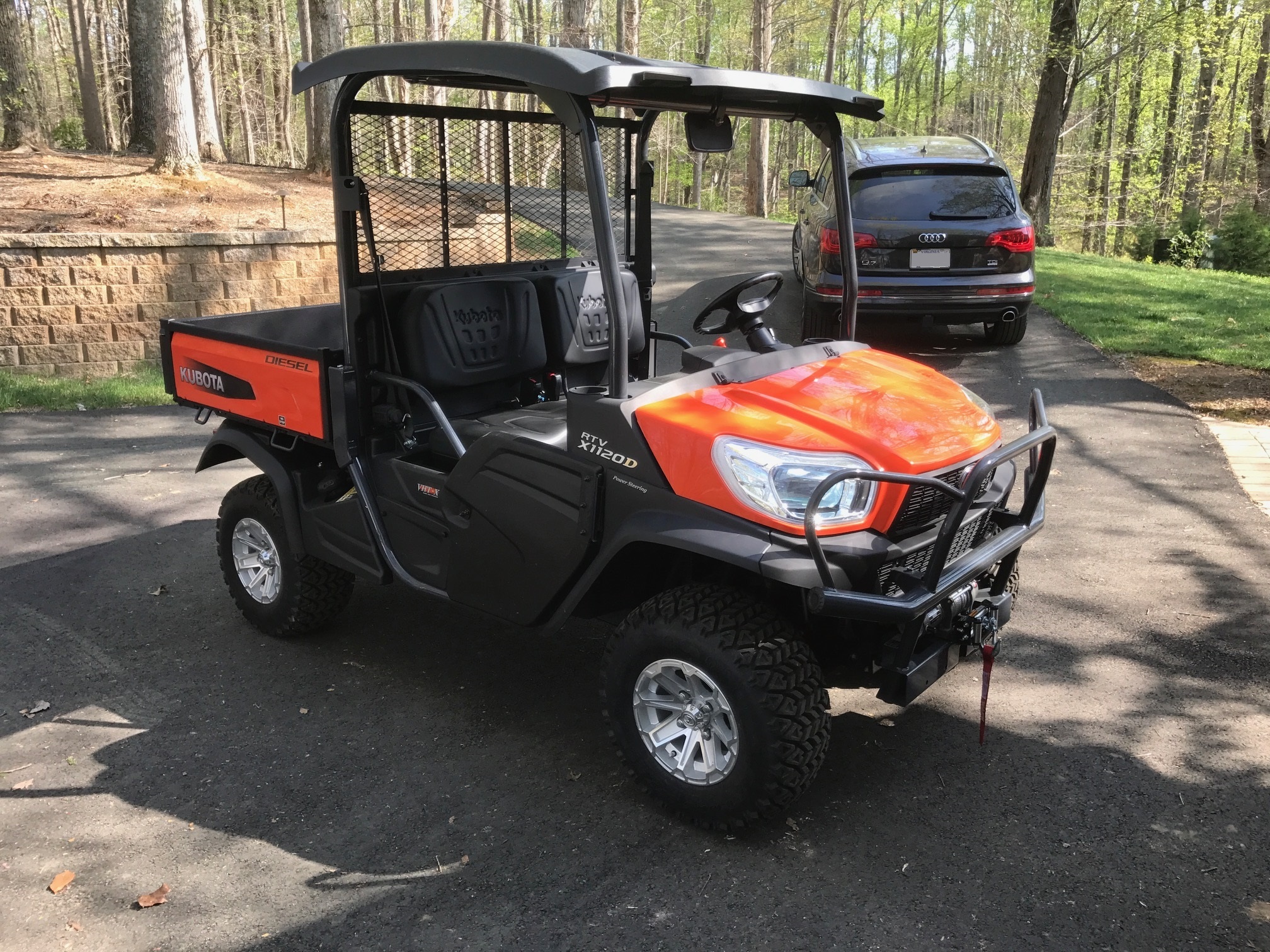

Thanks for all the info guys. I finally decided on a new RTVX1120d - going on Friday morning to finalize the deal and hopefully will be delivered Friday afternoon. I spoke with the mechanic at the dealer - he said that he's seen more issues with the gas models on short trips - probably because of gumming in the fuel. Kubota's response has been that they aren't being run long enough - he had seen no issues w/ the diesels.
Looking forward to many years of trouble free service from the RTV - my 1992 Kubota walk-behind mower still looks and runs like new...built like a tank.

Congrats on the new machine!!! Post pics when you get it home.
   / RTV 500 vs RTV 900 #27
It was delivered today - nice machine!
Thanks everyone for your input!
