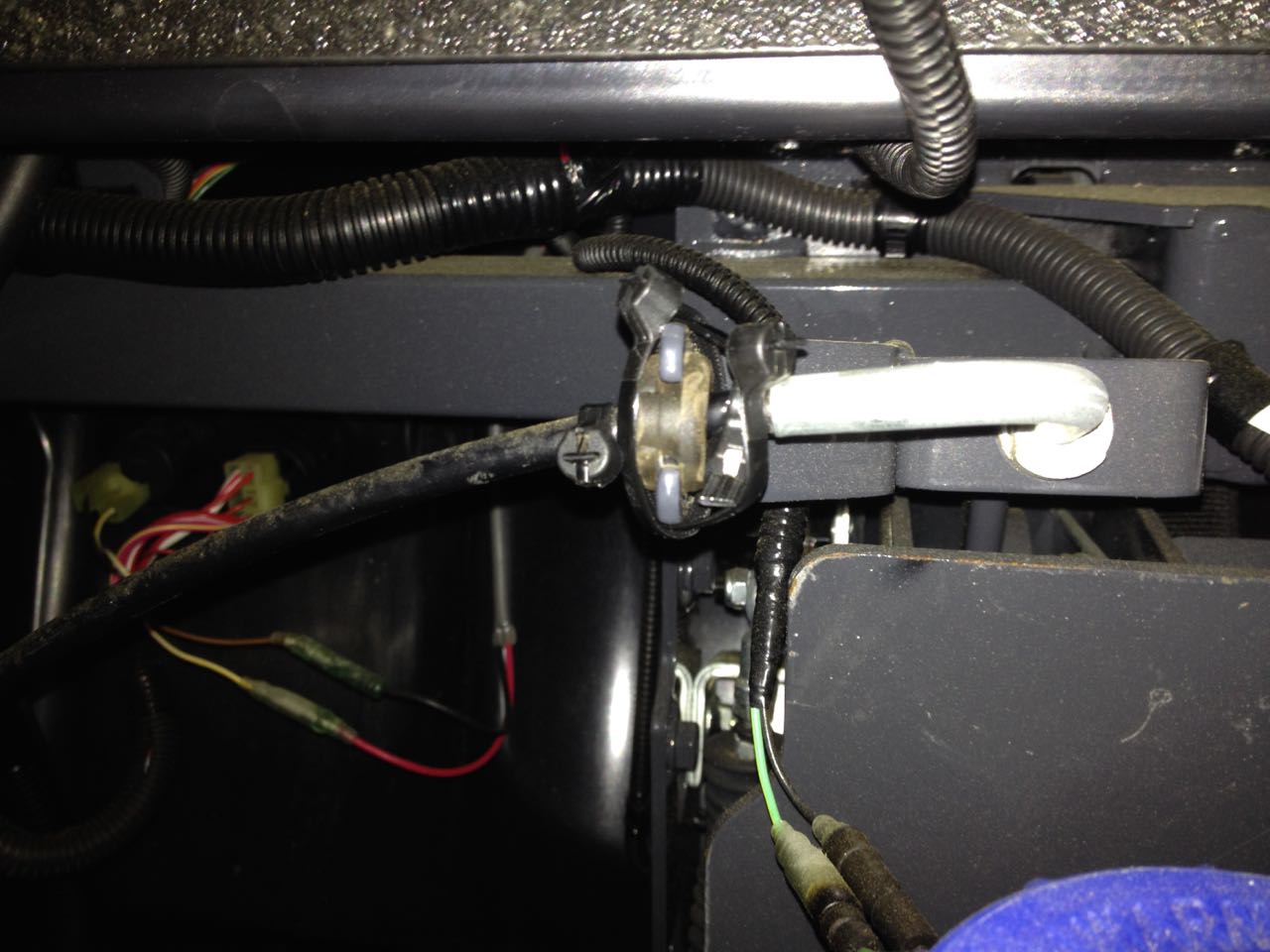

Apparently there's a TSB out for this, but I haven't actually seen it. I did come across pics on another forum where someone has supposedly done what the bulletin calls for, which is some Zip-tie engineering.
It seems that the cable that links the brake to the relief valve is held in place by just a grommet. It does seem to wiggle a bit, and I could see how it could become mis-aligned with the rest of the bracket. Supposedly the official fix is to zip-tie it in place, and since I had some zip-ties handy, I figured I'd give it a shot.
I took the RTV-900 for a quick test drive and **** if it didn't seem to shift better! I'll see how it does over time, but my perception is that it was much better.
