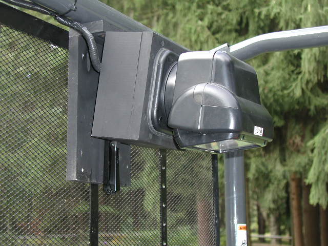

About a month ago, I was going mount a "Go Light" to the RTV. Due to some rotator cuff surgery, it took a little longer than I wanted.
Anyhow, I came up with a system to mount the light on the RTV. The initial mounting consisted of fasting the Go Light to a box that I made out of wood (poplar). I then mounted the box to hinges that connected to another piece of poplar mounted on the rear guard behind the seat. The whole assembly would fold down when not in use to clear my garage door frame.
When placed in the up position, it was held in place by a Drop-Leaf Table Brace.
First photo

Nicely done!
Any problems with the brace jarring loose when bouncing around?

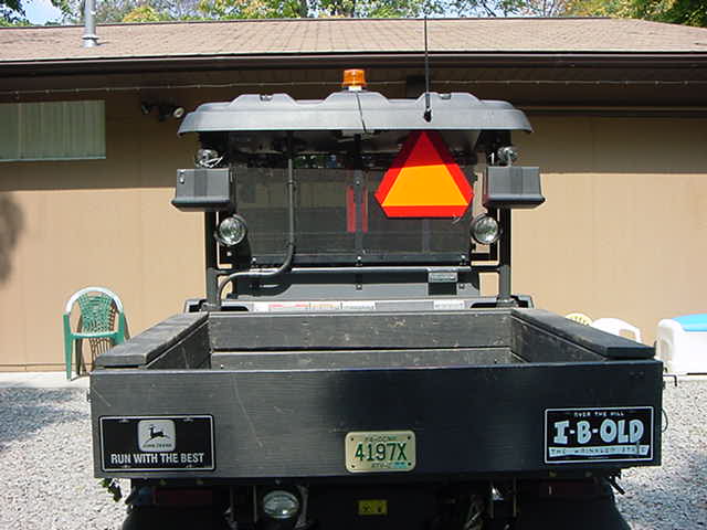

I have a roof on mine. I screwed a piece of stainless steel to the top flat portion and use magnetic mount lights. (pic attached with strobe mounted). Since I put the lift kit on, I don't think I can fit under a standard garage door anymore (heads up if you're considering the same lift kit) but I would just remove the light and (using the magnet), stick the light to the back of the rear cage.
Brian
