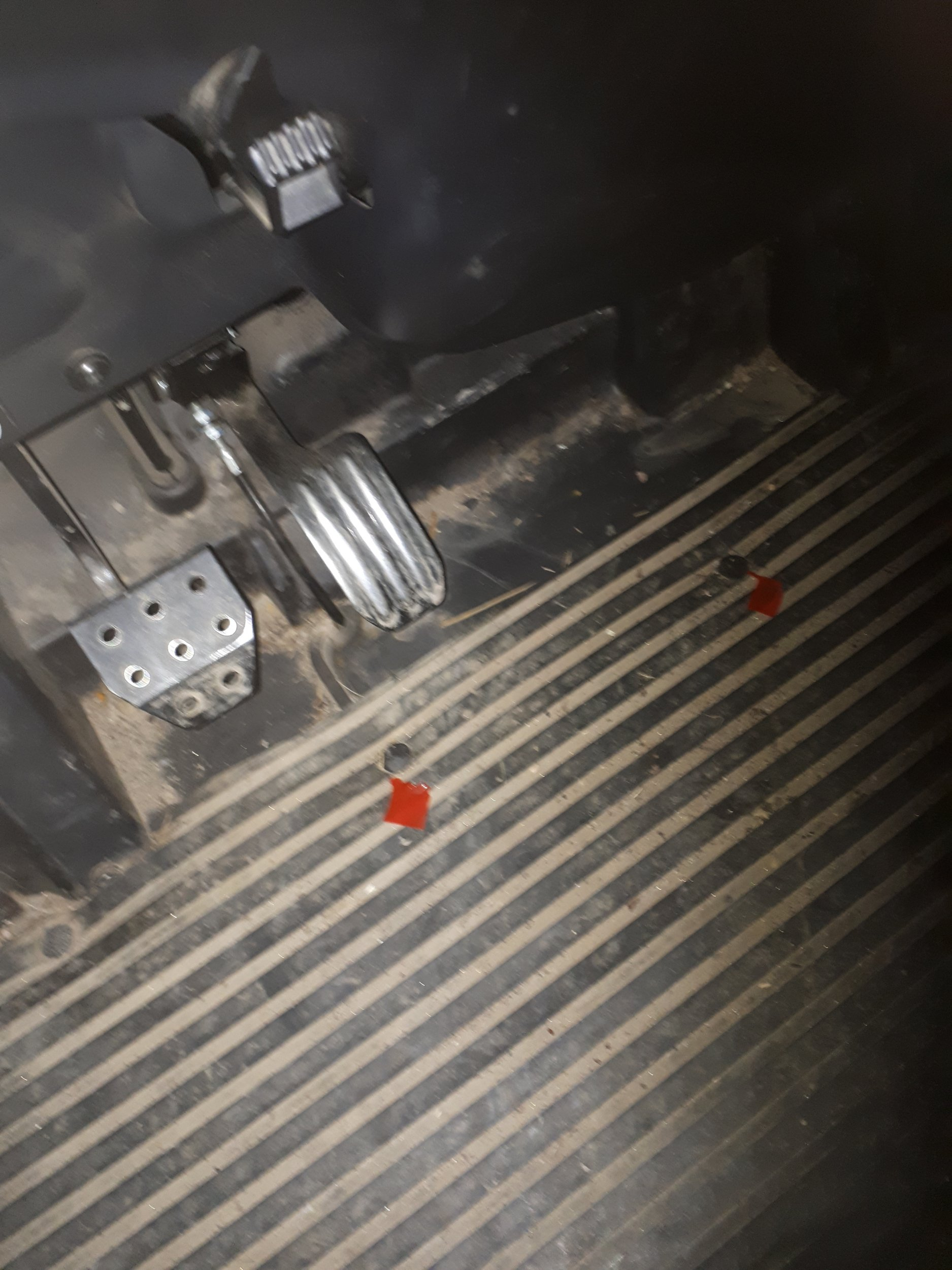

NS Tractor came and did my RTV floor mat recall in April. They drove the 5 km here and did it in my garage. Took 15 minutes, the young fella used a exacto knife and I held the straight edge and he cut a roughly 2 inch by 20 inch strip so gas pedal can never catch on edge of carpet. He then drilled 2 new holes thru floor (using template for where safe to drill ) And then installed 2 new plastic friction rivets to hold remaining carpet down.....so I was suprised with a painless 15 minutes !

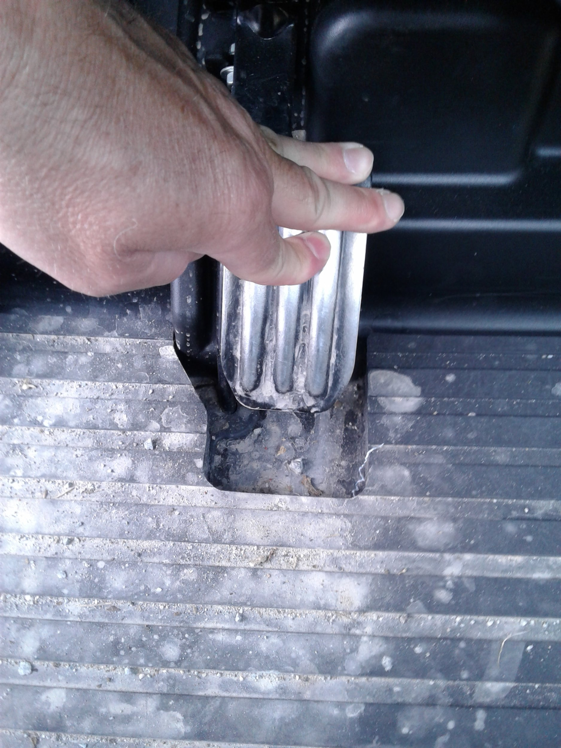

As for the floor mat recall, I can't see how the mat could ever get bad enough to catch the pedals in the first place??
Seems like I have lots of room and this is how mine came from factory.

Yes I agree, and it is an added area now for boot sand gravel to sit , but it was free and easy because I am located so close to dealer, the pic shows with the 2 pcs of red tape where they put new plastic rivets to hold down mat. AND to stay on topic I also included pic of my old CTC bicycle 3 " mirror I attached thru hinge , it is a little small and vibrates a bit, but I just need it to show me if a car is trying to pass me on local roads, and needed small because my sugar bush and summer atv trails are narrow and many tree branches can hit mirror even now :)20220523_090655.jpg20220523_090915.jpg
