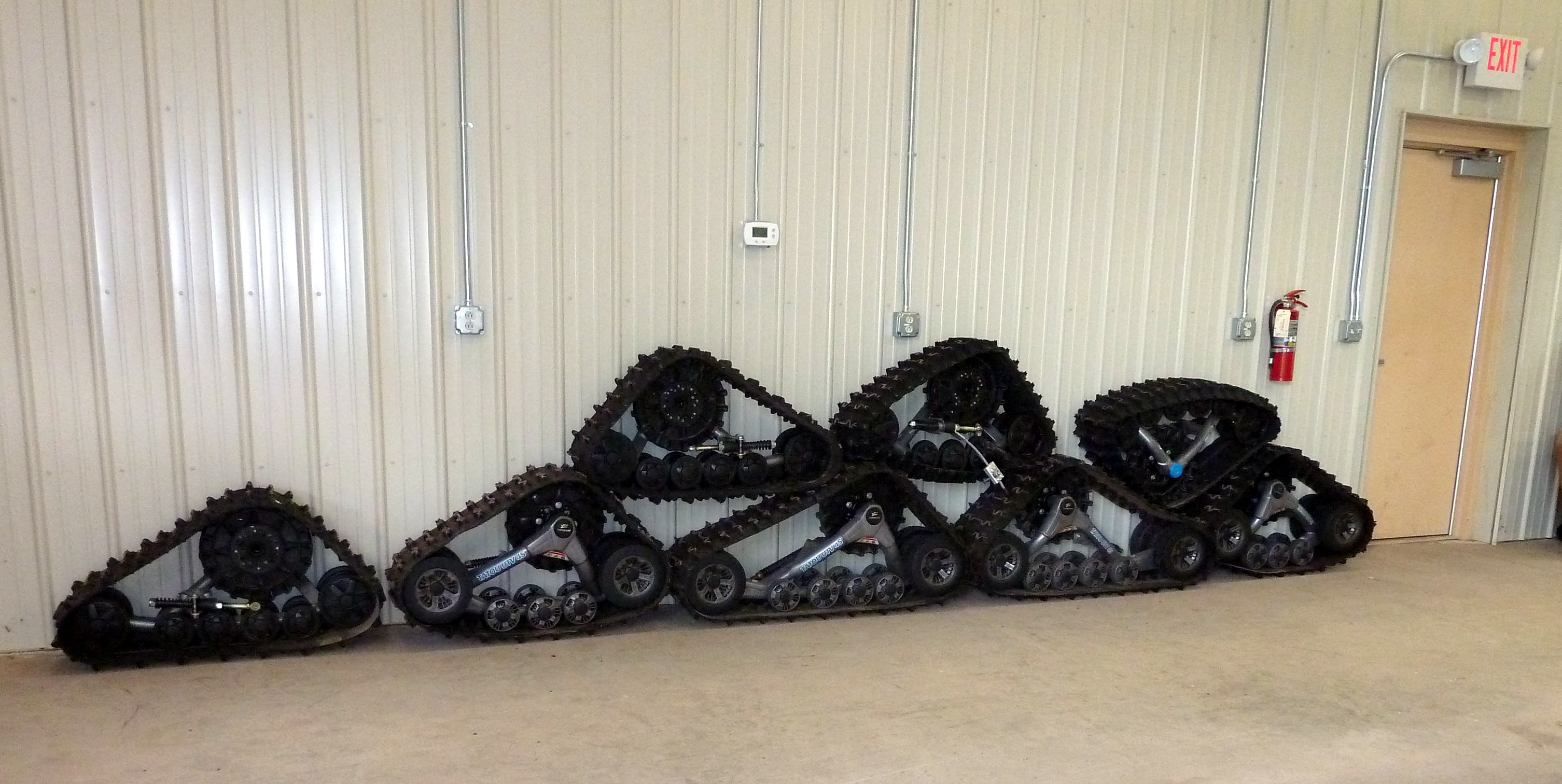

I have a set for our Gator. They're a lot of fun but very slow. The drive sprocket is about 12-14" diameter wich is your final drive ratio. Think of it as driving on your wheels with no tires.
If you don't care about flying around with the engine screaming and maybe have more of a "hot rod" machine that's one thing. The Kubota and my Gator are more utility types.
In certain snow conditions anything with tires can get hung up in only 6-8" and the tracks don't care.
We have over a square mile of land with various "grades" of logging trails and roads that are actually more accessible in the winter with the tracks because of the increased ground clearance of about 18".
I have them ready to go, the snow really hasn't set in yet this year.

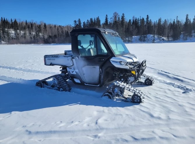

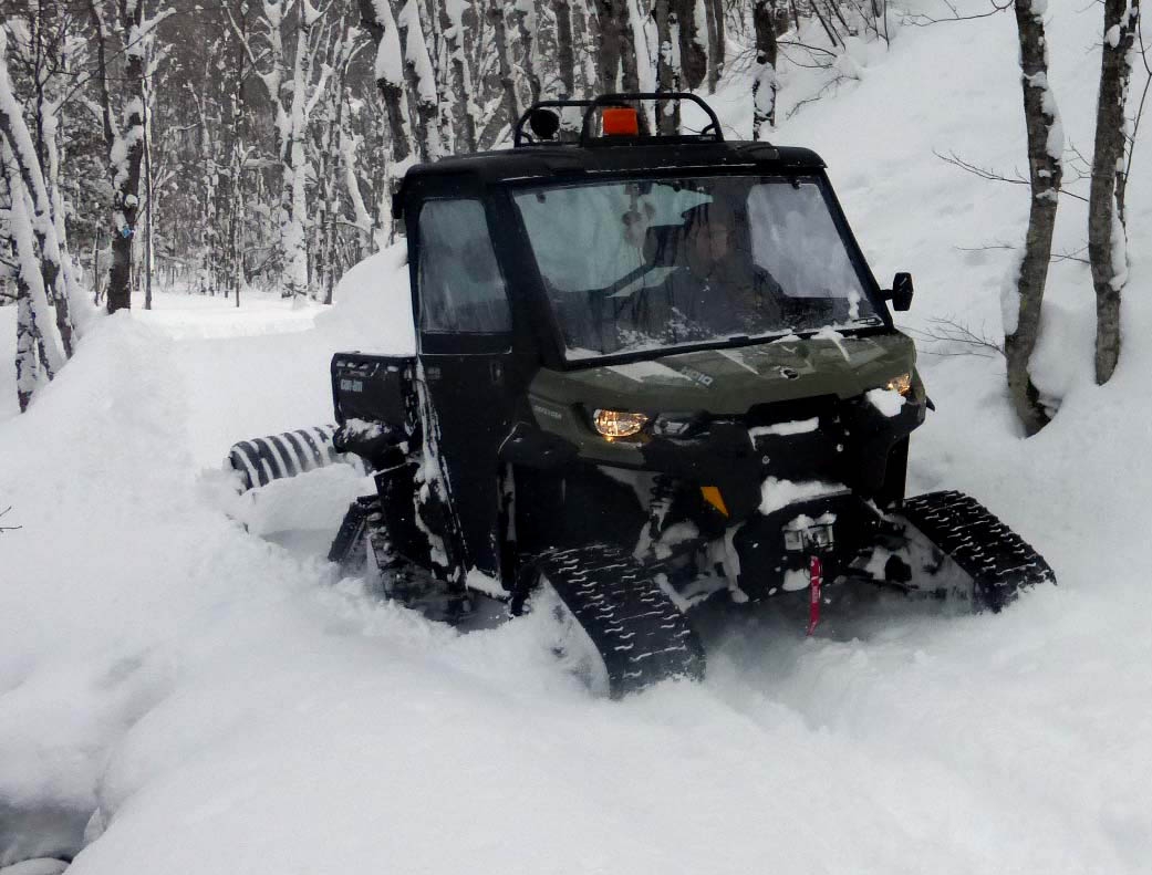

Can-am (Canadian company) offers tracks straight from the factory for their machines for those who live in snow country. Go where no vehicle on wheels can go.
