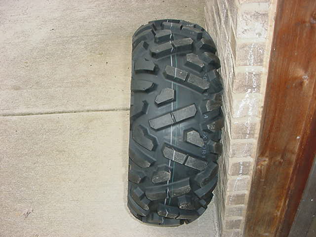

Many of us have bought a set of aftermarket tires (and some of us got rims as well). I got the rims as well thinking I would have a summer set (OEM HDWS tires/rims) and a winter set (aftermarket tires/rims). I got the Maxxis Bighorns and they seem to be one of the favorites for mixed terrain (everything from grass, mud, loose gravel, pavement...). So far, I won't be changing back to the OEM as the Bighorns are great regardless of the terrain. I've attached a pic so you can get an idea of the tread.
