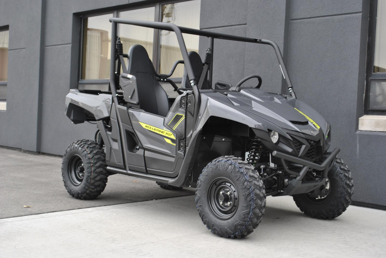

Good thread, OP.
I've always had doubts about the ROPS on my Wolverine X2, but figured Yamaha knew what they're doing. Thin tubing you can sense by tapping on it and confirm by looking into the factory holes that must be for mounting windshields and such. No cross-bracing or trapezoidal shape to keep it from deforming into a parallelogram from a good side load. Hope I never find out.

We rolled our 1120 today. Driver was not seriously hurt. He as thrown from vehicle which probably was best. The ROPS didn't fare too well. A buckled in passenger would be in bad shape.
Wow glad no one was hurt , I have a Polaris Ranger and now it has me wondering ! They do make a ROPS that bolts inside the bed so now wondering if it would be worth it or if it would just twist on the bed if rolled over . Can I ask if this was at a high speed ? Mine will only do 50 max on the open road and I usually always put the belt on if I plan on going more than 25 MPH .

Looks like a support frame for the canopy.. not ROPS.
