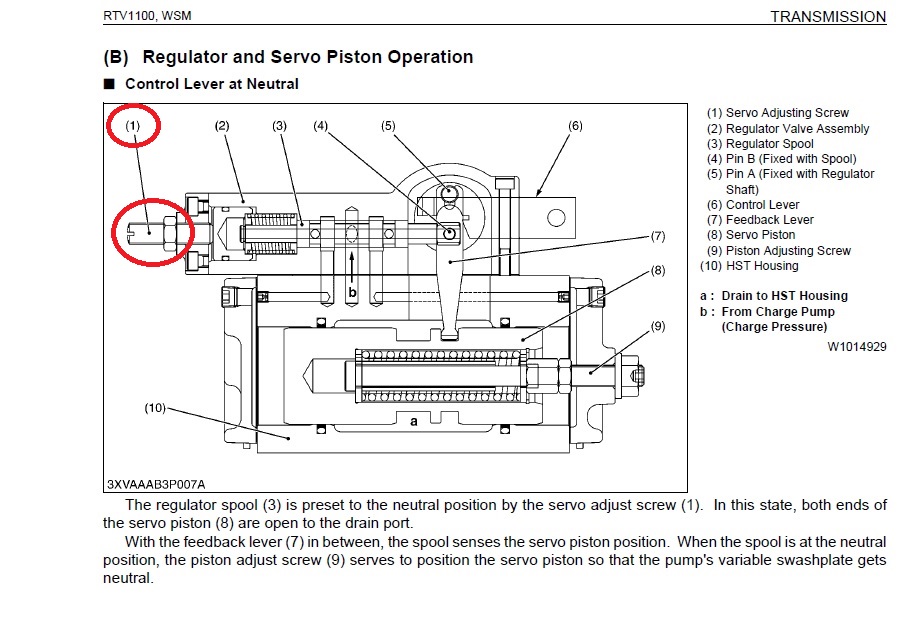

def not the brakes ,
what is behind the servo adjustment bolt when i tighten it seems to bottom out frighted of going any more seems as if some thing is stuck or broke

Here's my explaination of the servo adjustment for an RTV500 from a few years ago..Doubt it differs much for a 900 (ignore the RPM adjustment)..Can't be sure though:
You get to the screw by lifting the bed...There is a rectangular black bok that is just under the seat. If you look to the front of that, there is a stud sticking out, with a slot in the end. It is held in place by a 14mm jambnut. Loosen the jambnut and back out the stud one turn at a time. Make sure you re-tighten the jamb nut after each adjustment. Don't get carried away.
Remember that these are underpowered to begin with, so all we are trying to do is sqeeze everything we can out of it.
When you test drive, make sure you are at full operating temperature or you won't be able to tell if it helped or not.

Steve,
Do you have a manual?
My knowledge of the servo screw, is this;
If you have adjusted it and now don't know were it is set at, then turn it in until it reaches bottom, back the screw out 1 1/2 turns. The range is 0 to 3 turns, with 1 1/2 being the middle. From this point you never go any further than 1/2 turn inward or outward from the middle position. In other words, from bottom it's 1-2 turns.
Should the plunger inside stick and not move out after adjusting to 1 1/2 turns, it may take a little drive to get the pressure up to move it out. Hopefully you can tell by lightly moving the screw out and back in by 1/4 turn to see if you can feel resistance. Either way leave it set a 1 1/2 turns. Otherwise you have to remove the servo body and free up the little plunger. Hard to see in the second diagram but the adjusting bolt pushes on that little plunger inside and it is positioned by the spring inside of it. You can just barely see a little gap between it and the servo body, that's the range of adjustment.
Adjusting on this screw has the least effect of all adjustments to the HST. So leave it until last and only move it by 1/8 of a turn either way to see if you get any improvements.
The neutral screw and HST rod adjustments are key to getting smoother shifting.
Anyone who has never adjusted there servo screw should make careful notes of it's factory position so they can return to that location if they make adjustments that don't work.
