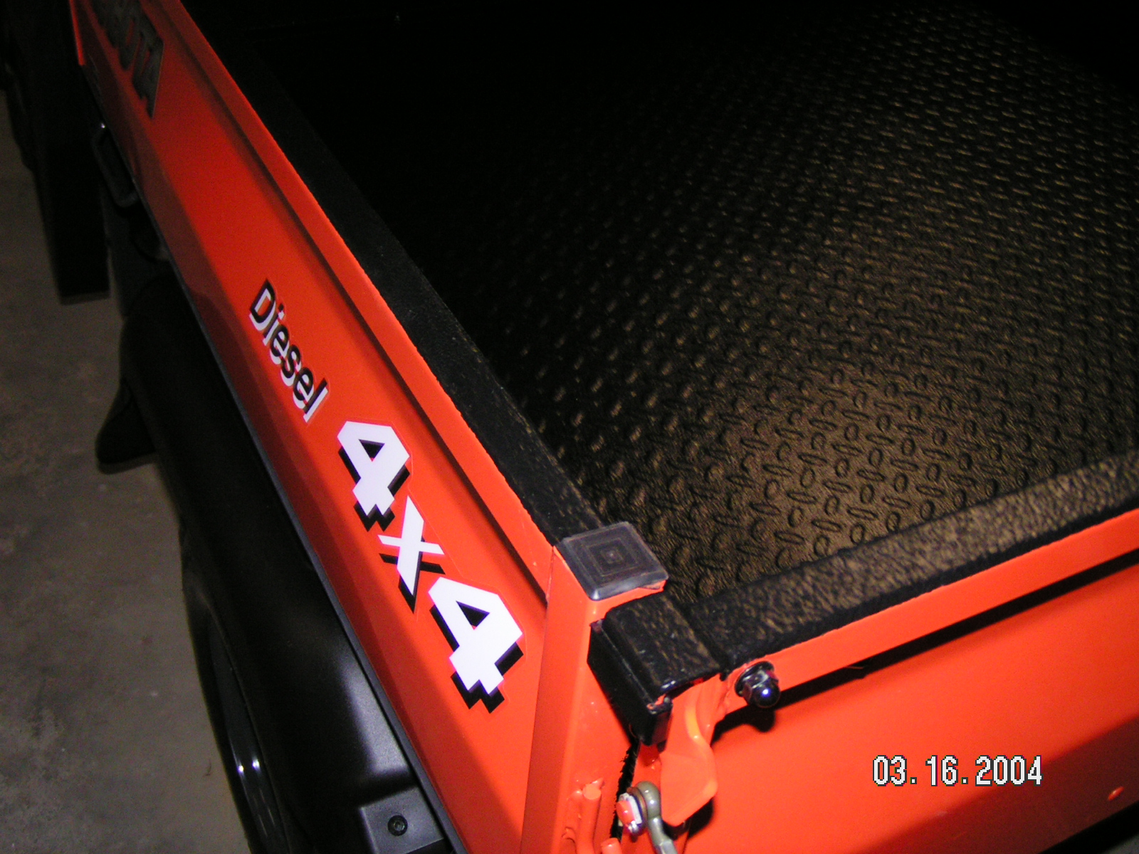

I used enough of the Herculiner to supposedly do a full sized pickup in the back of my RTV. I would call it a complete waste. Not only was it nothing but thick paint, but it cost me extra to have the crap removed when I had a real spray in liner done. Unless you use the 2 part epoxy type do it yourself mix, you are not only wasting money, but are creating a problem and expense for when you need to have it done right. If you want to see how it looks in an RTV, I have pictures of my RTV with the Herculiner in it. It "looked" fine, but offered zero protection.

In case you think I jest, here is a pic from when I put in a whole gallon of Herculiner in the bed of my RTV. Note the date on the pic. That was right after I got it and fell for the line that "it's just as good but costs a lot less". It cost me considerably more than I paid for it to have it removed so a real spray in liner could be applied. :mad:
P.S. When I had a real spray in liner applied, I also had them do the footwell area and the floor where the rubber mat used to be. That works great there! It quiets things down more and will not trap water and grit under it like the rubber mat does.

My exact thoughts. The added sound suppression was a nice, and welcomed, surprise. I agree with it being a bit pricey, but it sure is nice and there is no comparison to the cheapo roll on Herculiner I first used. I'm told that you can buy the two part, one use, spray in kit and do it yourself with the same results. To my understanding you get a one use spray gun, reducer at least two separate bottles that you mix just before spraying and whatever stuff you need to do the job. Here is an auction on eBay for that kind of a true "spray" in liner: eBay Motors: SPRAY IN on BEDLINER KIT BED LINER FREE GUN BLACK KIT (item 190046483566 end time Nov-04-06 05:49:28 PST)
You'll notice that you get 3.5 gallons of material rather than the one gallon of like you get with the roll on junk. I would think that if you had everything prepared, you could pretty well do everything you'd need on an RTV with one kit. I also noticed that you can pick the color you'd want. I think that the matching dark grey would look nice.
