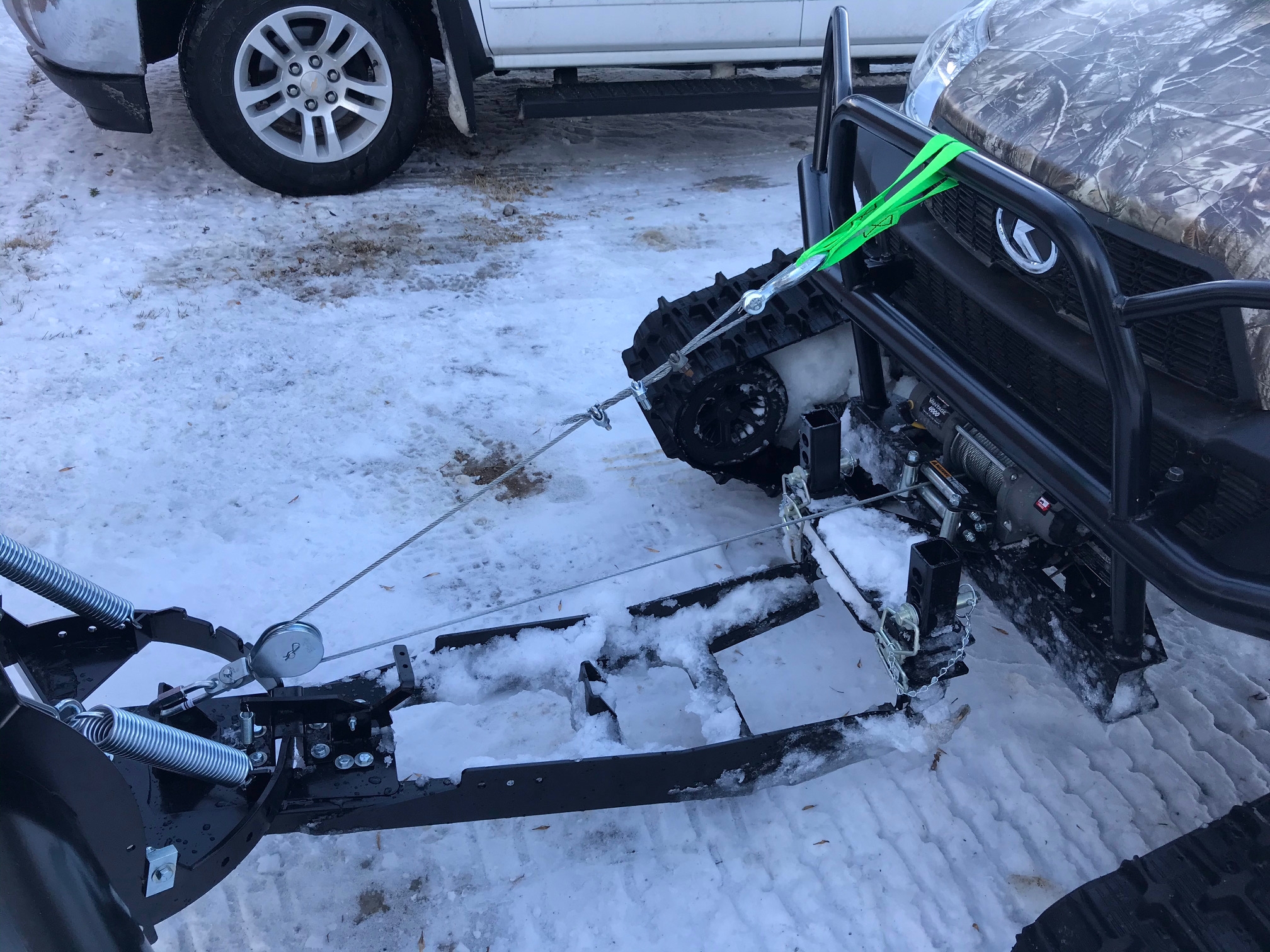

What is the best Cable Rope for a UTV Winch?
The Synthetic Winch Rope snapped after a few hours of use on the Denali UTV Plow Blade Box with Box End Wings mounted to our new to us RTV-1100C. I repaired using an albright knot, and then secured the remainder of the black abrasion sleeve to the rope with zip ties.
I am sure it will abrade and break again.
Set up is placing too much stress on the rope, by pulling straight back to lift. I did the same thing initially, snapped the cable. Added a pulley, solved the issue. I now run with a synthetic rope.

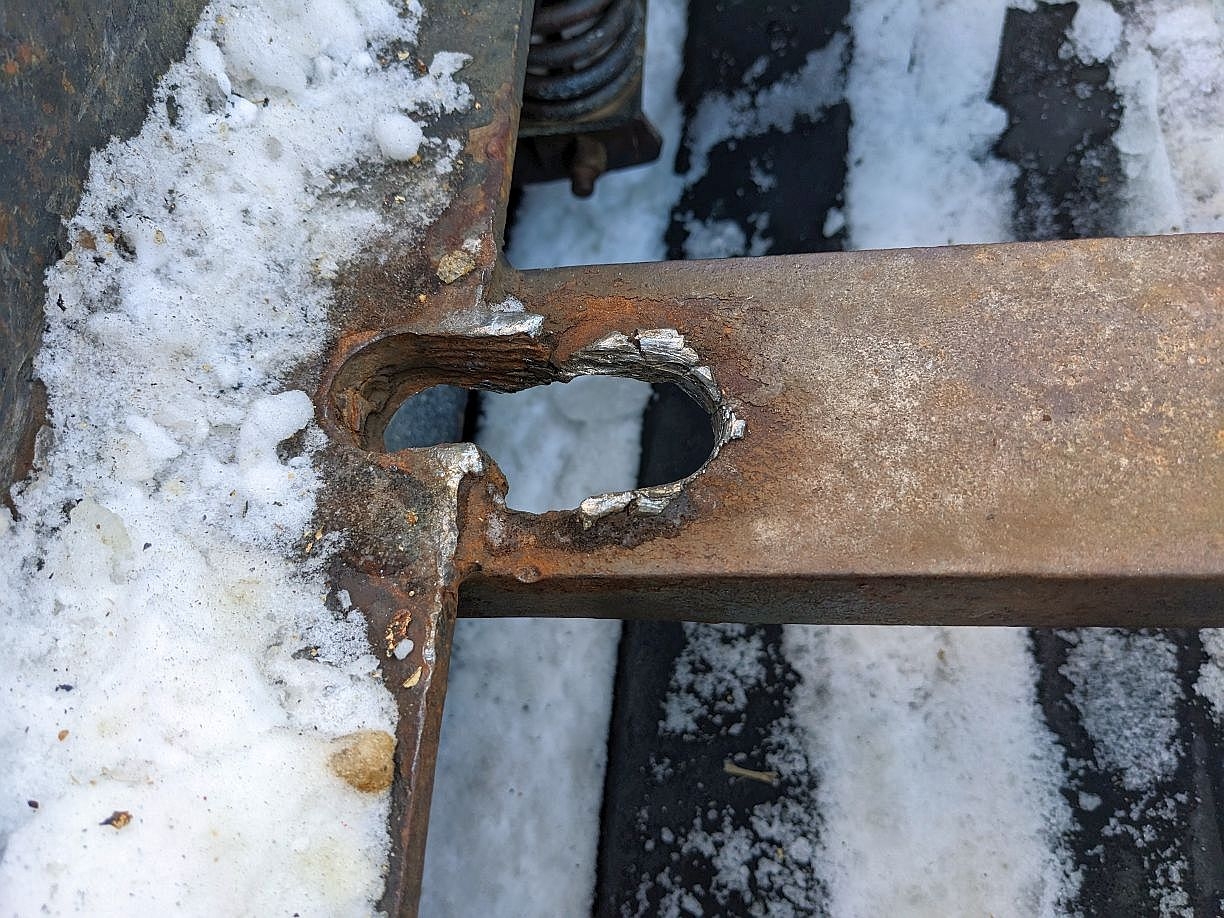

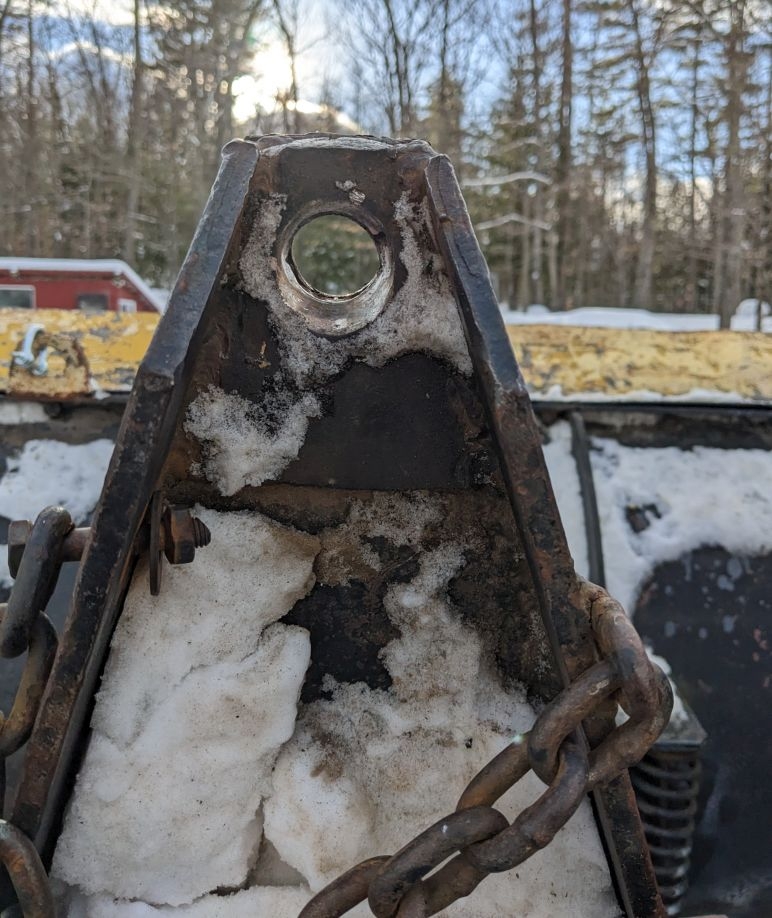

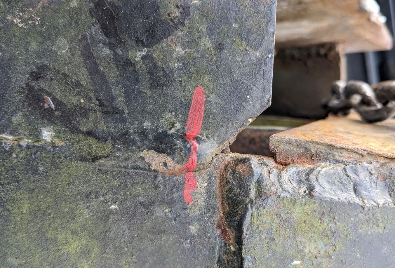

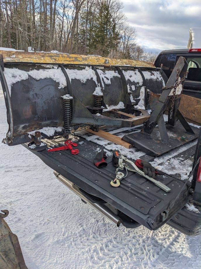

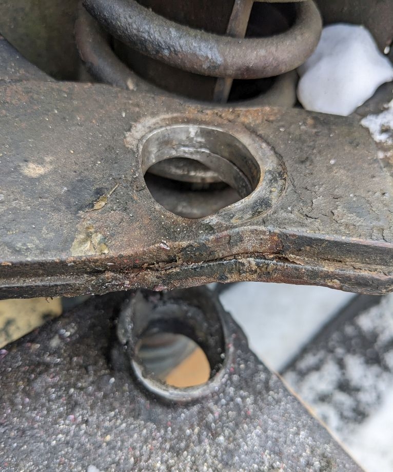

You'll do just fine. The heated cab on the 1100c sure does spoil you.
Froze today taking apart my old plow and loading it up to bring it to a weld shop.
