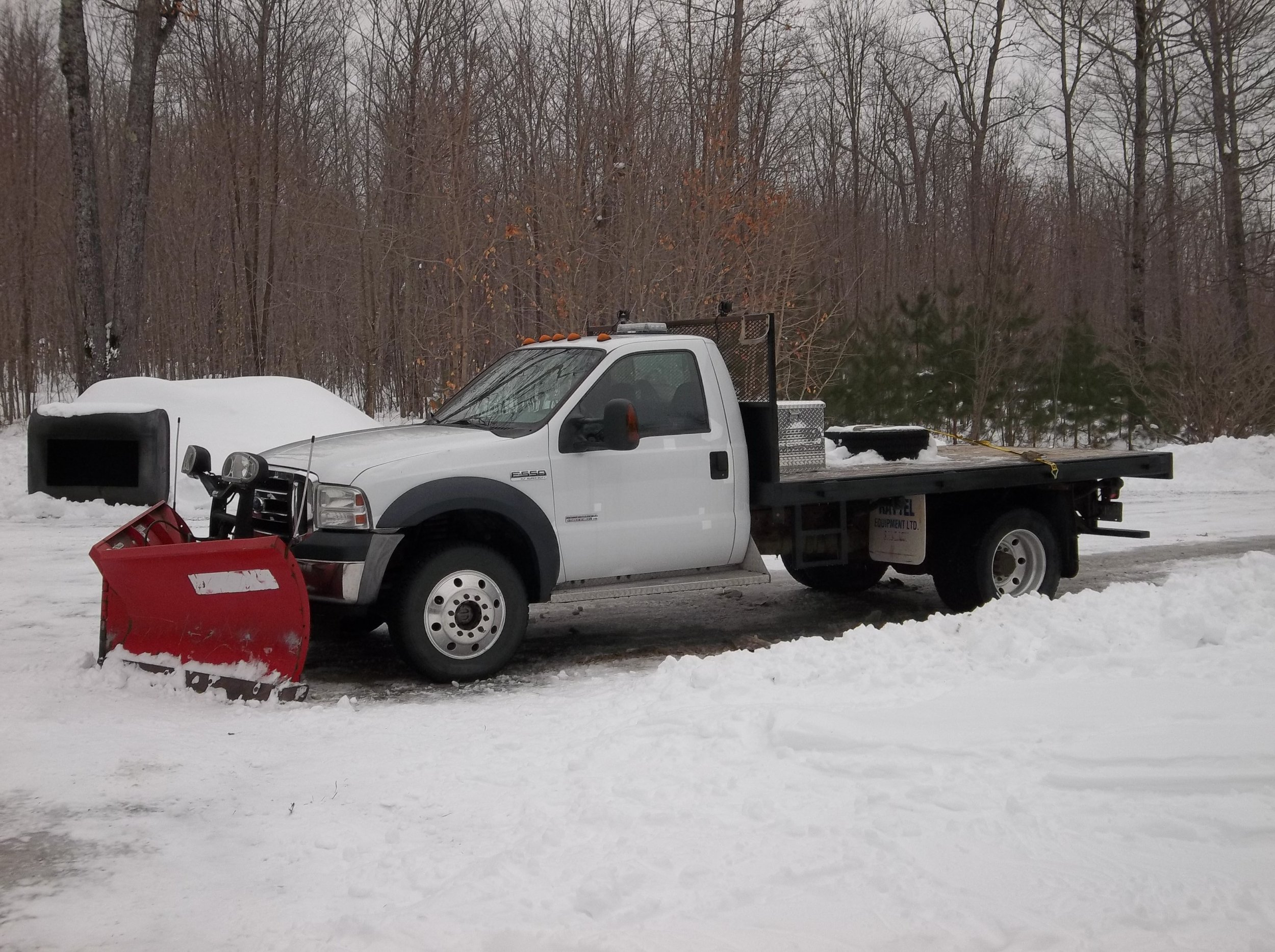

This is what my RTV and Boss plow replaced. I only do my own yard, which is a 300 foot driveway and an parking area big enough to turn my tractor trailer around in (which I also no longer have.) I HATED plowing with the F550. Not only was it hard on fuel but visibility sucked. Especially when you get plowing around the house and outbuildings. Or going out the driveway onto the road.
Sure the RTV takes a bit longer but you can easily plow right alongside walls, vehicles, etc.
But it still can't beat the tractor and blower.
