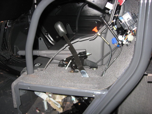

Does anyone know what the Blue connector located behind the panel by the Orange differential lock button is used for?
It has 4 wires, Black, Red/Yellow, Green/White, and Blue.
Can't seem to find any reference in the manual, but must be for an additional piece of equipment.

The only thing I see on the schematic that isn't a factory used connection, that appears to have that color combination would be an emergency beacon. Can't be sure though, it's location isn't shown.

Looking at the wire diagram, it looks like it's for the "beacon switch harness". Most of these types of things are for accessories they sell.
