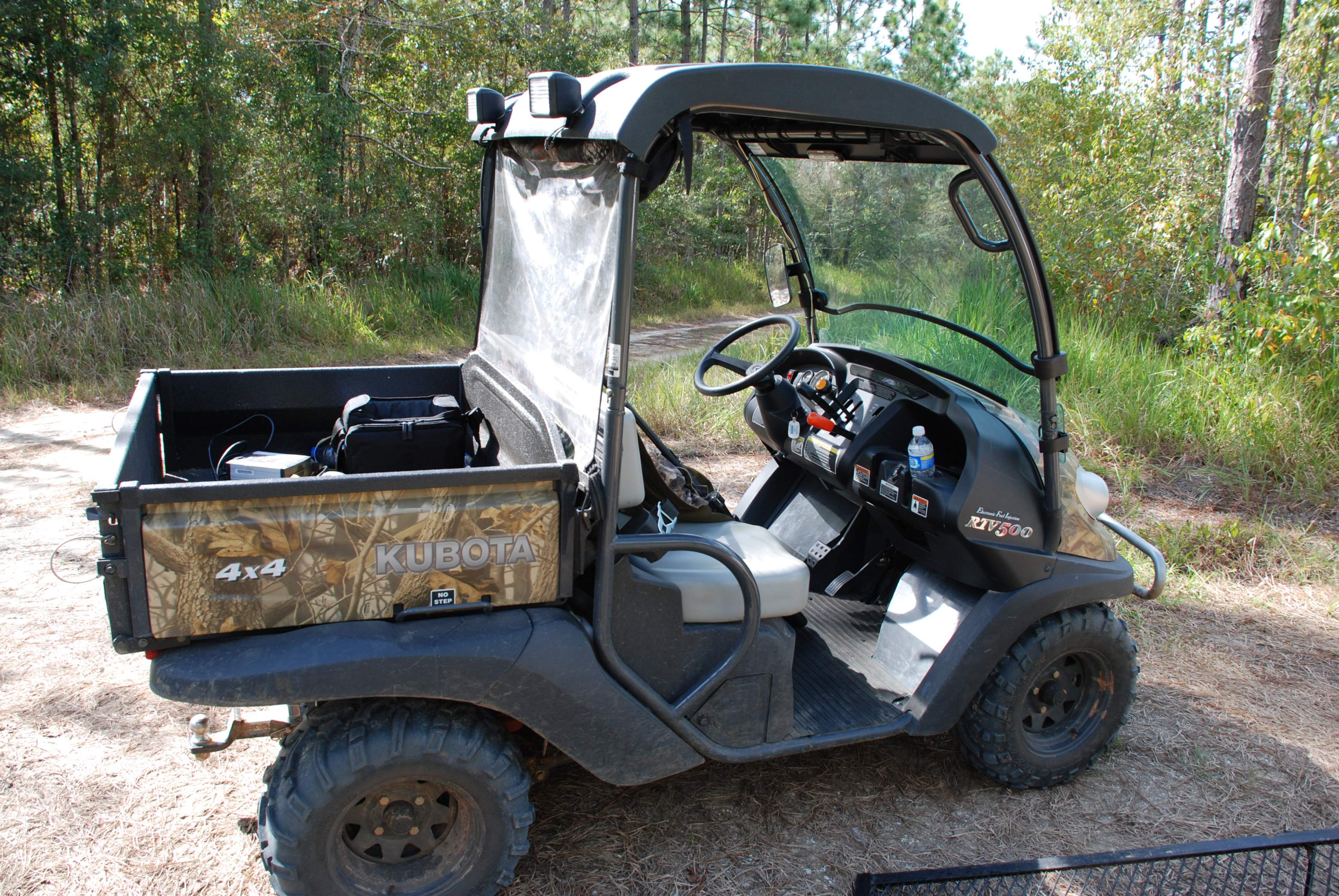

Timswi I quit trying to make the machine perform outside of the design characteristics. Its a underpowered golfcart and its not a tractor or a honda big red, polaris ranger, actic cat or Rhino. Its a utility vehicle that runs like its powered at times with a rubber band or Radio Controlled airplane gas engine. With all that said I love the darn thing and it does what it does best. Gets me around the hutin camp and also hold alot of ice cold beer in the back. Your machine is operatiing exactly like the machine was designed to operate. There isn't anything wrong with it. I myself would like to feel some more power so eventually im probably going to switch brands. Just ride it and use the heck out of it. It is a tough machine and you can't break it. I run my hard as I can with no complaints.....like i said before it is what it is and if you think about it its not all bad. I actually love mine. Yes we all know it's underpowered.

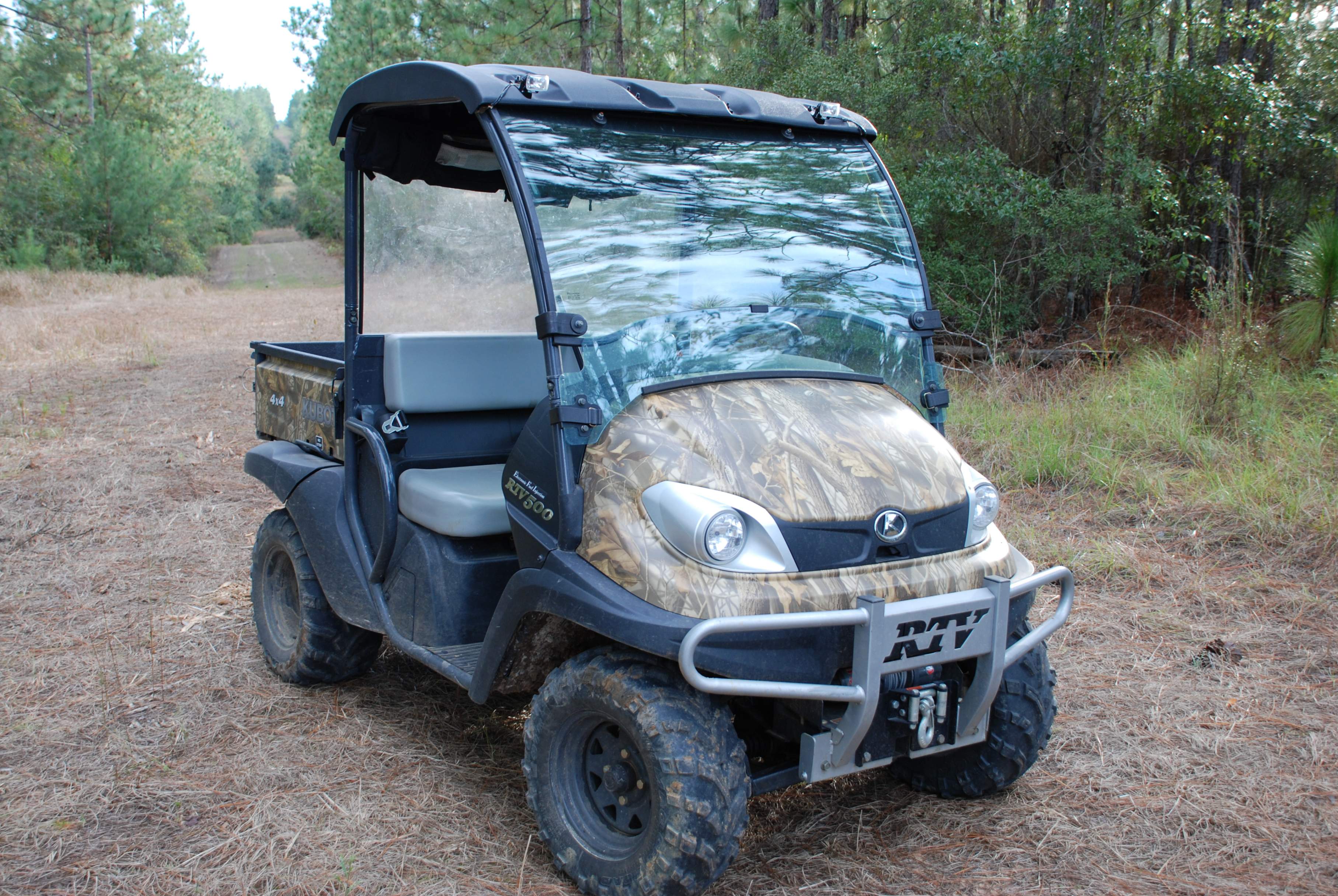

Timswi you say you run out of rpms going up a hill. I run out just going up the ramp on my 5x10 trailer. It won't make it uop the ramp in high gear unless you get a running start. It's lacking alot of tourqe in high gear. I think the HST is good in theory but is very inefficient in power transfer. This engine is a 450cc motor ok. I have a 250cc Yamaha timberwolf thats basically half the motor and it will kick the RTV 500's behind. Anyhow as far as the peddle thing I let off soemtimes to see if it helps on a hill and i can hear it pick up RPM's but its really not noticble on the speedo so I just keep it floored everywhere I go. I get great gas milage and my rattle sound is still there if you teally listen for it but like i said earlier much better with the new alternator. I know your frustrations brother. You just want the thing to act like a teenager not a 100 year old man. Take care and run the heck out of it...You won't hurt it.
