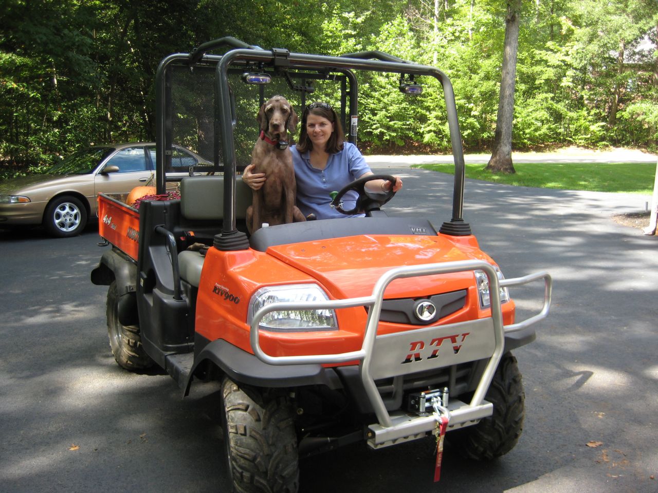

So I have owne a Mule 3010 gas version. I traded it in last fall for the RTV-900. They both have advantages and faults in my opinion. Here are some thoughts:
Top Speed: About the same, 25 MPH, but side by side mule gets to 25 faster.
Noise: Mule gas version wins hands down, RTV makes more noise than my diesel tractor
Power Steering: RTV wins hands down, I've broken a finger with the mule manual steering..
Trans: I like hydros, and the RTV works, but they do not have the shifting figured out. It is crap at best. Pulling some knob and waiting for pressure to drop before changing gears is BS. Make the forward/reverse the same as my tractor, one foot pedal goes forward and back. God help you if you need to reverse quickly, cause it won't happen.
Traction: The RTV comes with very agressive tires, and I seldom need 4 WD, where with the mule I often had to put it in 4 WD. That is a tire issue, but the mule is 500 pounds heavier, so that matters also.
Towing: The mule did pull a lot and never had a problem. It lost traction first before running out of pulling power. The RTV I like, but I am not 100% sold yet, but it is still sort of new with only 75 hours. Last weekend I filled the back up with wood, and had my yard trailer on it. The total weight of the trailer was about 1,000 pounds. (it holds one yard). In first gear it went up some of my very steep hills to get home, so it certainly did the trick.
Fuel Economy: The RTV diesel wins hands down over the 3010 gas.
Ruggedness: They are both built well. The RTV is heavier, but I suspect the frames are about the same. Construction is frankly good on both.
Design: Some things the Mule did better. Air intake already up high on the top of the roll bar. (no need for a snorkle). The mule has way more storage. Includes a glove compartment and a front storage area. RTV has neither, but for 100 bucks you can buy some POS for the RTV that is cheap.
Overall, they are both good. If the new mules had power steering and a hydro trans I may have bought that, but they don't... so I have an RTV!
