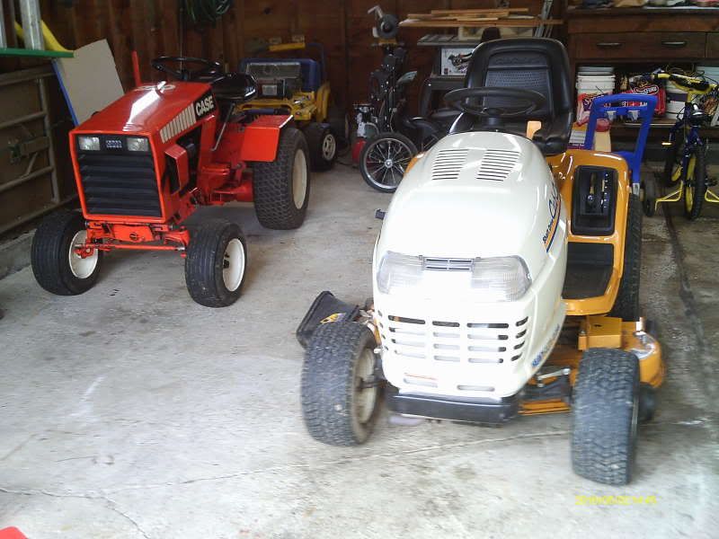

My Cub Z-Force doesn't ride any worse than my Cub 2544 or Case 220. The name of the game for me is to slow waaaaay down on the very rough areas, which means my ground speed is generally slower all the time. To the OP, I thought Dixie Choppers came with big balloon ATV rear tires (like pictured at the bottom)? Those should ride nice. I do know that the tires were GROSSLY overinflated on my Z-Force when I took delivery. I didn't think to even check it until I got jarred around for about 3hrs of mowing. The pic below was taken when I didn't realize the rears were ready to pop. The rears are supposed to hold 8-10psig and they were at ~40 each!! The front casters take a higher pressure being small, so they're always going to be kind of hard.
