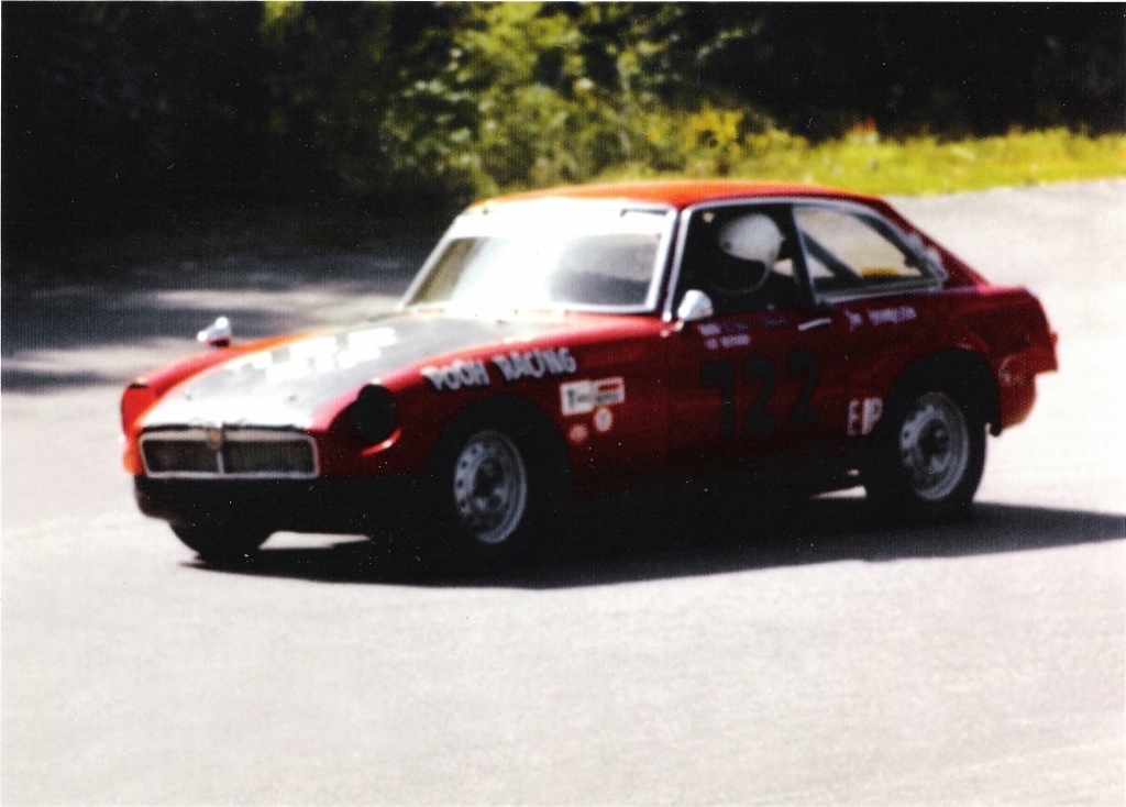

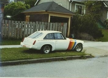

It's funny, by today's standard my Dad's race car would be under powered and yet in the 70's it was a fire breathing dragon! 140mph BEFORE it looked like this and got faster but I don't think it ever even had 200hp. Maybe but if so, just!
Later, as the 'Rainbow Warrior' (not the same thing as what it means today!) it was even faster and won two nationals (Canada) and 7 Regionals (BC). Yet, again, it was a slug compared to today's cars! My WRX has 275hp box stock! But I love these old cars and driving them was a dream! Bought my first BGT in 86 when I was in the Marine Corps and drove it for hours and hours afterwards! Fit like a glove too and I loved that but then, you see why I'm sure.
