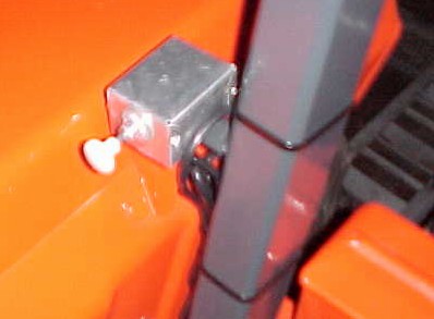

For my work light I wanted a real durable switch and wanted it protected. I got an aluminum box from Radio Shack for $3 and installed a push-pull switch from Walmart (Automotive), also about $3. The toggle switches I found looked too light duty for a tractor. I put one hole in the box cover for the switch, and one hole in the box base for the fender bolt. Also added a notch for wires. My M series has pigtales and fuse already for the work light. Key does not need to be ON.

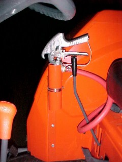

I also included a pic of my spray nozzle holster. Made from a piece of PVC hose clamped to a short piece of angle. A notch in the PVC keeps the handle oriented and keeps the handle from spinning and scratching the fender. Ergonomic and where I need it without even looking.

Another pic

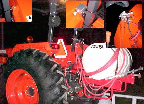

Found a way to send four pics at once!
   / run 12v to sprayer #10
Nice work jrpoux. Clean design and install.
